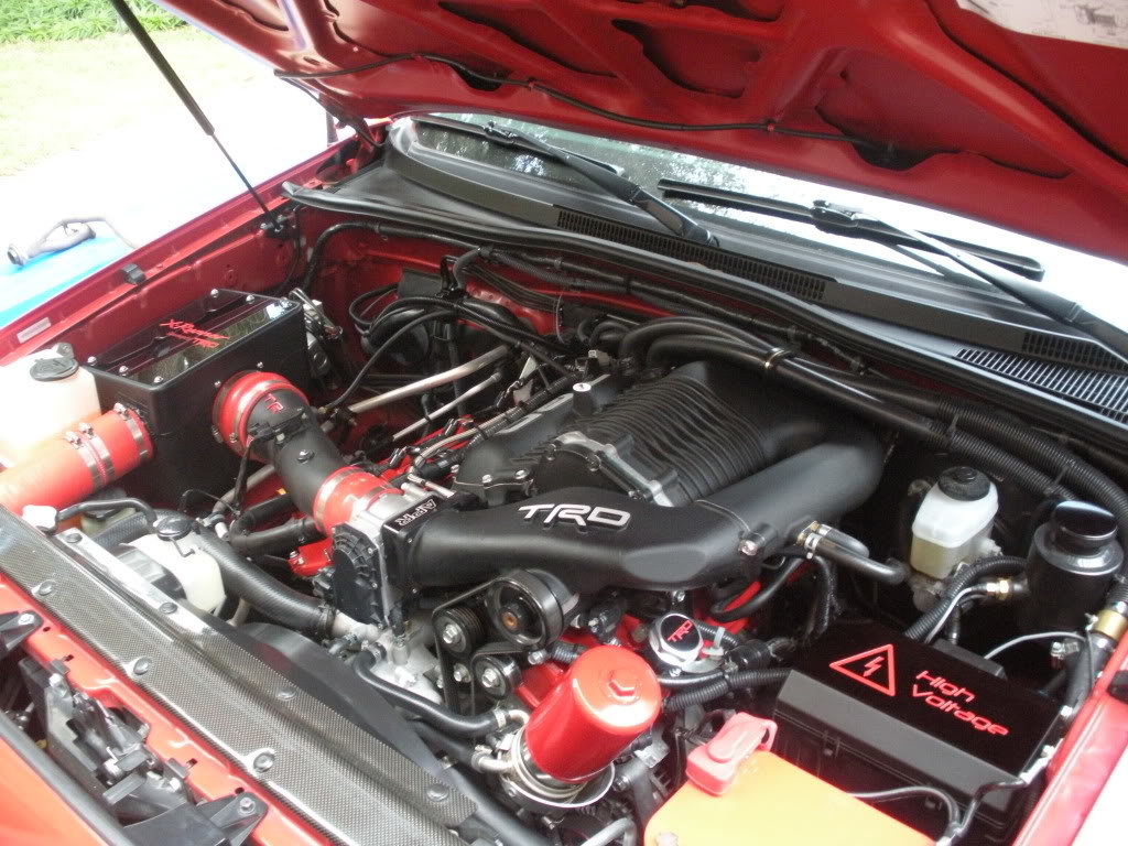

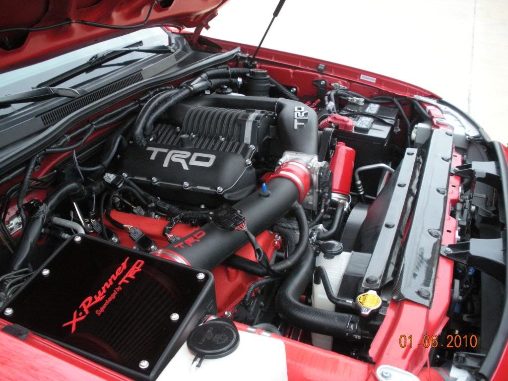

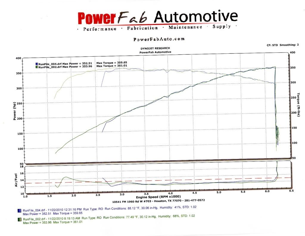

    Here is a dyno run that I had done recently.
    TRD S/C
    APR X-1
    APR 7th injector
    NST pulley set
    DTLT
    URD Y pipe with high flow cats
    URD 3" Cat Back
    TRD Intake
    Followed by a T56 magnum Trans.
    I am very happy with the set up.
