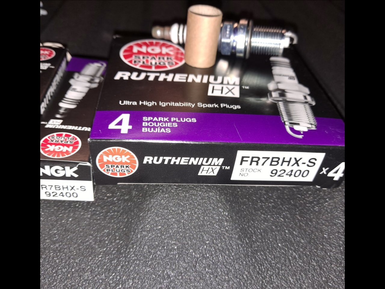

    Look into the new ruthenium type spark plugs!
    I just got these for my v6 and I can feel a difference,
    These are two step cooler
    boostedka and mtb_taco like this.
