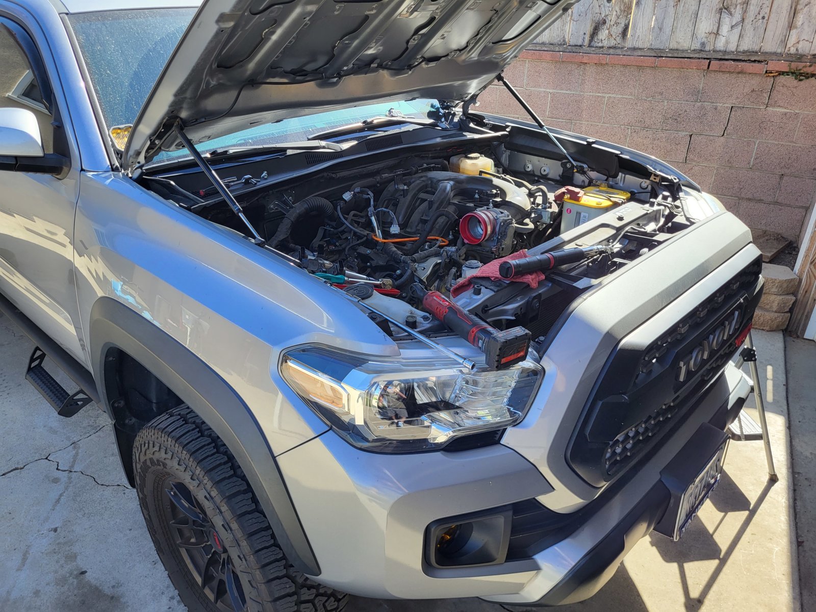

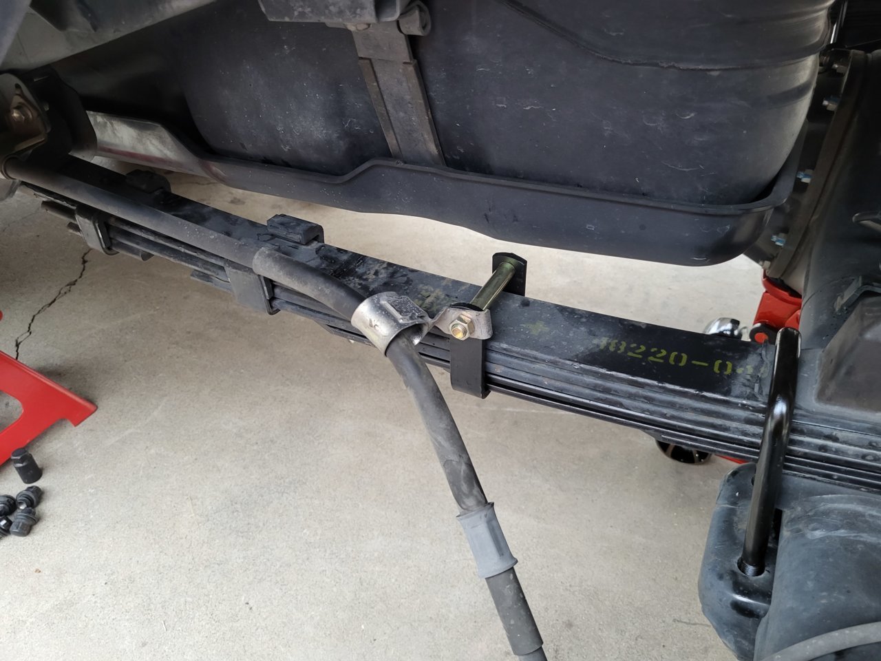

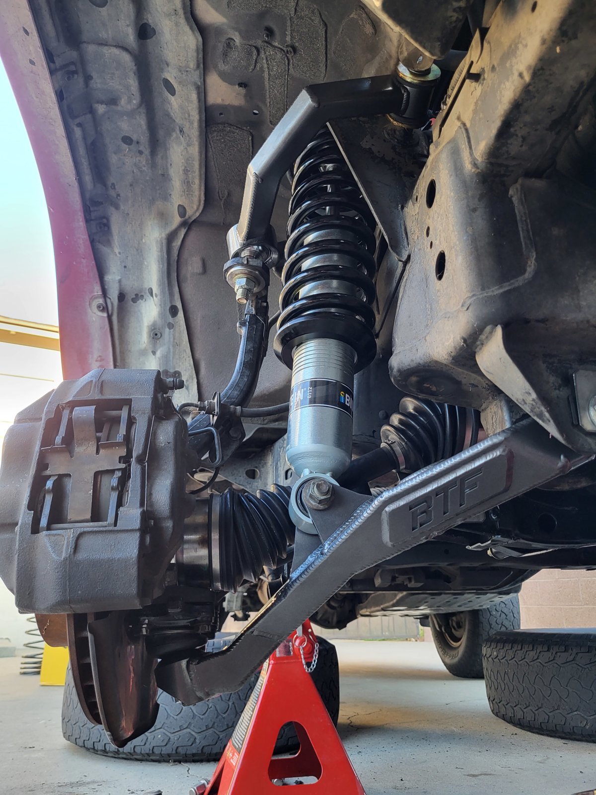

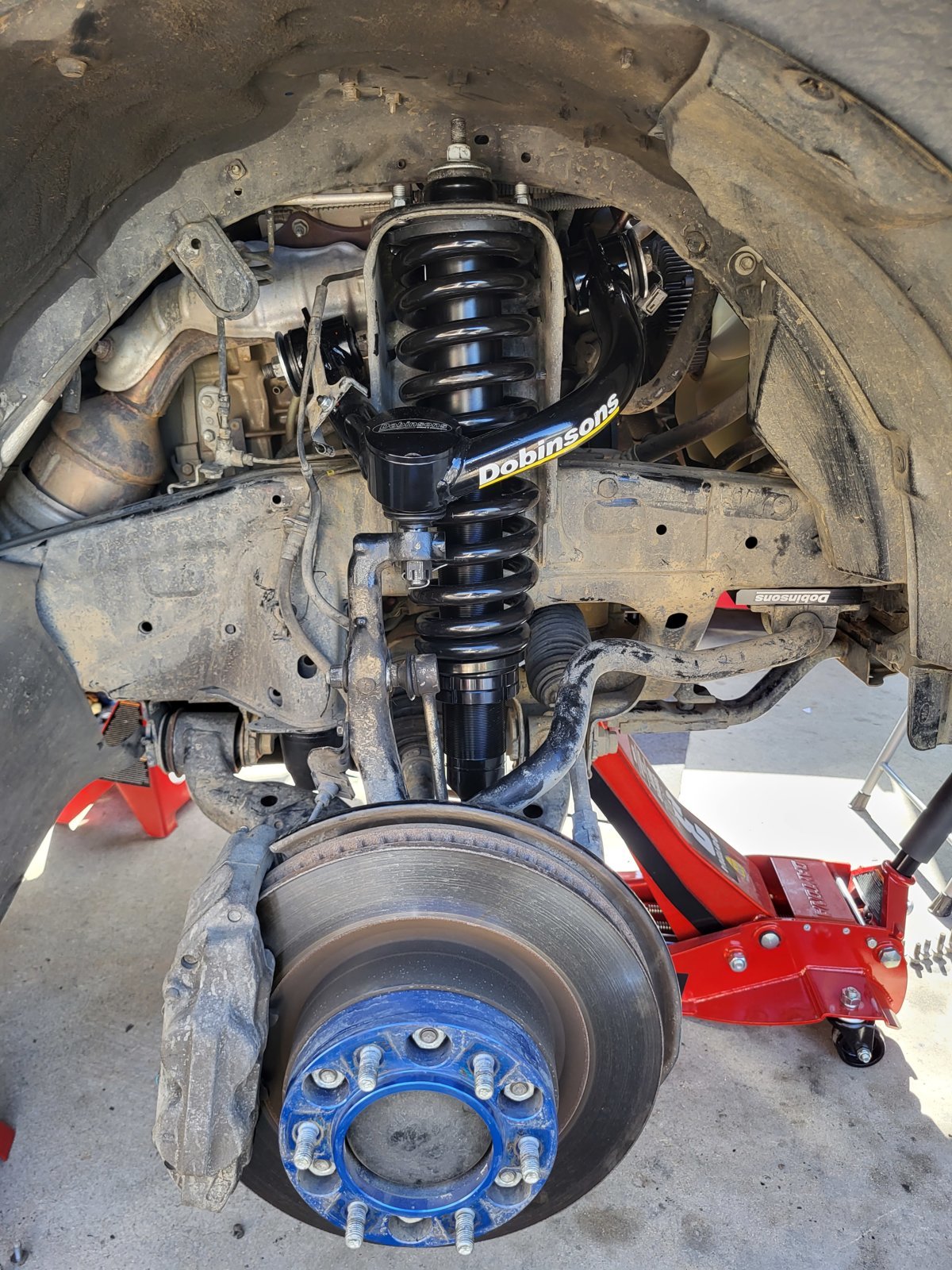

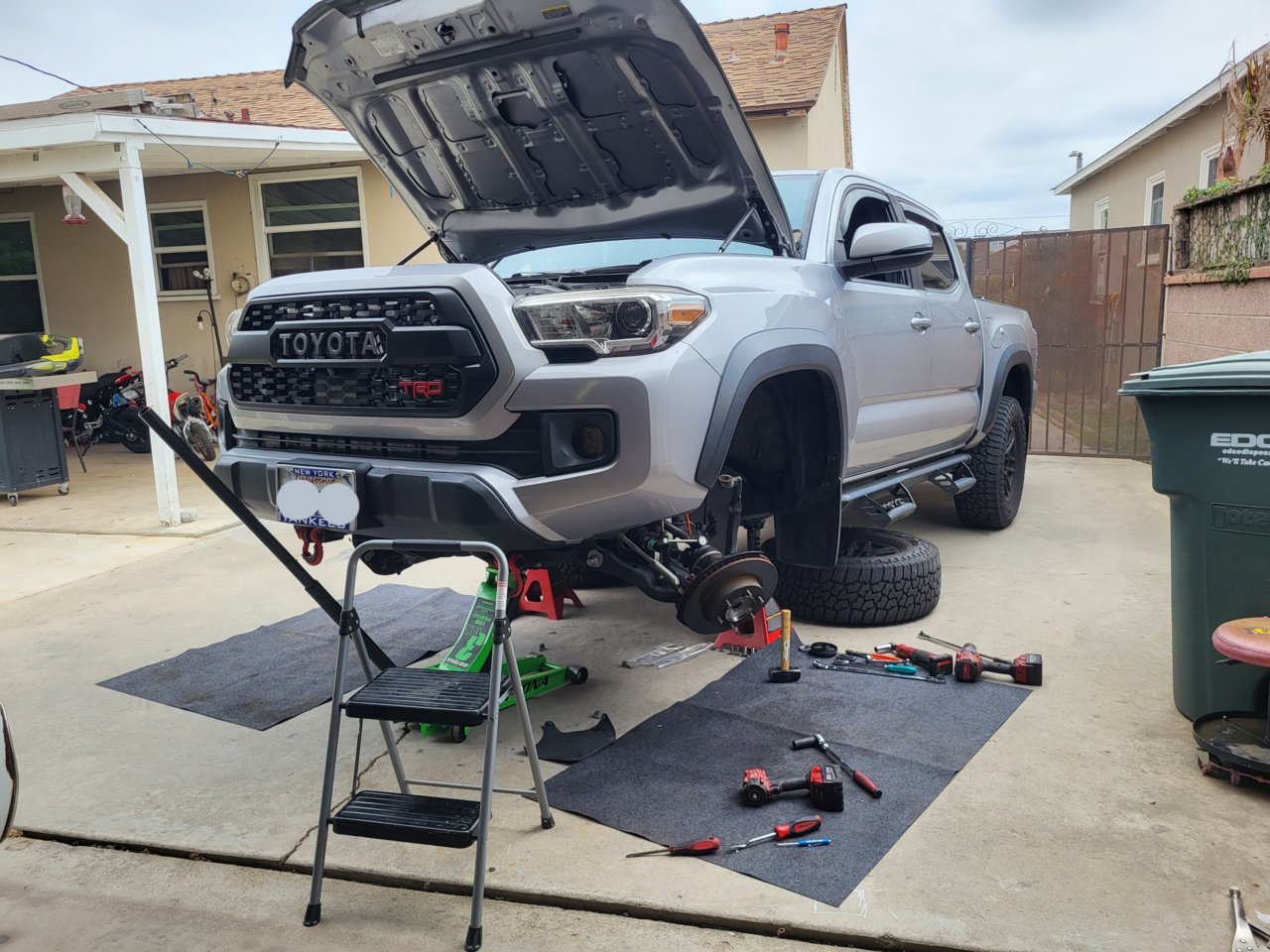

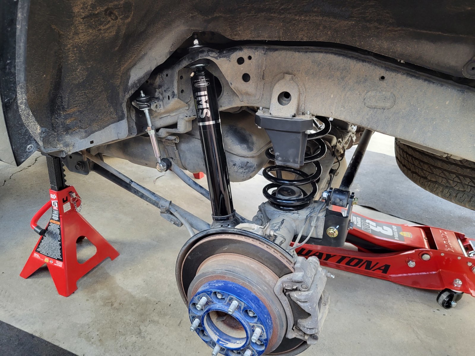

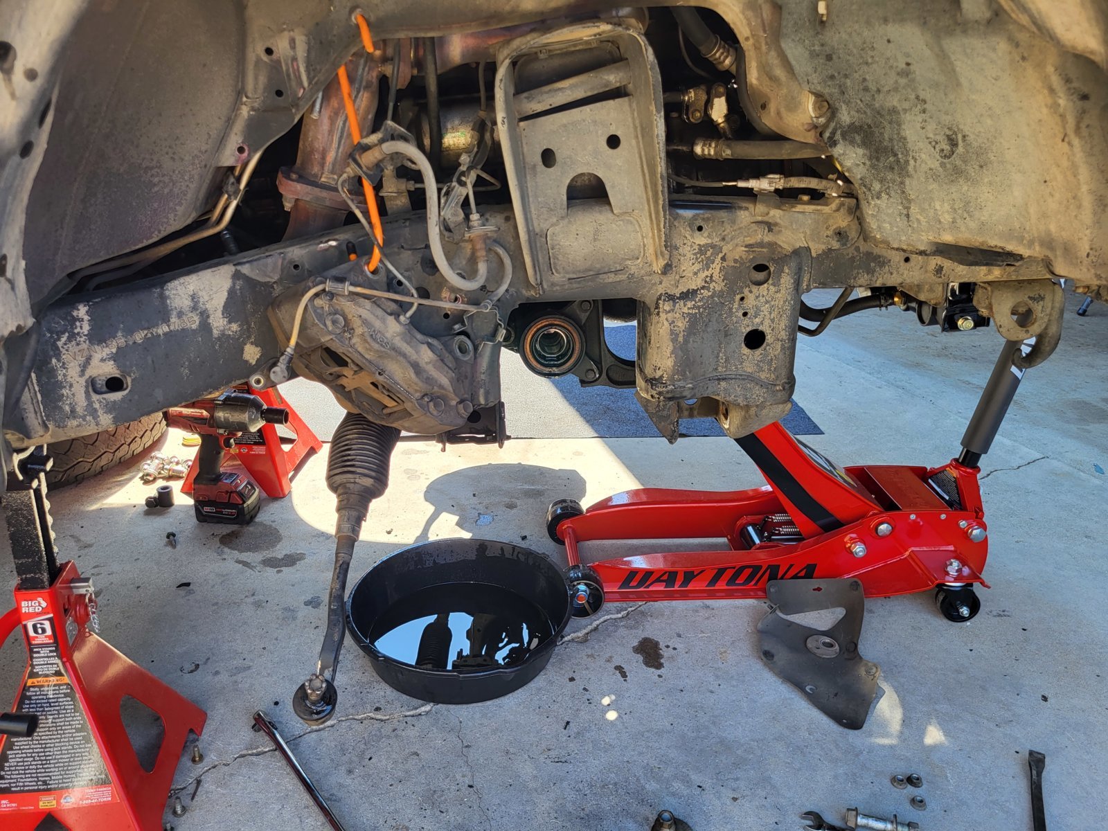

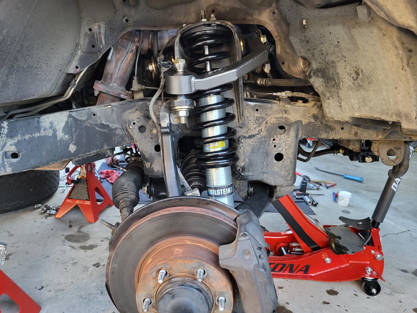

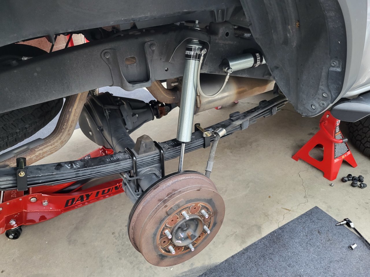

    Had the pleasure of installing this Tacoma lift front to back. Bilstein 6112 that I assembled, JBA UCA, 5160 rear, ECGS bushing, Icon AAL. I ensure the parking brake cable is attached properly. A lot of places just leave the parking cable dangling or zip tied on.

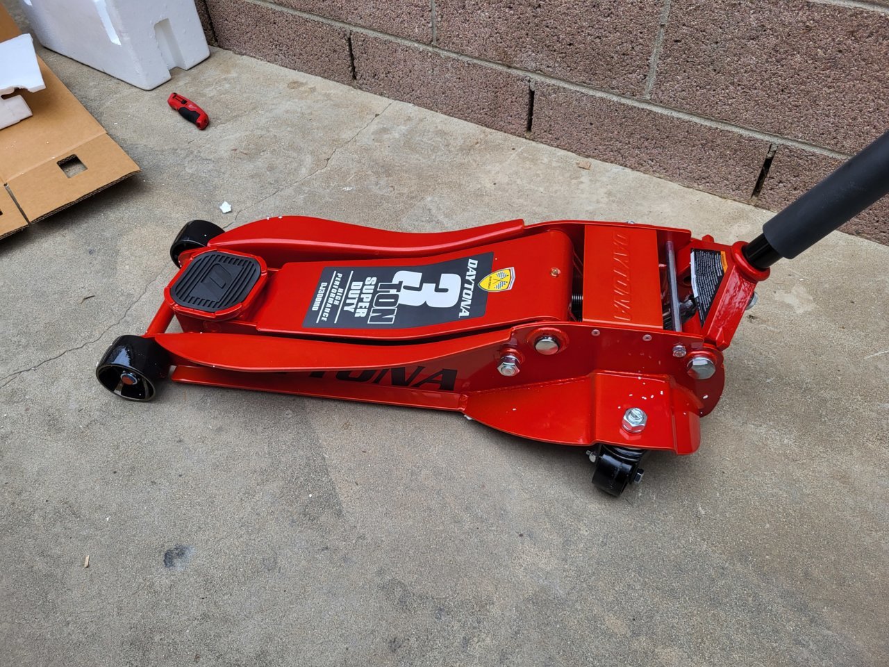

    My Daytona 3 ton jack failed mid repair. I went to harbor freight and upgraded to the daytona super duty.

    that’s awesome! I have the same green Daytona jack

    Make sure you bleed the air out of it! It's in the instruction manual. I blew mine out after only 3 months. I'm 99% sure it's because I didn't bleed it.

    Oh damn did they warranty it at all?

    How do you bleed it? I threw away the manual long ago lol

    Yeah they gave me some credit towards the new one thankfully.
    You open this bleeder screw and pump the jack 10-15 times. The jack handle needs to be in the loose position, as if you are lowering the jack. You can download a PDF of the instructions. Just Google daytona 3 ton instruction manual.

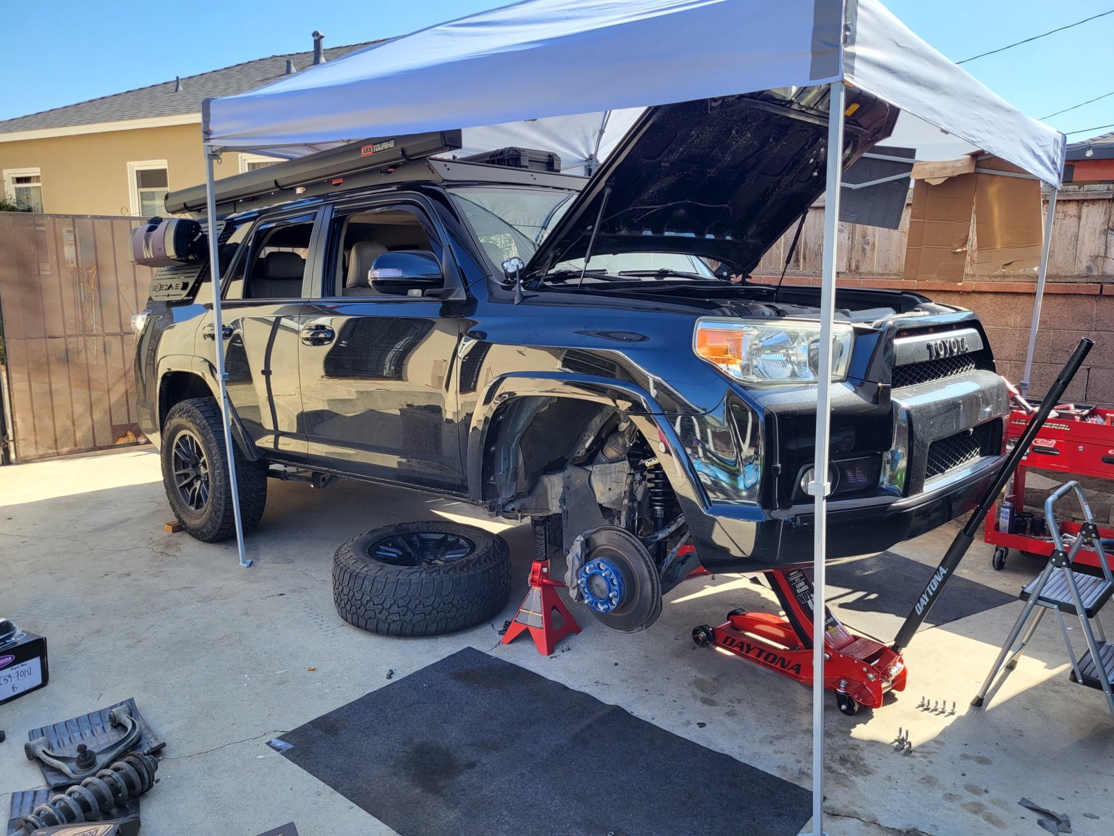

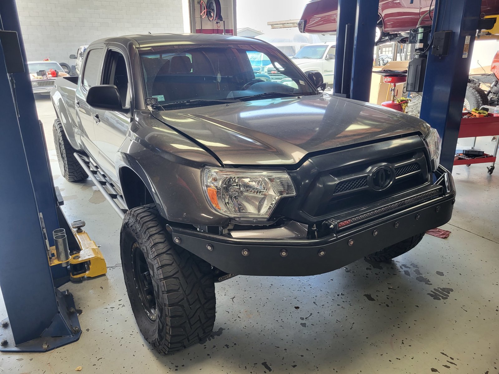

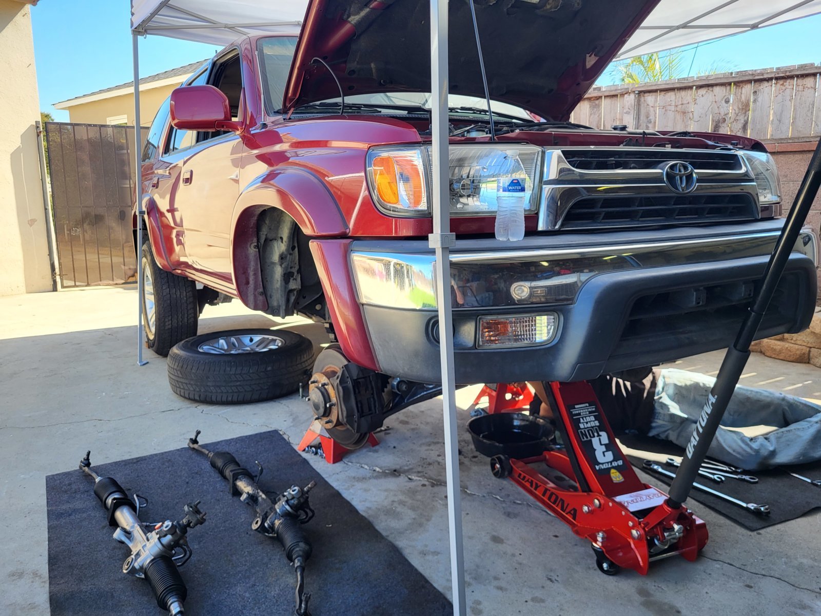

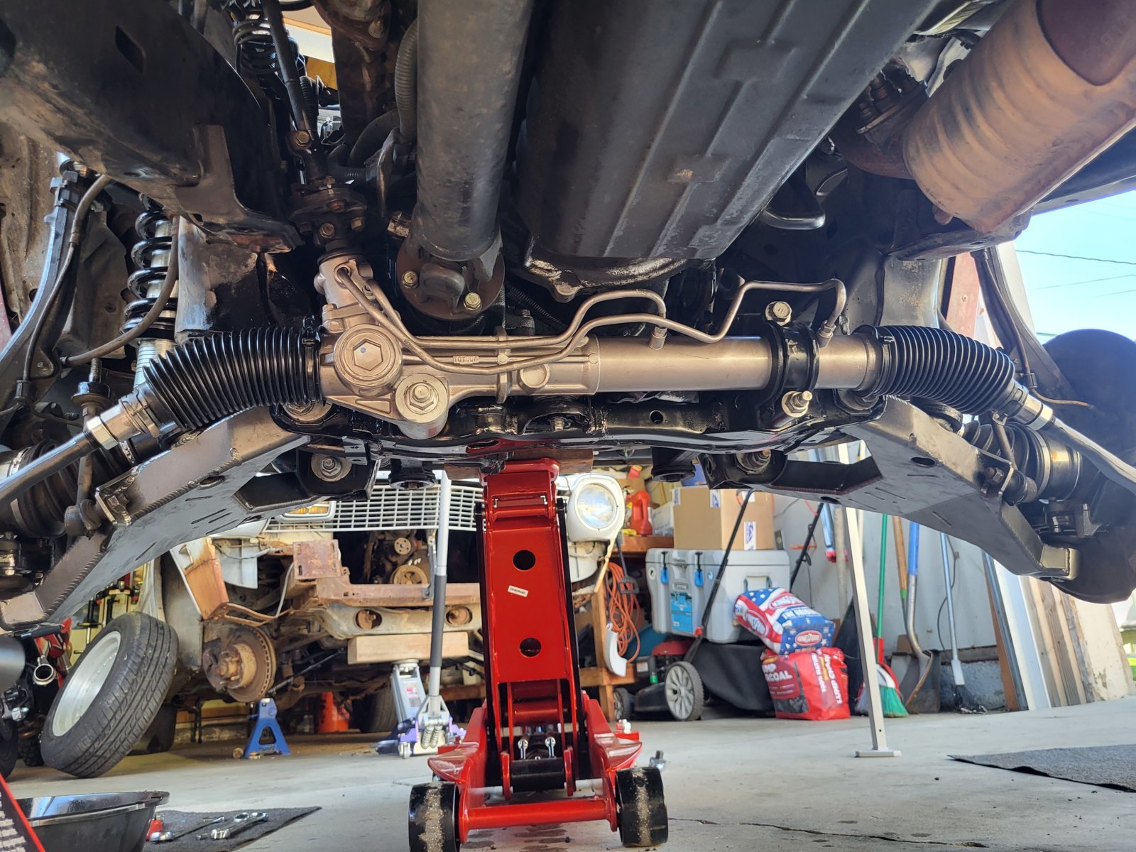

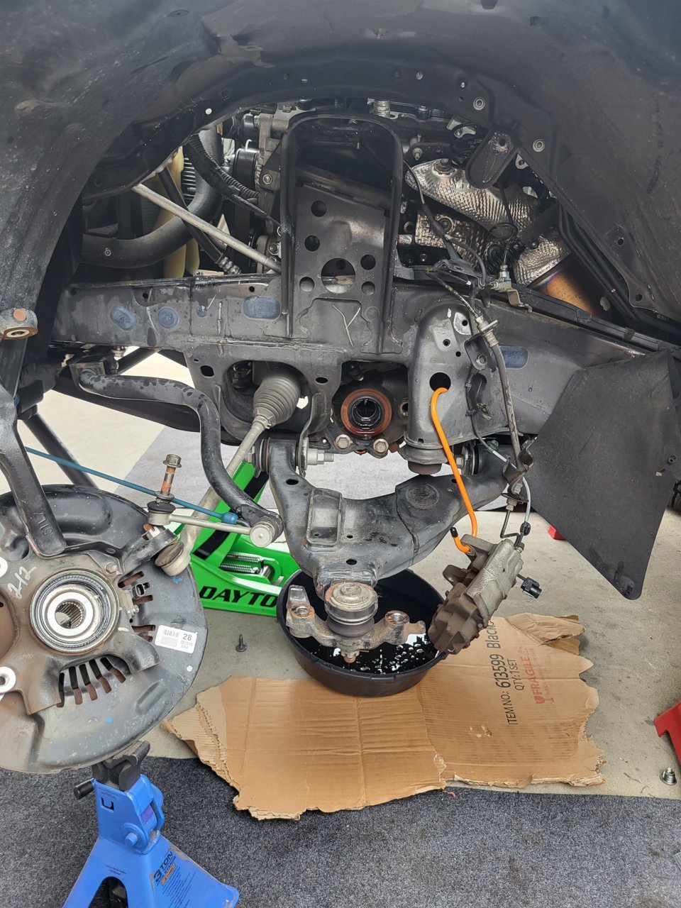

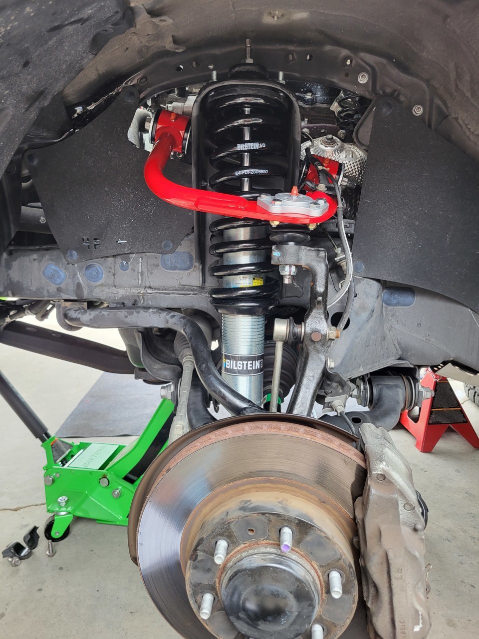

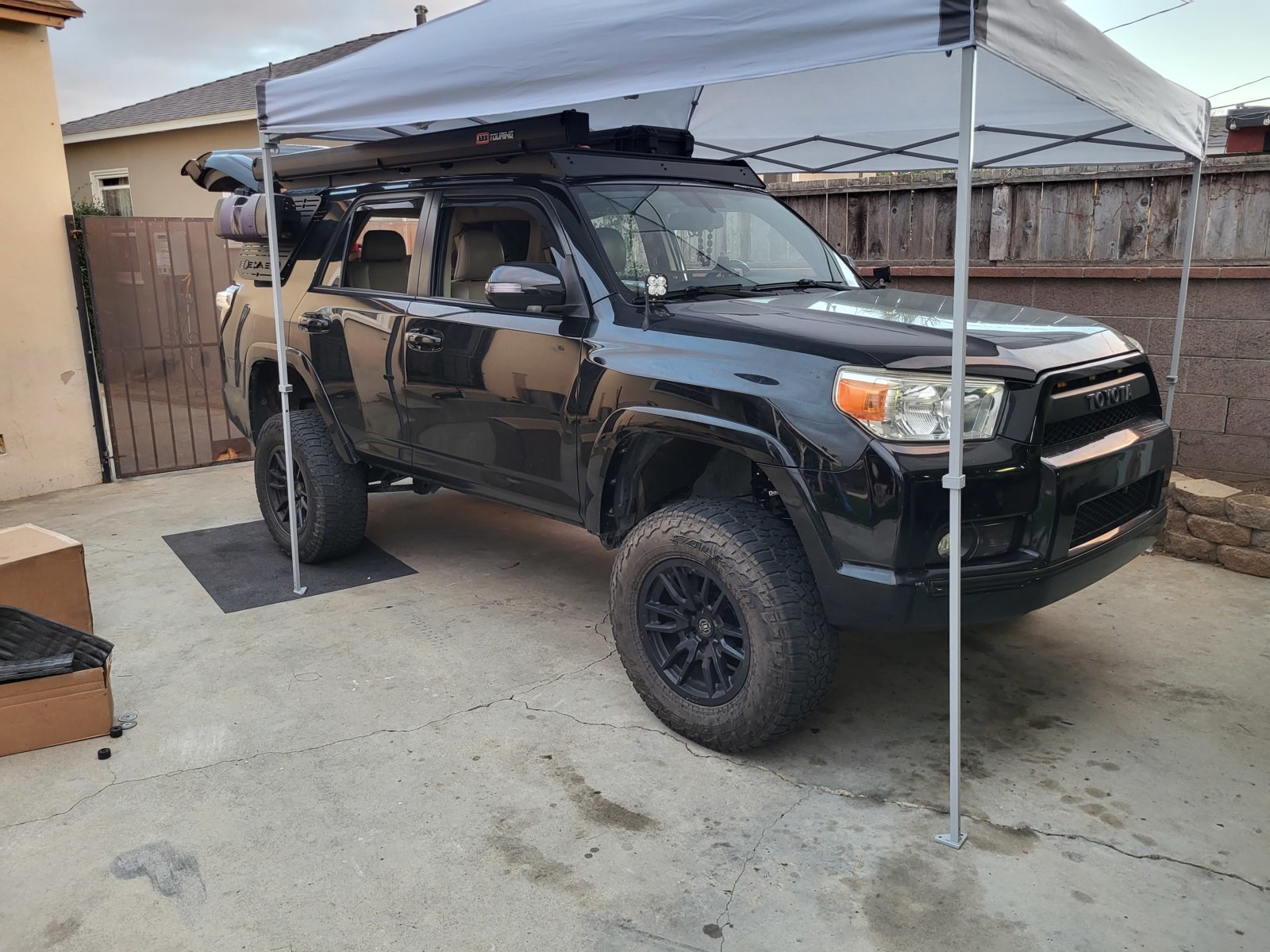

    Have been doing a lot of 4runners lately. I really appreciate all the folks that have trusted me to work on their rigs. I take pride in my work quality. Here are some recent projects in the last couple of weeks.

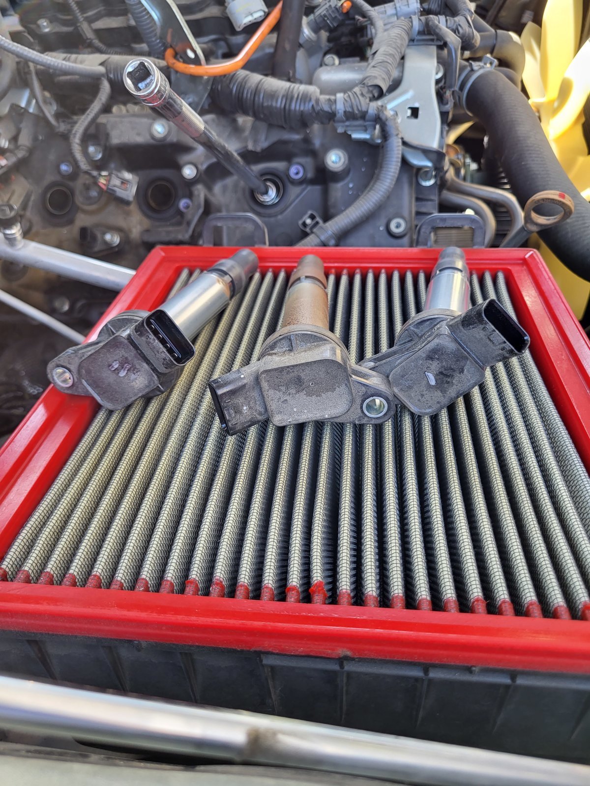

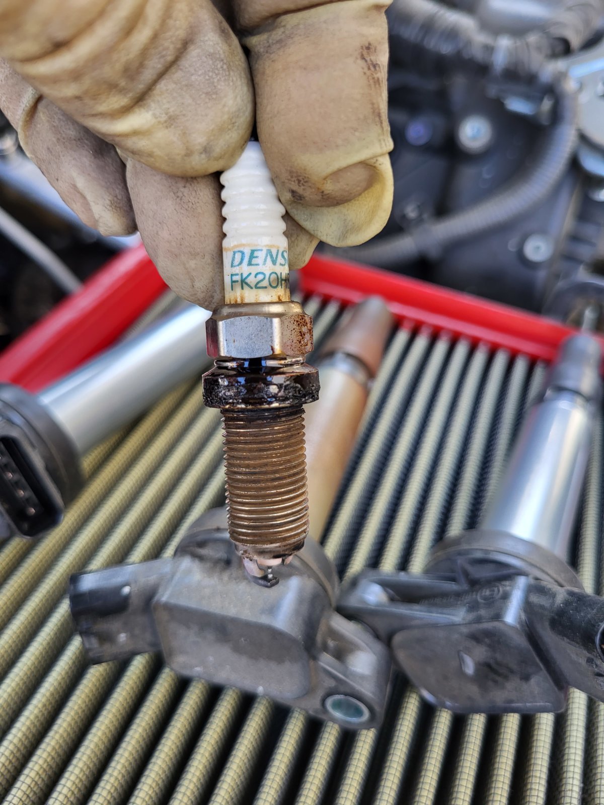

    One spark plug was loose from the factory on this 3rd gen. Change them spark plugs on time, or early like this gentleman did.

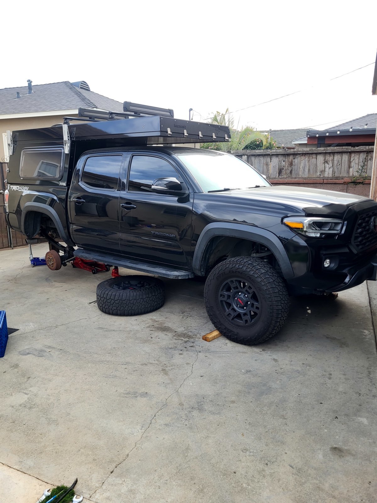

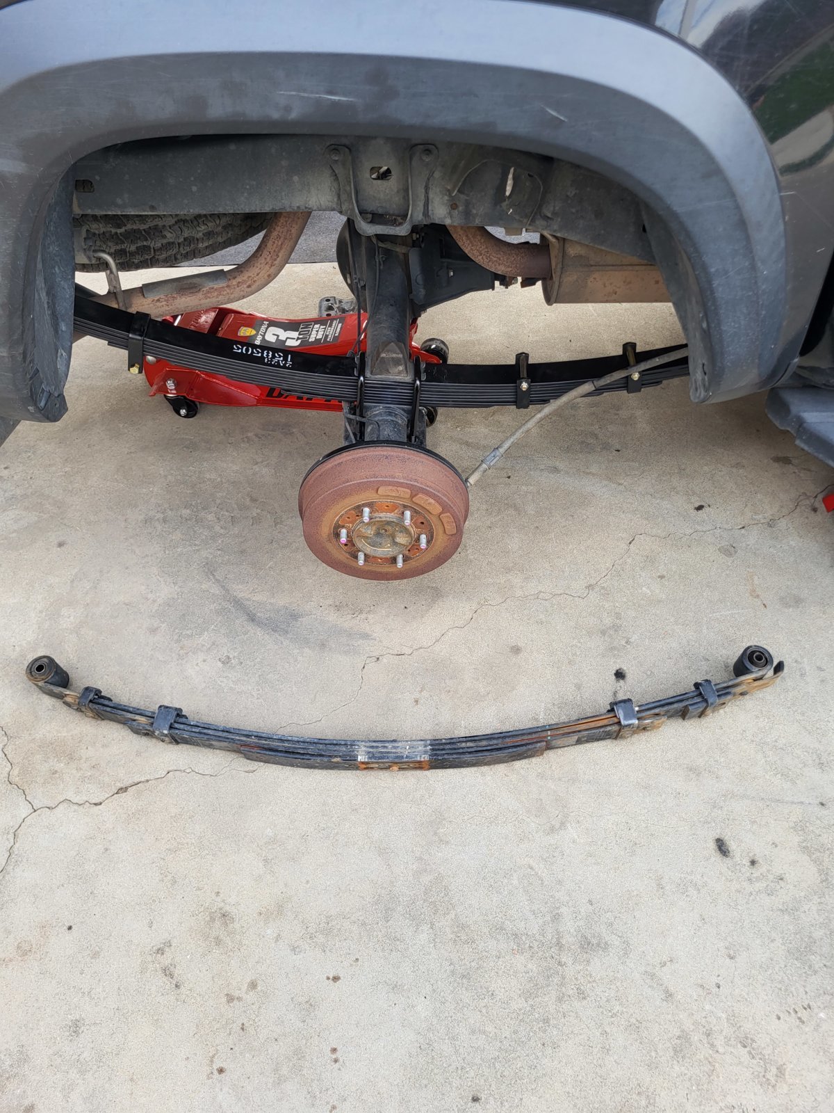

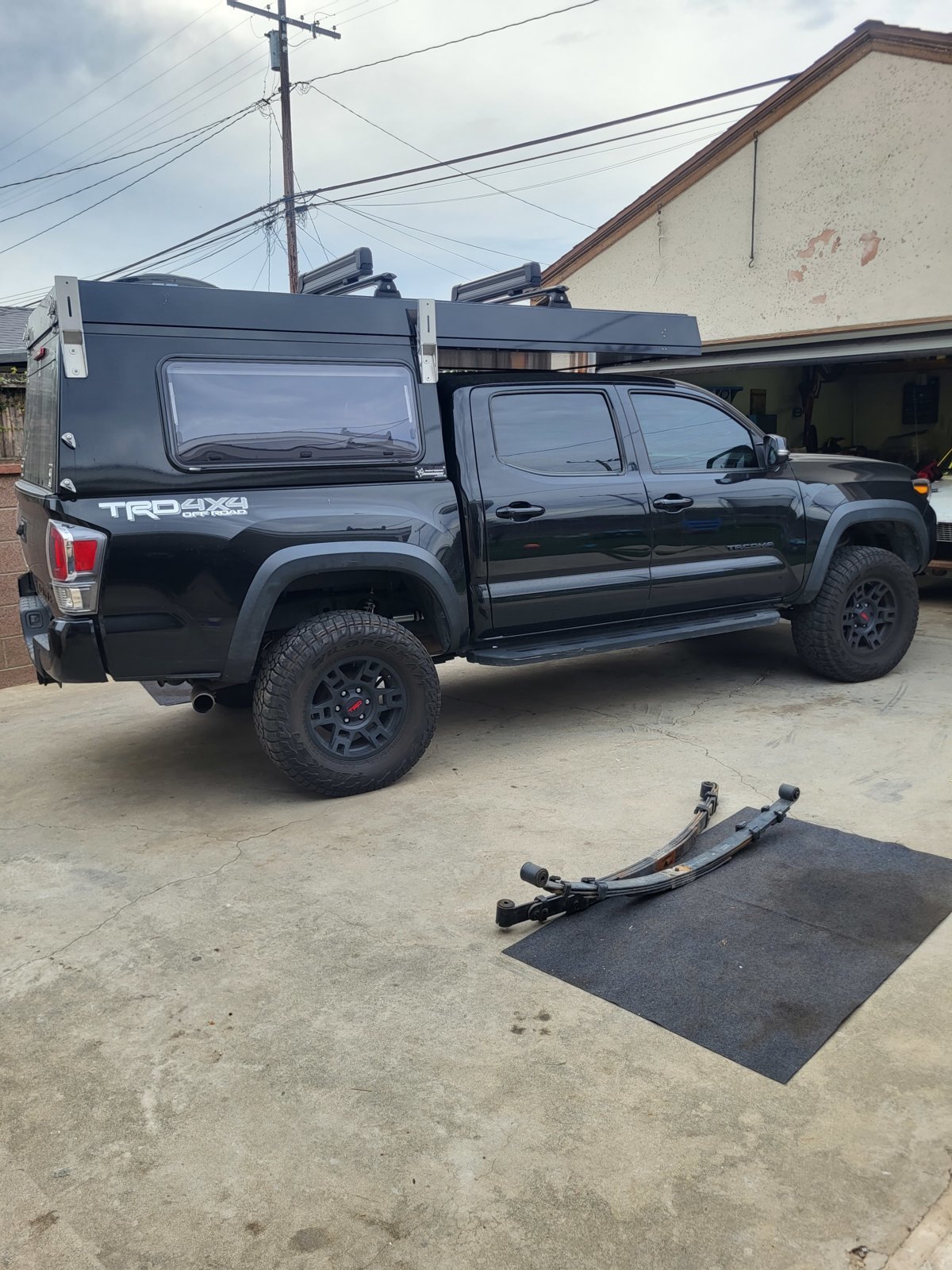

    Icon RXT leaf pack assembled by me to stage 3. Bilstein 5160. Nice set up for sure! Truck was sagging in the back and now is sitting much better.

    What camper is that? Looks beefy af
    nm just saw the logo guess it’s an at overland

    Yeah AT overland. I've worked with one in the past on a GMC truck. They are really nice.
