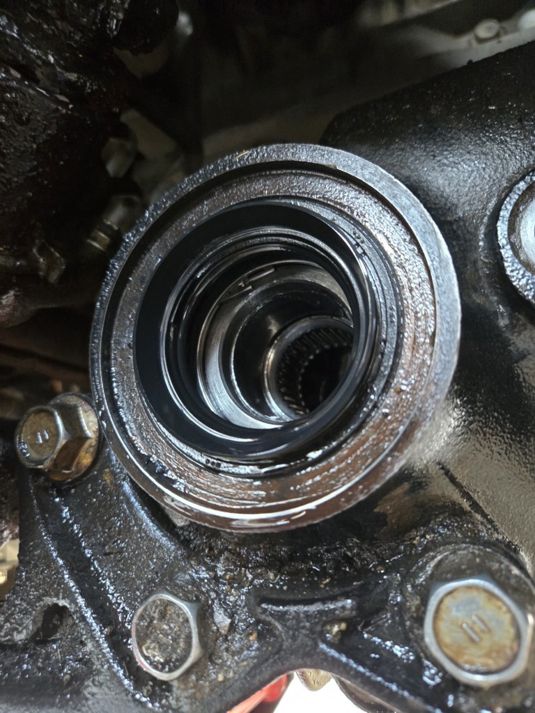

    This 3rd gen Tacomas needle bearing got the best of me this weekend. This trucks needle bearing completely exploded. I have done over 30 needle bearing to ecgs bushing swaps, never seen one actually destroyed.
    The shell or cage of the bearing somehow was shoved inward. Making it impossible to use the ecgs removal tool or even my blind hole puller. I tried for hours and ran out of daylight. Unfortunately the needle bearing shell will likely have to be cut out. At least I was able to get most of the needles and metal out of the diff and change the seal. Owner is going to take to a gear shop for extraction.
    Lesson is, replace them needle bearings with an ecgs bushing if you are lifted. Just do it. Don't wait until it's too late like in this case.

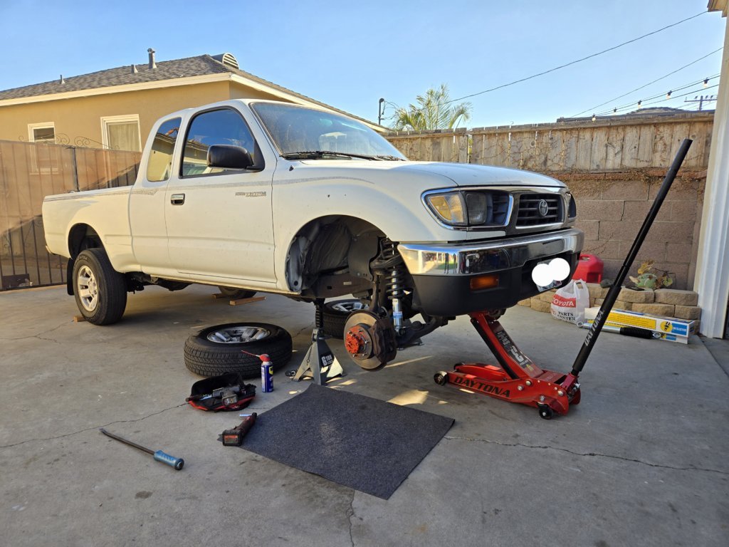

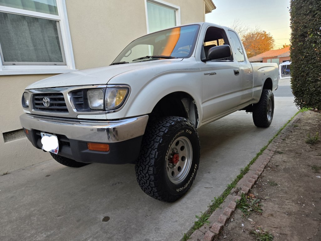

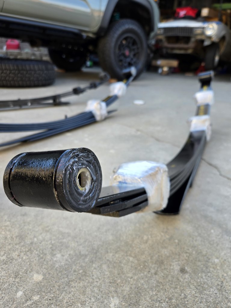

    Two Tacomas last weekend!
    1. Installed a very nice set up on this 23 Tacoma. Dobinsons full heavy weight kit. I assembled the coilovers on my Branick wall mounted spring compressor. Also replaced the needle bearing with an ECGS bushing. Dobinsons is definitely a nice option. I used to be a naysayer, but after installing their stuff, I like it A lot!
    2. OG Tacoma was in for some much needed love. Their front shock was bent and wasn't allowing the suspension to travel at all! It rode so bad! Bilstein 5100 set up installed and more. Truck is back to riding nice.
