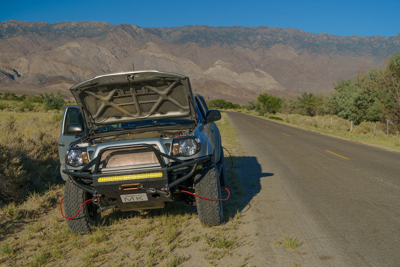

  11. Jul 16, 2021 at 4:28 PM
    #31
    mk5
    mk5 Probably wrong about this
    Mar 15, 2018
    #247373
    1,459
    SoCal
    '05 access cab 4x4
    So a few months later, I finally finished installing the GSPSCN compressor as part of an unnecessarily complicated on-board air system. You can read the writeup here.
    I don't actually have the part number for that compressor, but here's the Amazon link, where of course it is now out of stock:
    https://www.amazon.com/GSPSCN-Portable-Inflator-Compressor-Inflatables/dp/B07MMMKNWX
    I wound up needing a M14x1 die to cut threads that fit the compressor output, and machined my own output manifold thing for it. I believe it was M12 at the far end of the handle, but I deleted the handle so needed the M14 to connect directly to the cylinder head casting.
    It is working, and it's a lot faster than my old setup. But I still wish it was faster!

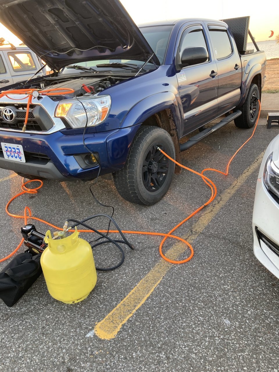

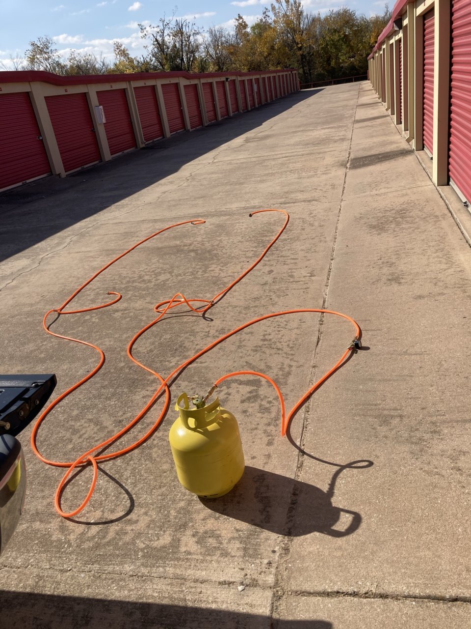

  13. Oct 13, 2021 at 5:31 PM
    #33
    SPARROW66
    SPARROW66 Well-Known Member
    Sep 10, 2017
    #229625
    85
    RAYMOND
    OKC
    2015 DOUBLE CAB 4X4
    LED INTERIOR LIGHTS
