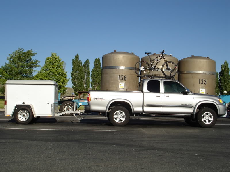

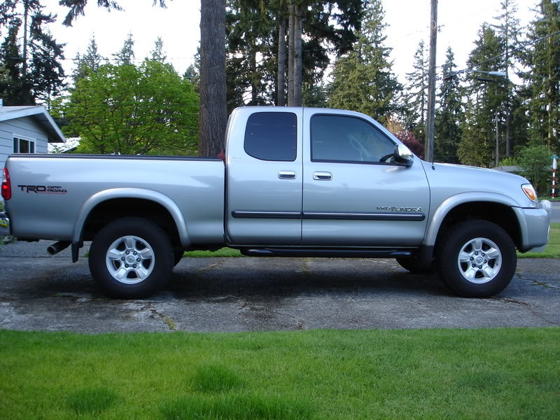

    Here are some photos with the SS installed you can't see them and I apologize for not having better pics. Oh the front is lifted 2" and the rear had a one inch aluminum block installed in the rear. The SS lifted it just a bit. The tires are stock so it may look a little funny to you. I had the trialer loaded to the max and the bed of my truck was completed filled with my tools and other junk. This was essentially my entire life packed up (my road trip/divorce run of 06) and I had zero problems with the truck, towing or suspension. I'm local up here too so if you need a hand installing them, just let me know, it's really easy...
