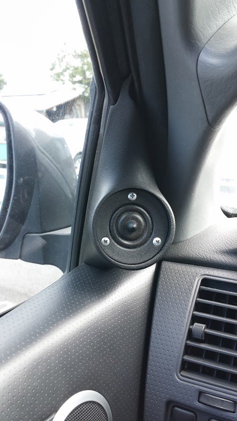

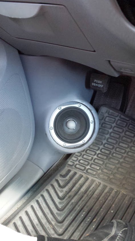

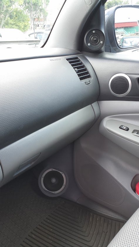

    Man, I haven't updated this thread in 3 years! Well the system was completed and i've been enjoying it for the past 3 years. However, things change and my company would like to buy my truck and allow me to use it for work. This allows me to be covered under our companies insurance and travel onsite to projects that need some crazy insurance liability amounts. Becaue of this I have to remove everything from my truck and return it back to stock. Well, here are some final pictures of the completed kicks and sails. I know it looks a little dirty, but after 3 years it does get like that. Good thing it cleans up really well!
