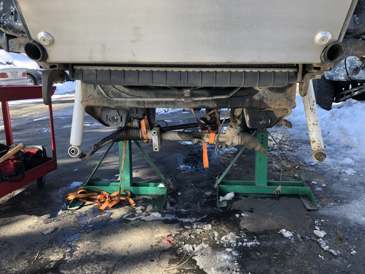

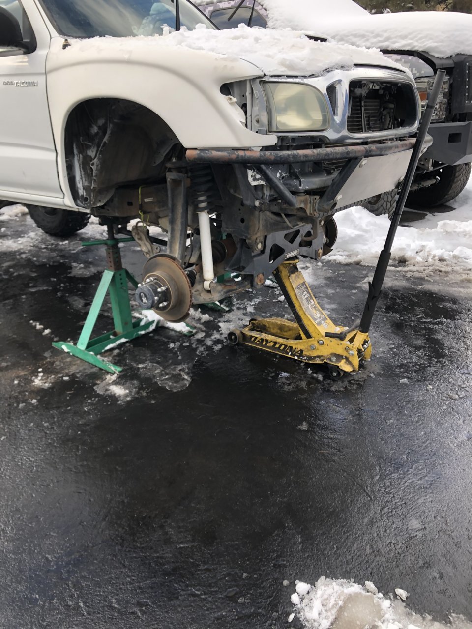

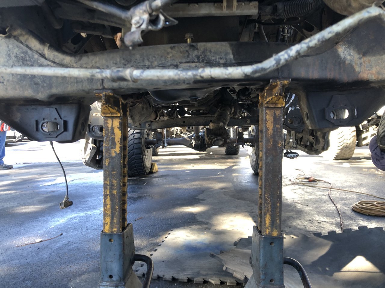

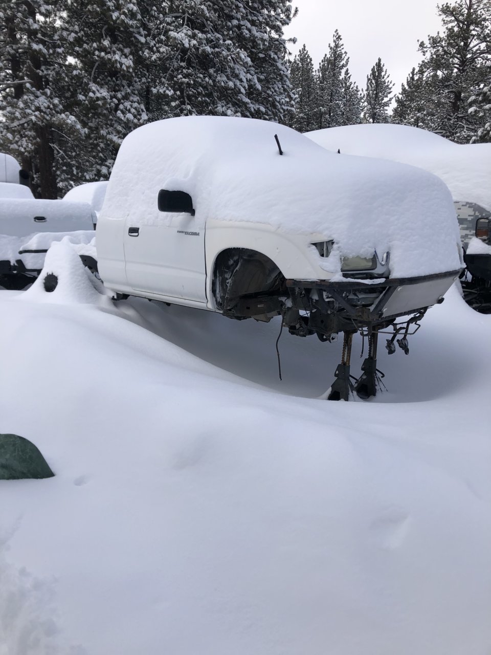

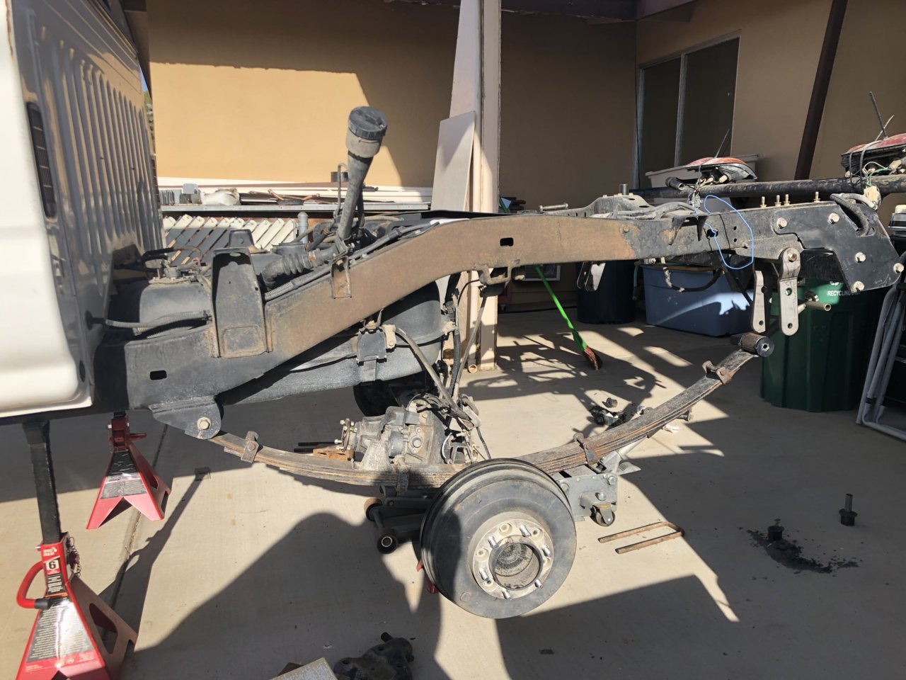

    Well it had snowed on the first day I was to work on my truck, so plans got a little skewed. After clearing out, got it up on jack stands.
    got the wheels off
    I don’t mind working in the cold too much but the wet and ice is not my favorite.

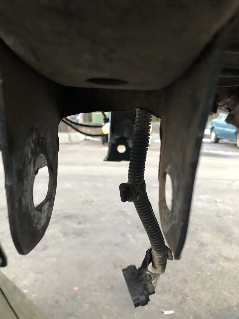

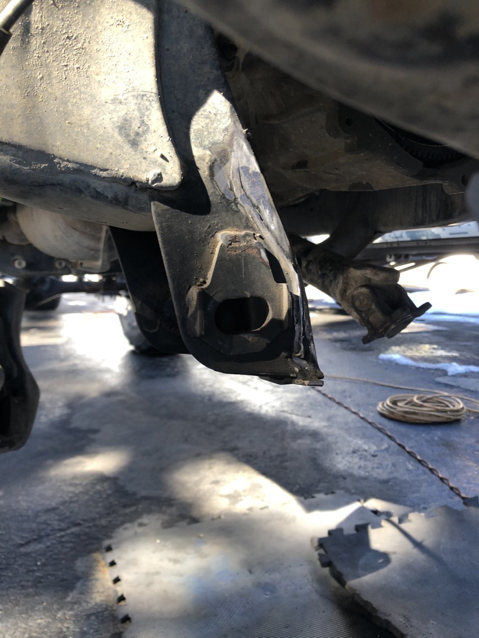

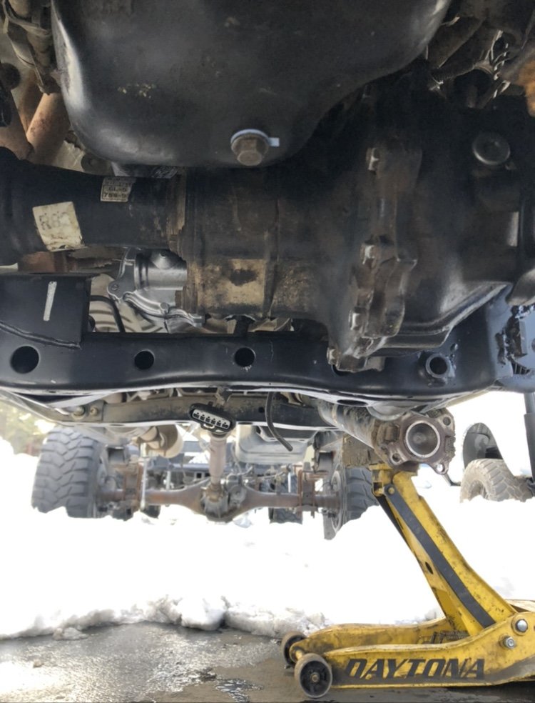

    We got the lift out by: 1. disconnecting the shocks from lower control arms(LCA), 2. upper ball joints(UBJ) from spindles. 3. Removed and hung; rack and pinion and front drive shaft from front diff. 4. Unbolted the fabtech crossmembers and lowered the entire assembly out on to cart.
    here’s a peak of underneath with out the fabtech cross members.
    i will be updating this a lot more, and with more pictures/videos. I’m filming a lot of this in video and time lapse.

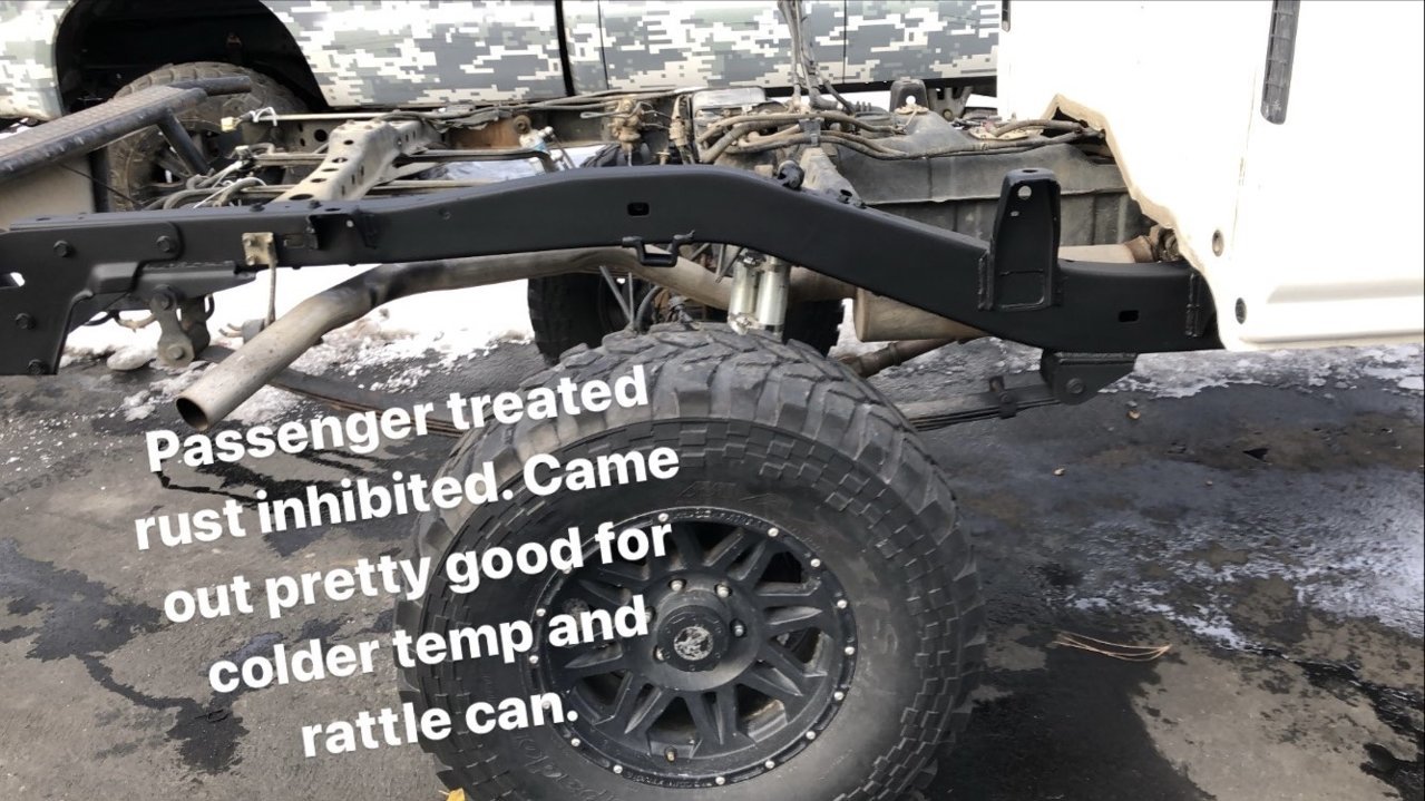

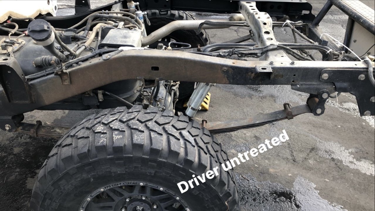

    Did some prep and painted/treated, with rust oleum rust inhibitor, the passenger side of the bed frame rail.
    Driver side before treatment
    C08F0255-7679-4970-9697-F8980EF7C782.jpg Passenger after treatment. They were very similar before conditions.

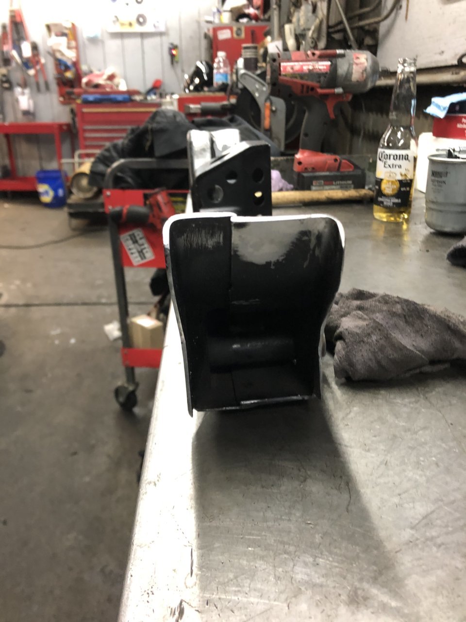

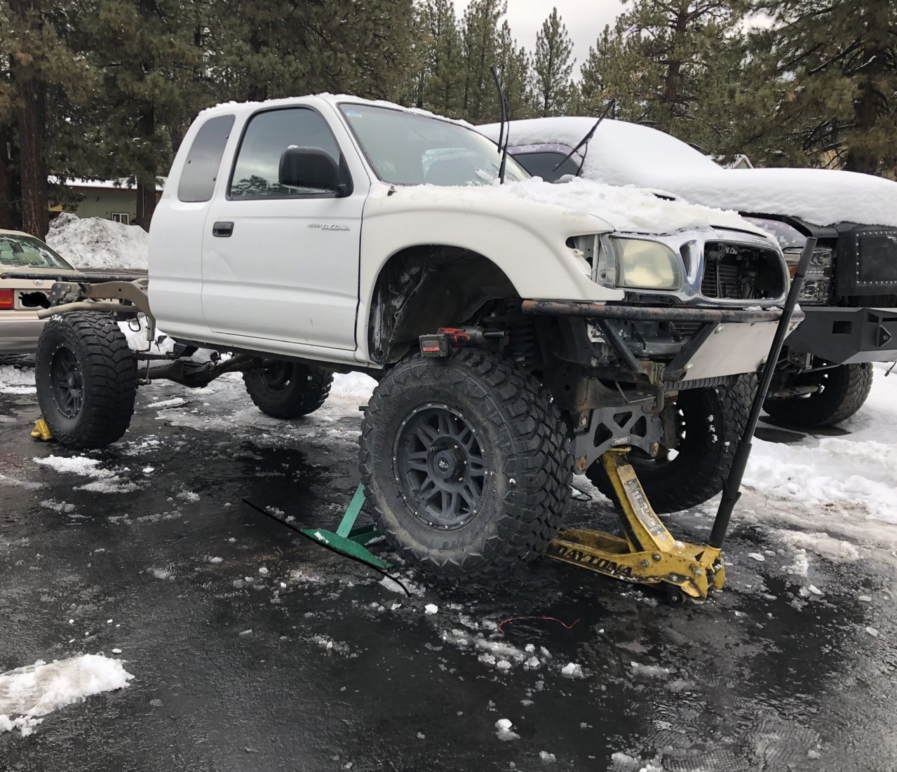

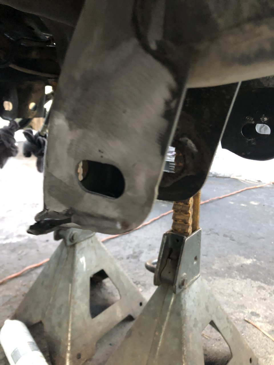

    Well, I missed the week of 50°+ last week while I was gone, and it snowed 3” today. I did get some more steps in today though.

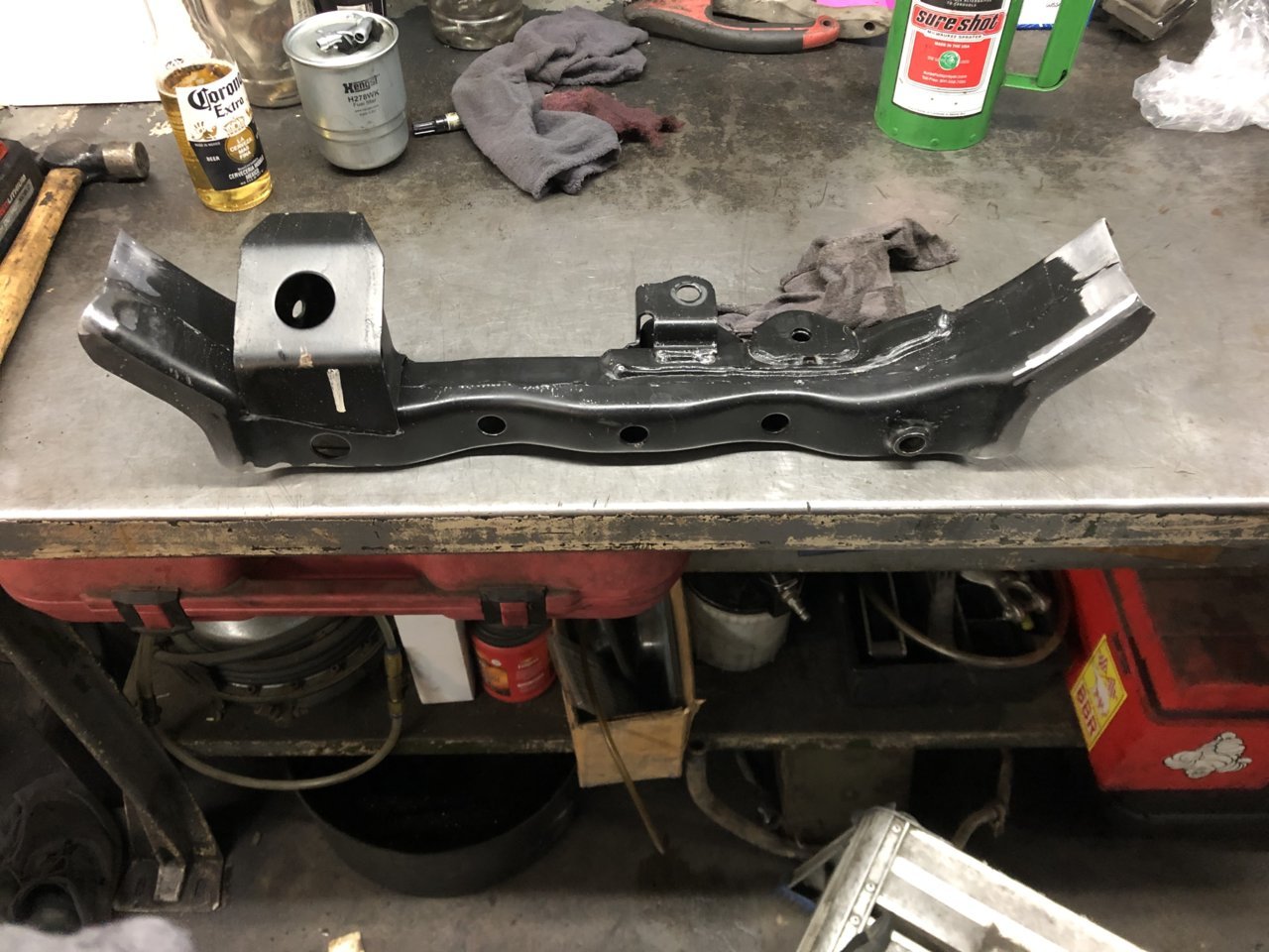

    Today I ground down the replacement crossmember to LCA pockets and popped the pockets out.
    Here’s both sides, you can see this crossmember/diff support is basically a sleeve/shell that would sit on the rear LCA pockets and is welded together
    Driver side
    Passenger side

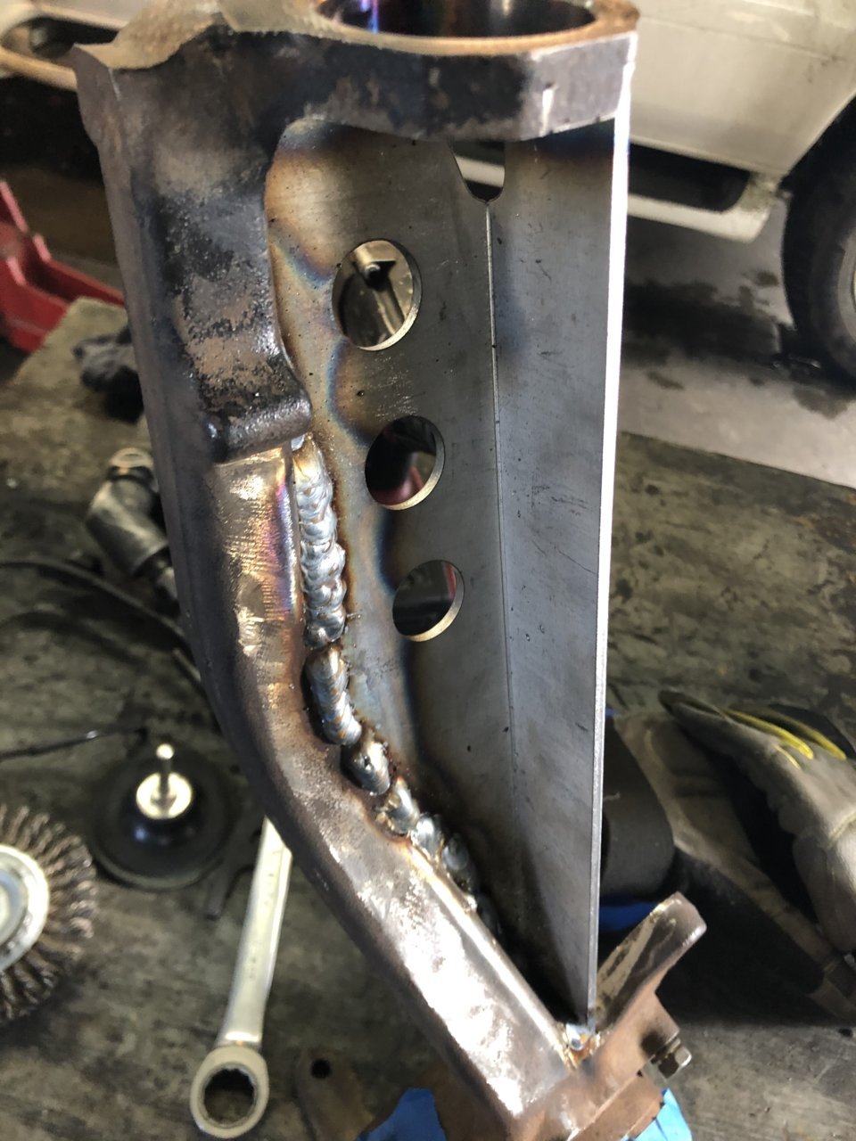

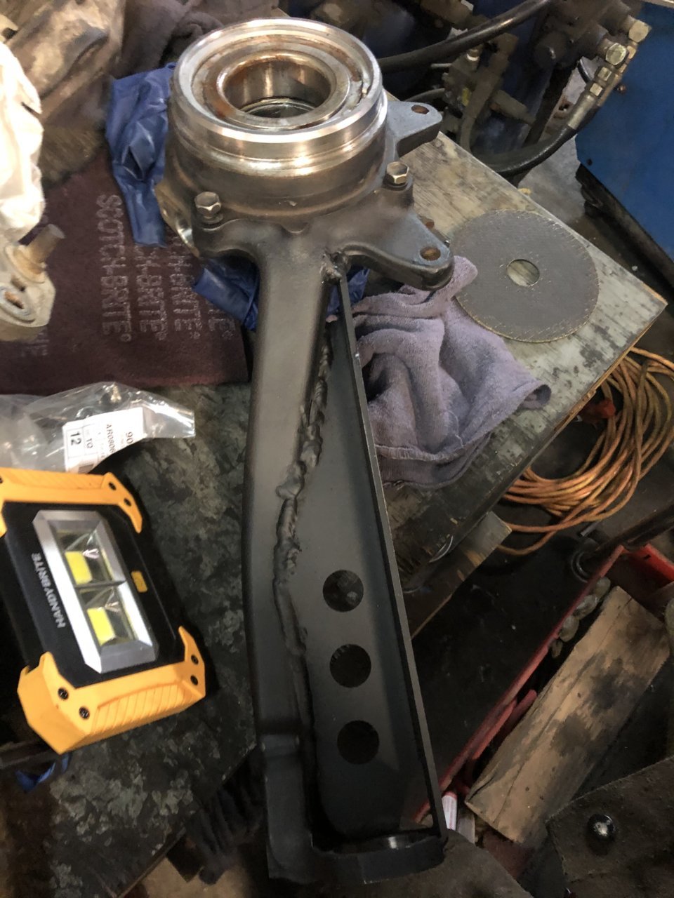

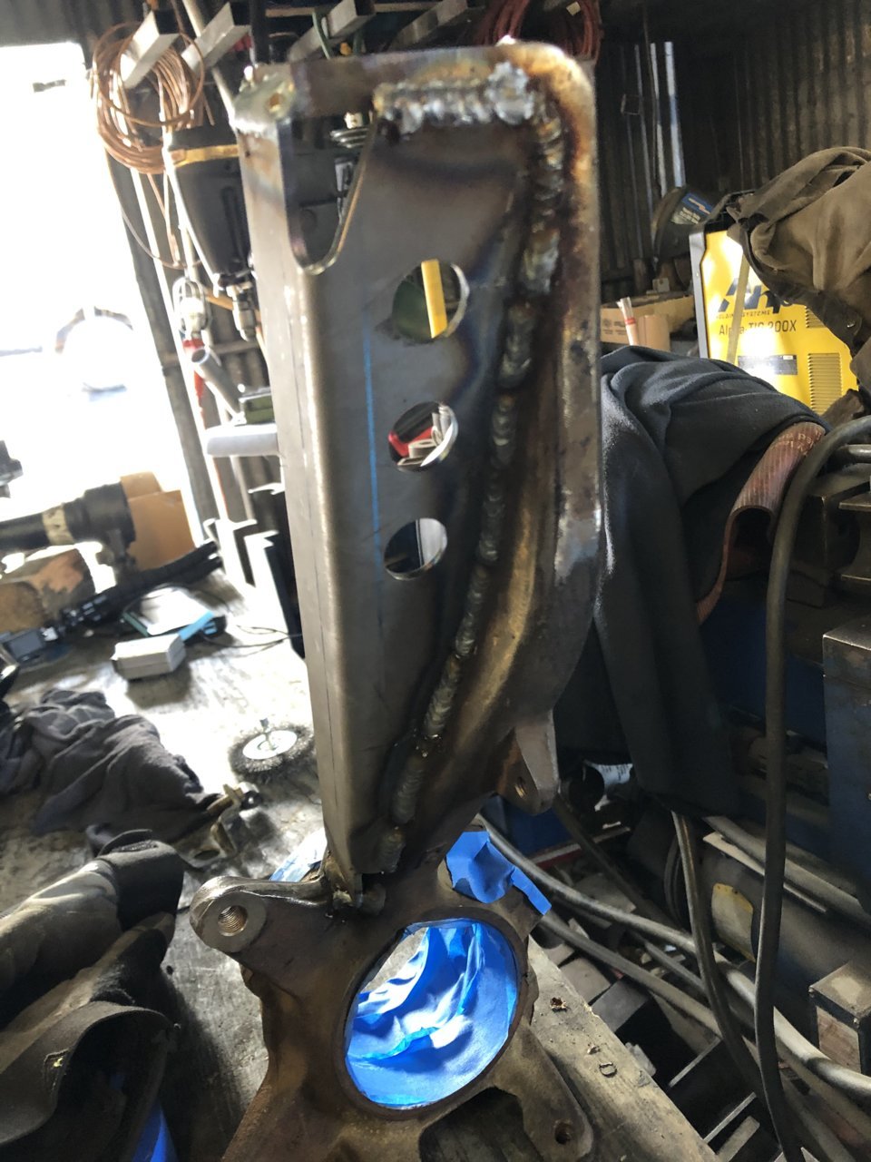

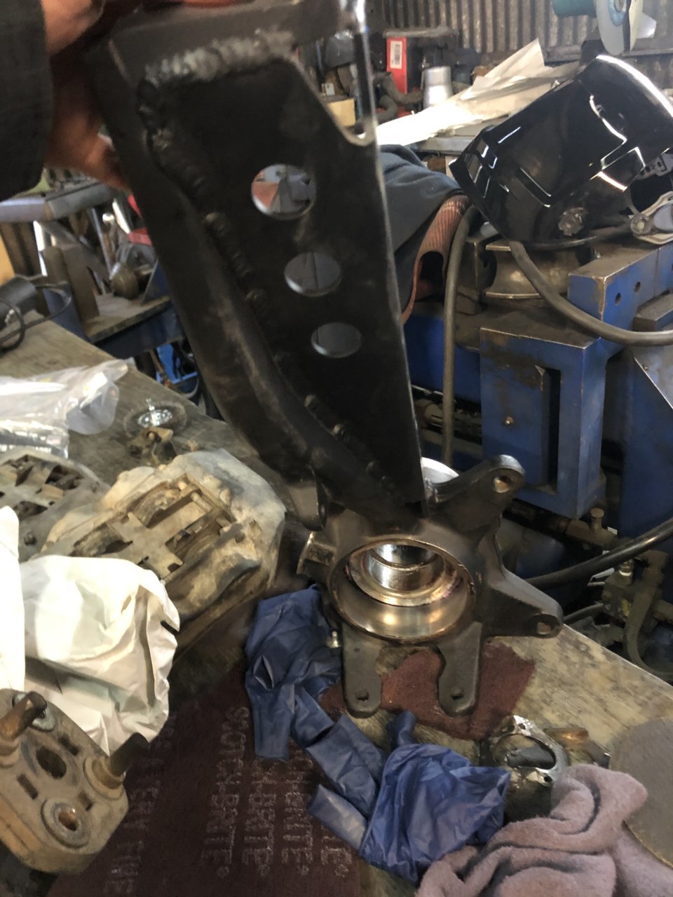

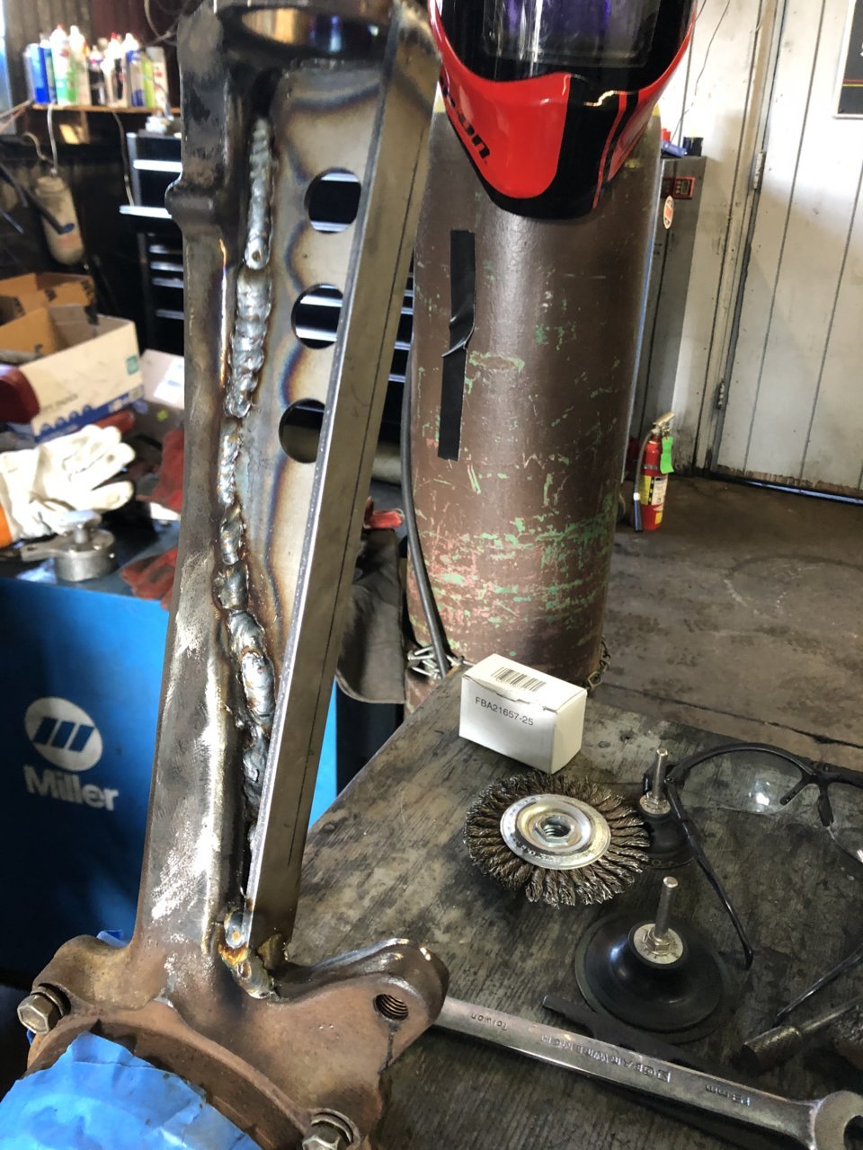

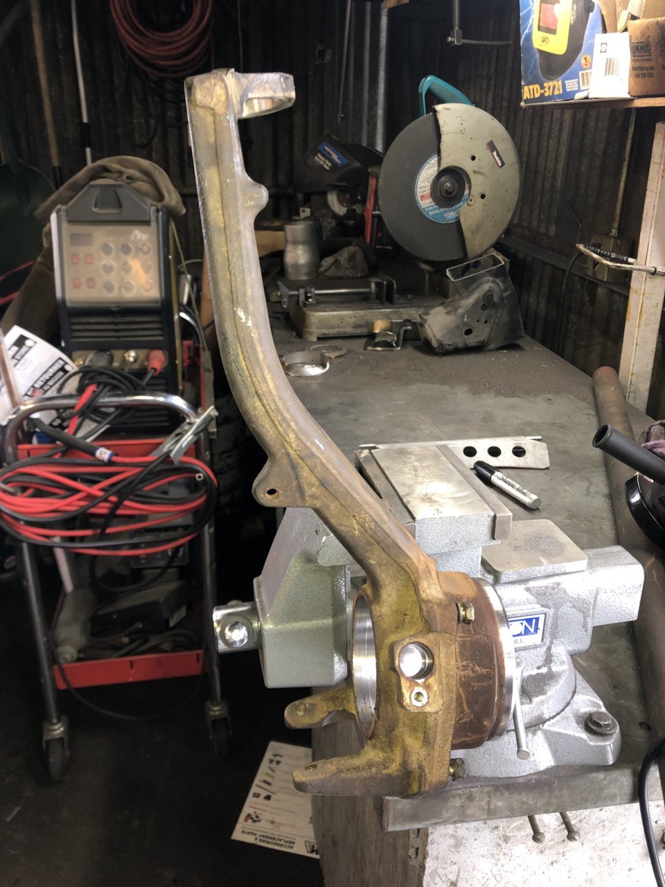

    Alright, alright, alright, did some grinding welding and painting the last couple days. I’m a little slow, school has really gotten me out of my wrench abilities.
    here is some photos of the spindles. Don’t judge me on my welding, I haven’t touched a welder in probably 5 years.
    Grounded/in the process of grindingA61844C8-DE61-4FE7-8B69-5C41C8592190.jpg
    Gusset welded, backside
    3E87740F-66A5-4100-841D-51D093C9752E.jpg Little closer.
    front/outer side
    0BB4B35F-9574-4664-80F0-322E55FA0778.jpg Forgot to get some pictures of the painted spindles tonight, but I got one of the wheel bearings pressed in and had to do another coat of paint on the other spindle.

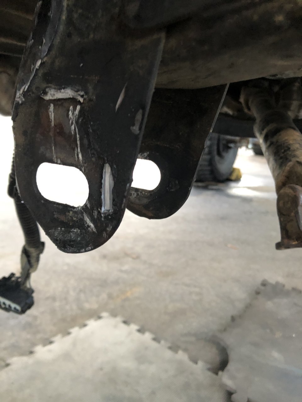

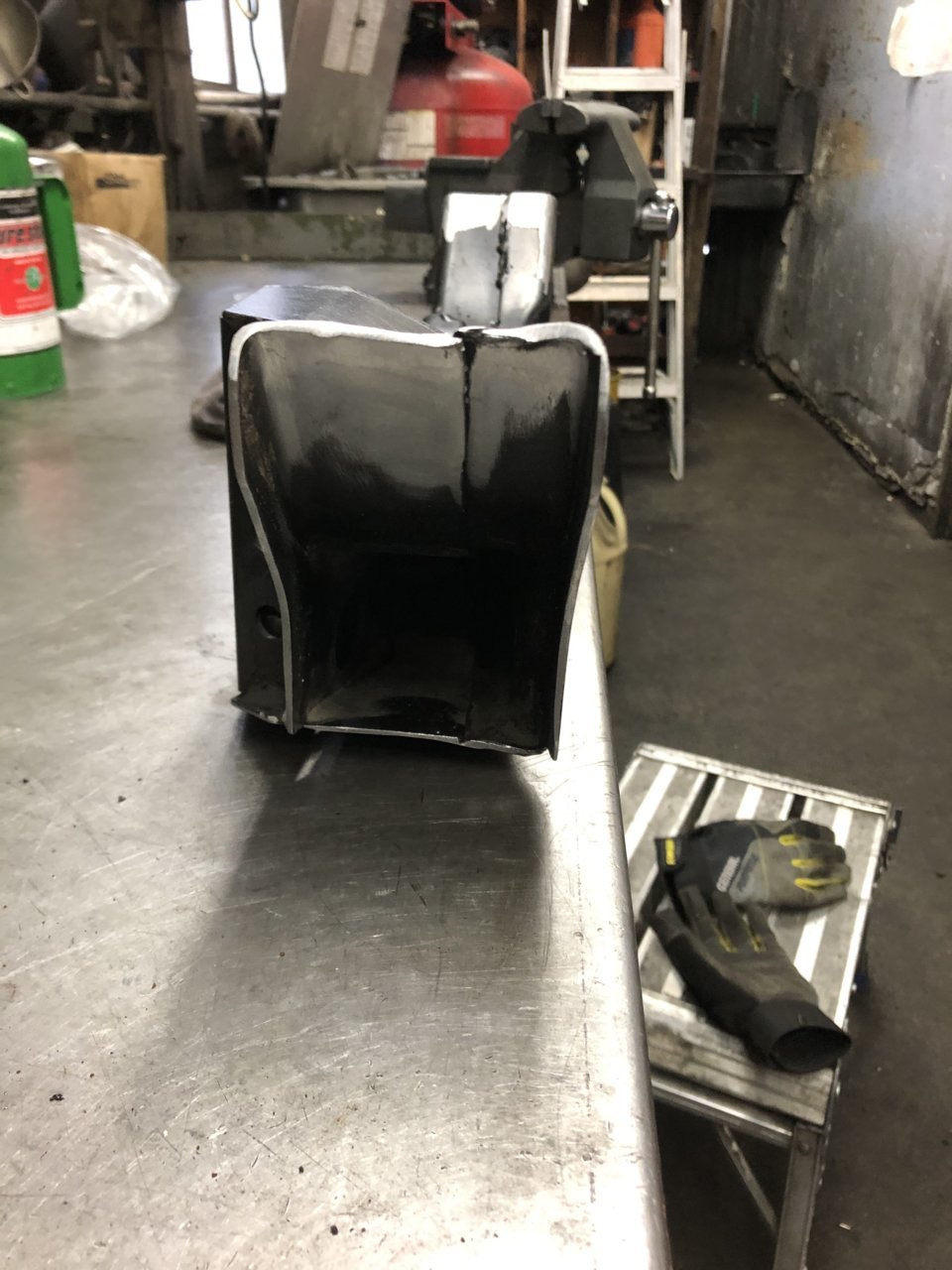

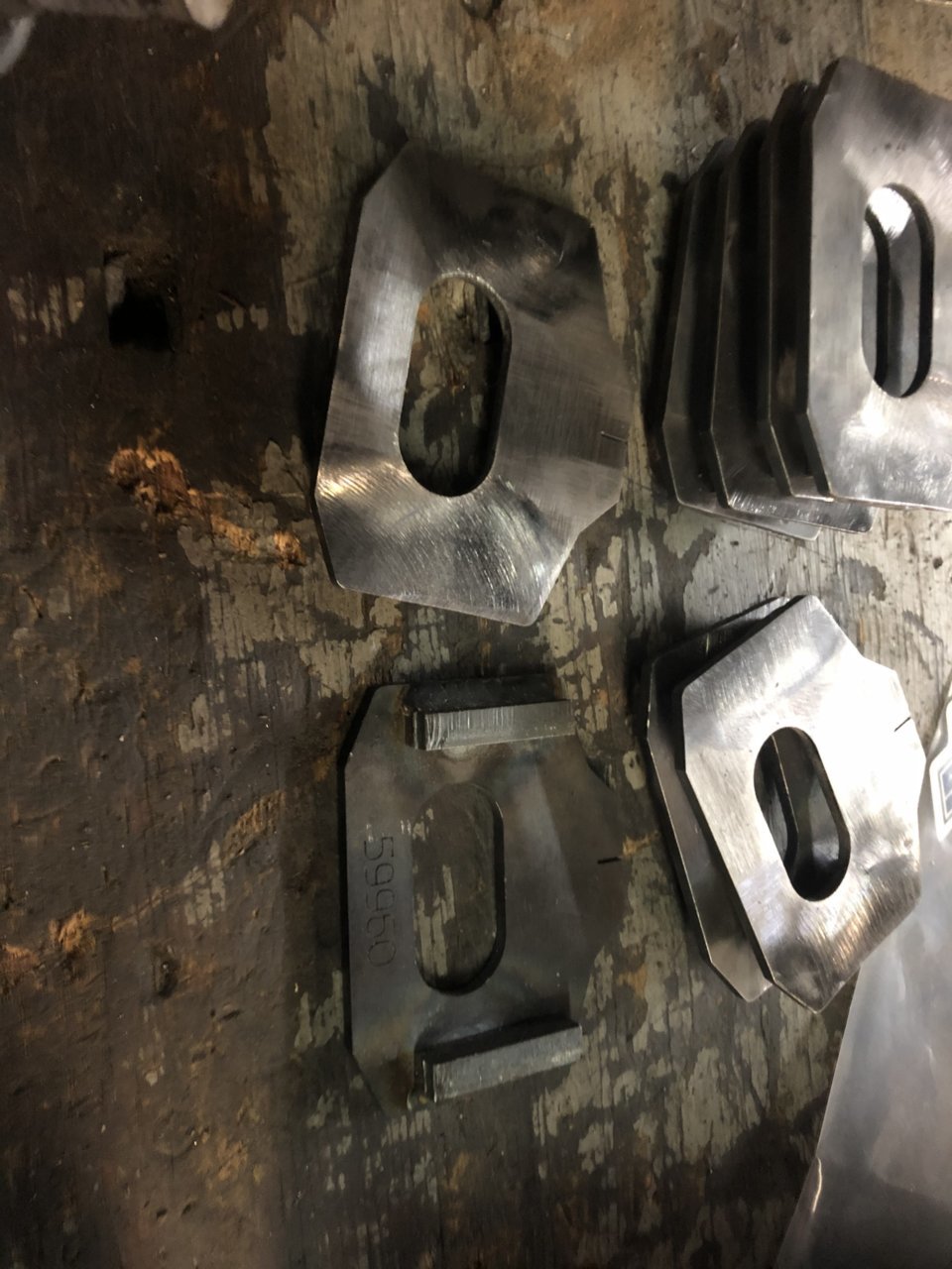

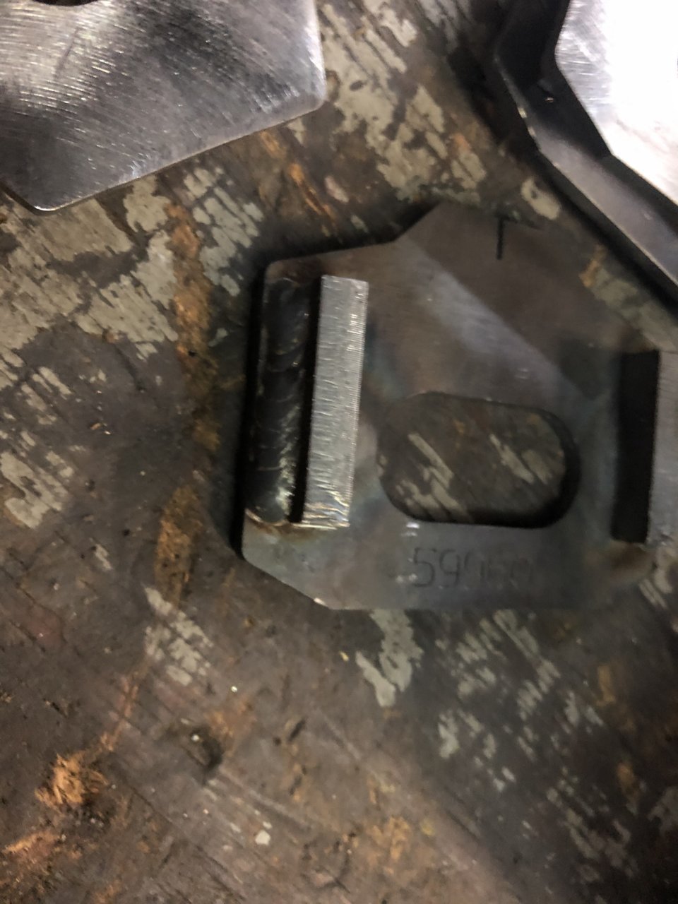

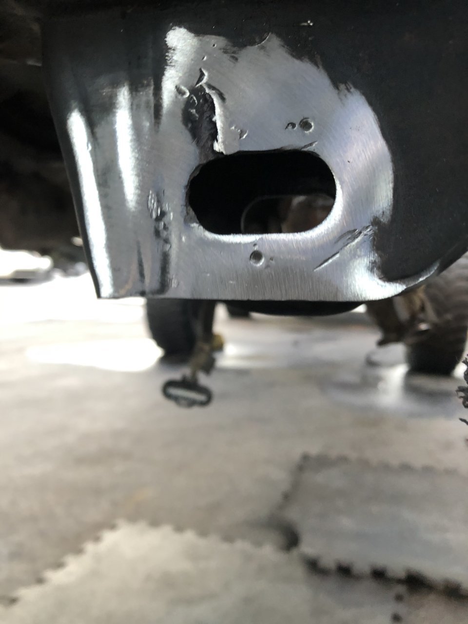

    I got the cam tabs drilled and ground down a bit. Still have to do the driver side but I was getting sick of sitting crouched under my truck. Here’s what I got so far, and some shots of the cam pockets.
    Here you can see where my buddy cut the rest of the “sleeve” of cross member off of the LCA Cam pockets.
    Rear cam tabs grounded and air hammered off
    This was the first front tab I had to drill the spot welds on, and I came in at a weird angle and got a little trigger happy with the air hammer and cut into the pocket on the top left there. I’ll straighten it out a bit more, weld and grind it flush before welding the tab in place.
    Passenger side tab removed and grounded ready for crossmember to be welded in.
    This is looking from the driver side to passenger on the rear cross member/front diff support, you can see through the driver side pocket... you shouldn’t be able to... who ever installed the fabtech lift cut WAY too far into the pocket. I cut out that piece from the donor frame section and will get it welded back in so it’s braced.

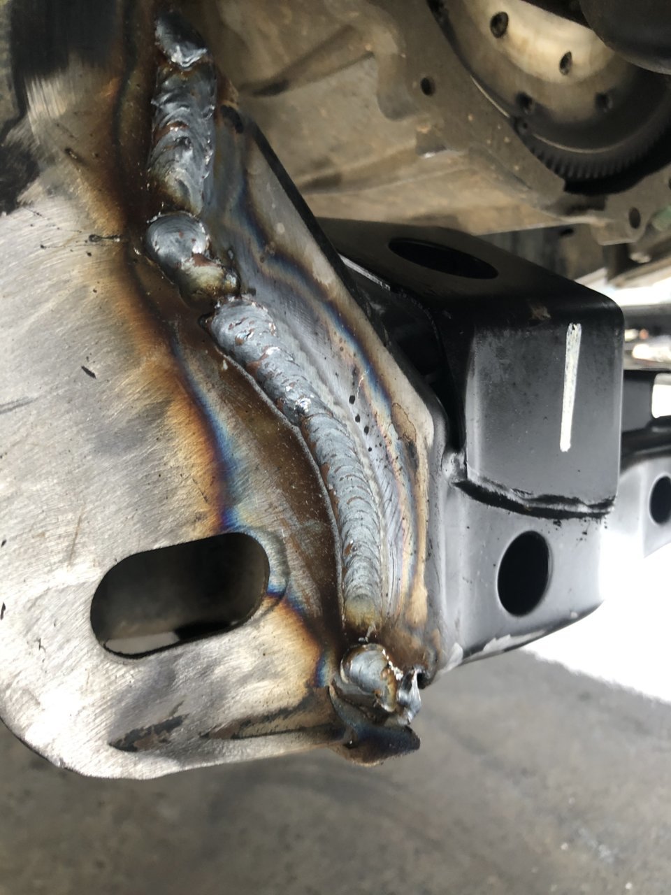

  9. Jan 22, 2021 at 5:58 PM

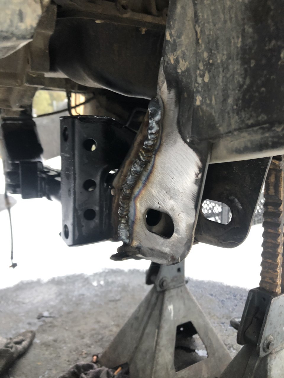

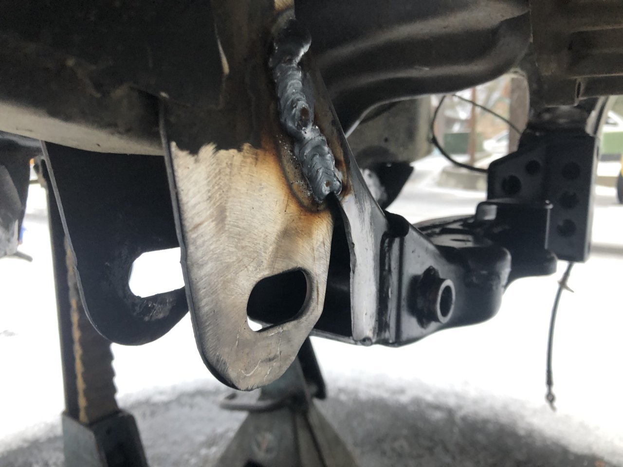

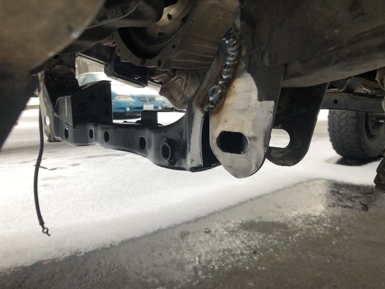

    here’s the big one, got the cross member welded back in! Going to still need a bit more fabrication, I’ll figure it out when I get the cam tabs lined up, since their placement may provide some material for the gap on the drivers side pocket.
    Passenger front, quite happy with this weld.6B710320-19B2-4F83-A432-46BAE2DB3C9B.jpg
    here on the drivers side photos you can see the gap that I’m going to have to fabricate a bit and get some plating in there.
    drivers rear
    Drivers front
    Here’s the cam tabs all welded together and ground flush. 937D1319-9AFB-42E7-9128-E3578C19E78E.jpg

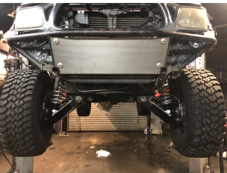

    Well, it’s been a little while, but I “completed” the project! I drove it out to hammers wheeled fairly aggressively and MCM LT kit did amazing literally absolutely insanely good even with out the bump stops added in yet. The rear could not keep up though.
    I surprisingly didn’t get any video or pictures out at hammers, Life has been moving quick for me the last couple months. I’ll be back to clean and edit this post up soon, but as a bit of an update here’s two photos.
    first of the crossmember welded and painted and the front diff bolted back in.
    and secondly, a free/full droop on the lift. Also, those are 315/70r17s for perspective.... while wheeling through the whoops I never bottomed out the front. only limiting factor in the front was these giant tires rubbing and bumping aka self clearancing the inner fender.

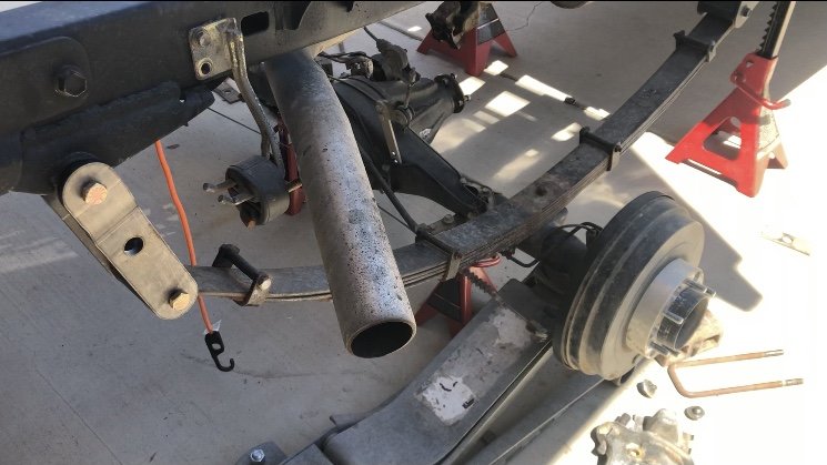

    Well making “progress” on this ol pig. I mocked the 7in shackles after removing the 3inch lift block. I THINK it’s going to work. Waiting on u bolts and looking for an extended rear brake hose.
    pulled the leaf packs and sanding them a bit and painting them and replacing the leaf bushings. Going to sand the drivers side frame and get some rattle can rustoleum rust converter on it for some protection. 649695C3-97E1-4415-B7D6-FB8360EF8F2B.jpg
