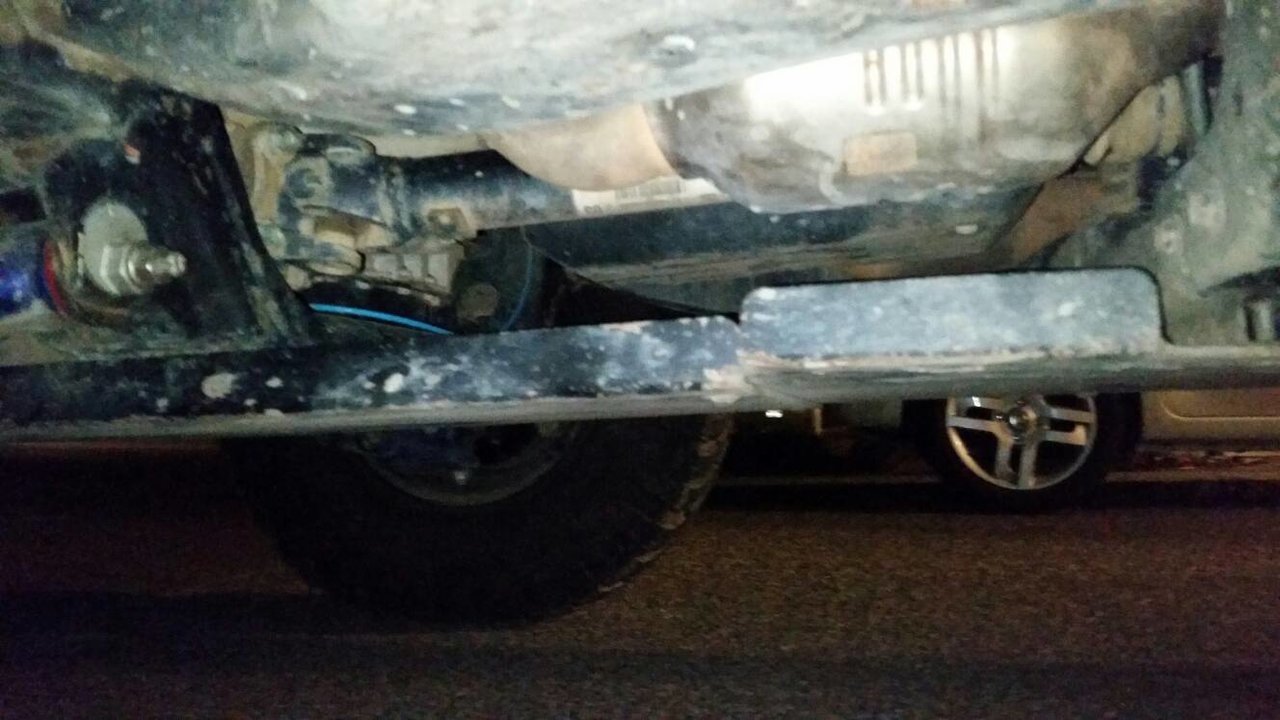

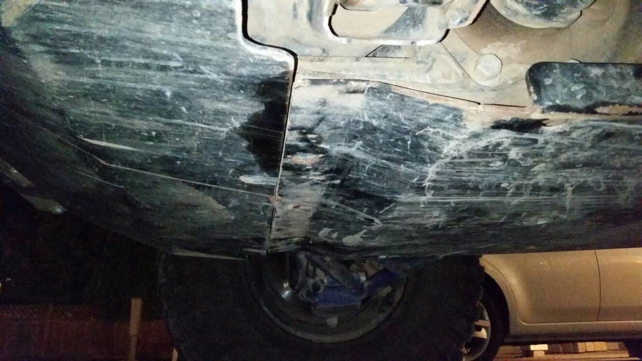

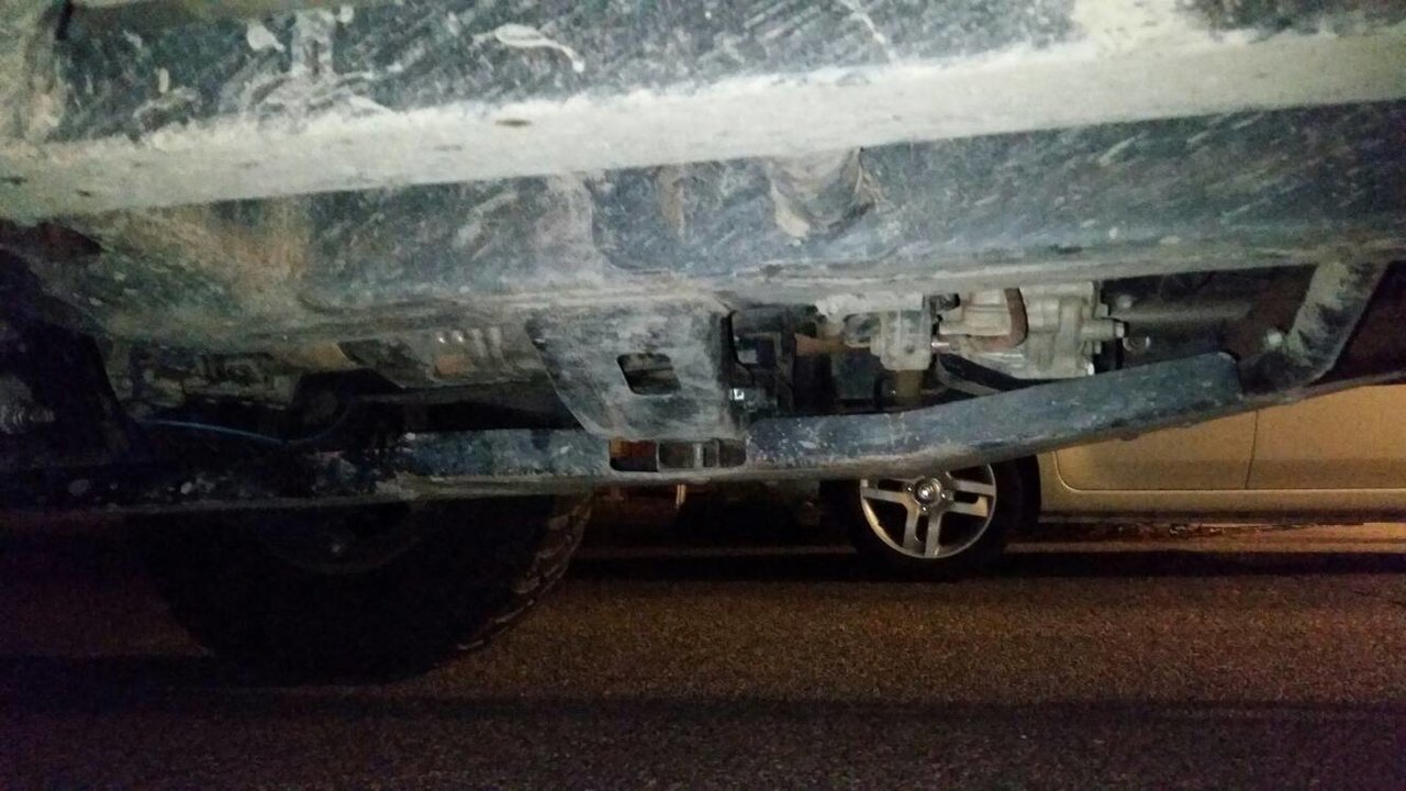

    I will takes some pics just to give you a better idea.

    Start of the "mid" skid
    End
    Start of the t-case skid

    true once you sas the truck basically all the skids are useless and you have to build all custom.

    truck is just outside so i thought i would just snap some quick before i forgot. unfortunately no the spacer can't be taken out without reworking the mid skid. basically the back end of the mid skid needs to be brought up 1 inch, then the spacer can be removed.
    im going to be doing that soon to my skids for the extra clearance now that my exhaust crossover is out of the way.

    its barely any work at all. just going to cut the mid skid, then cut a 1 inch strip to weld in vertically right after the rear suspension cross member, that will take up the space that the spacer would occupy. will probably add a few gussets on there as well so i know it will be able to take the weight of the truck.
