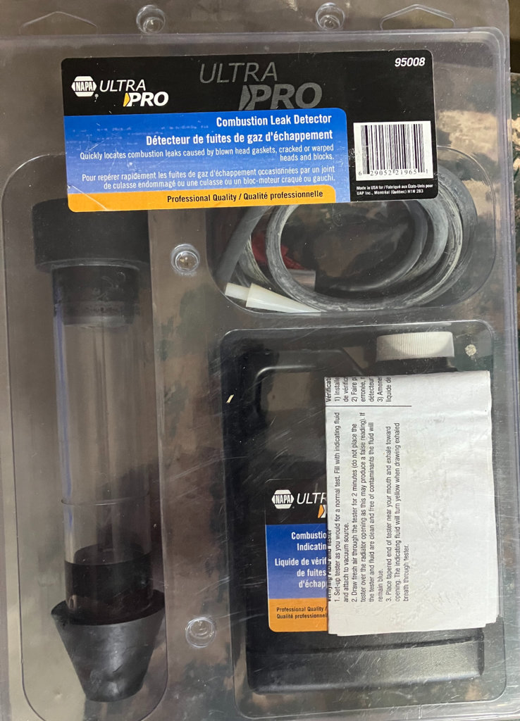

    It’s pretty easy to test for exhaust gases in the coolant

    How? I’ve read some say start up cold, pull radiator cap and check for small bubbles as it warms up? No bubbles on mine but the coolant starts pushing out the cap before it gets to temp. Buddy said park on a hill so rad cap is highest point to burp the air outa the heater core? Ima try that next. Both trucks have 160k

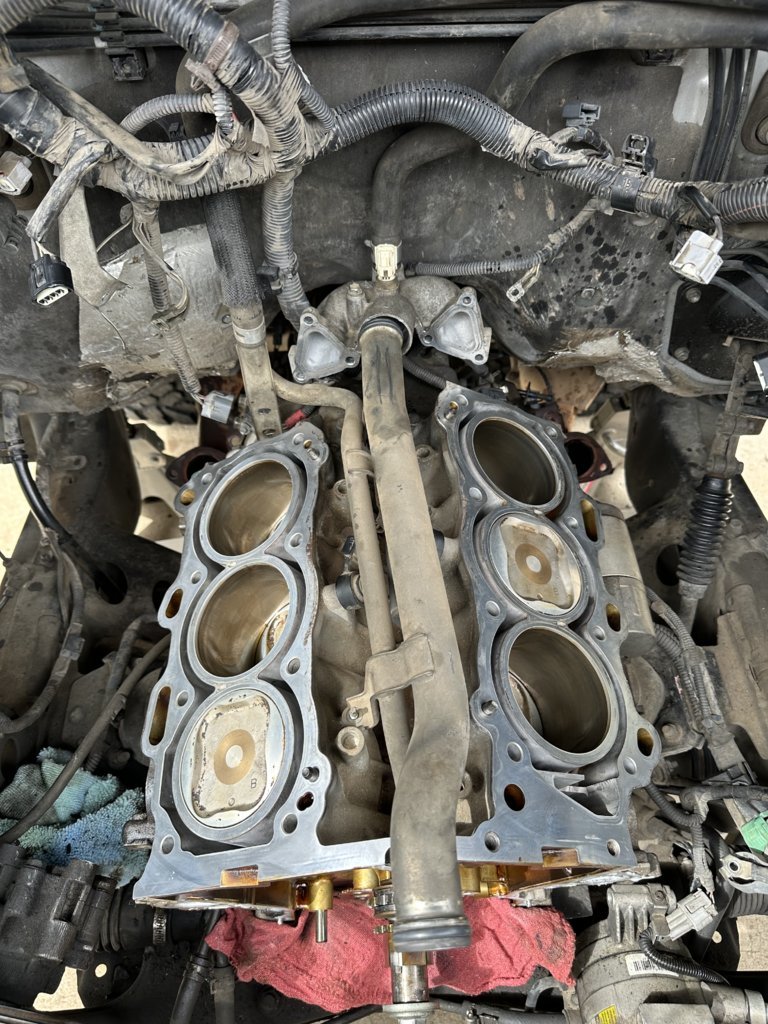

    My truck is a 2008. I had the reserviour going up and then NOT going back into the radiator when cool. Coolant entering cylinder 6 (which can cause misfires) have 264k miles and just finished the job

    Mine passed the test however with the scope you could see coolant in the cylinder and also the gasket was blown when removed

    If the res wasn’t going back down that seems like the exhaust must have been causing an air bubble in the system? Or your thermostat was stuck closed? Mine is returning to the full line. My ‘06 misses a tiny bit for a minute on startup in the mornings then clears up. Done that since I bought it 10 years ago w 100k. I’m dreading head gaskets! Good work getting your done man! Tnx for the pics! I think I got a buddy w a scope?
