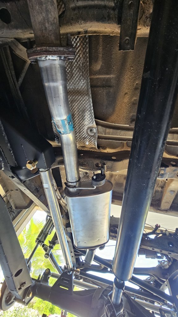

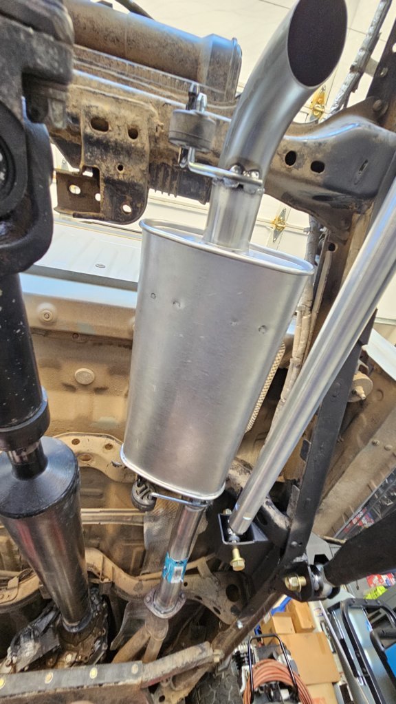

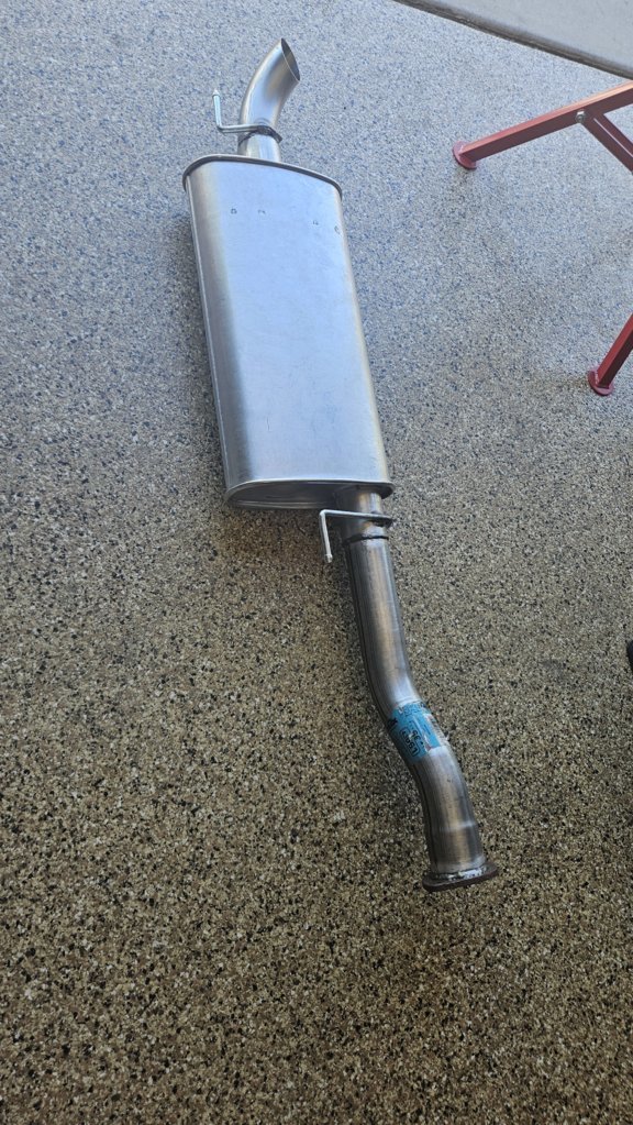

    Exhaust done!
    Nothing fancy, Dynomax super turbo 2.5" muffler with a turn down before the axle.
    I was always hitting the stock muffler. I put this high up, almost above my upper link. It's so high even Snoop Dog couldn't hit it.
    I have some high temp ceramic paint I'll put on the welds to finish it off.

    That's a bold statement. (...and pretty damned high!)

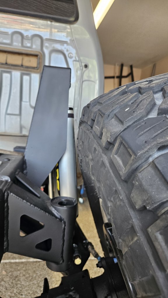

    Got sliders modifications done and painted. Rear bumper tube is cut back to fit a 40. Capped and painted. (No pic of it finished)
    I'll probably need a thicker spacer for the 40s. This is my 37 with a 2" spacer at full stuff.

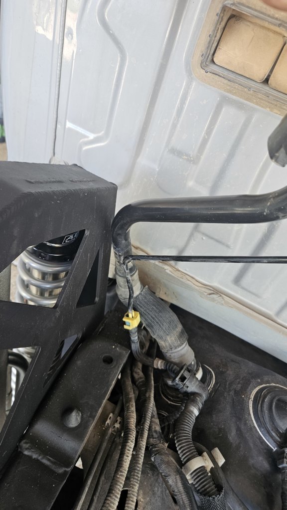

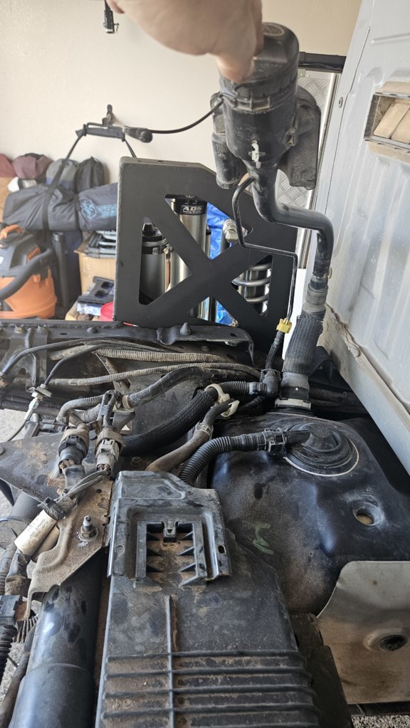

    Next pain in the ass thing to tackle is modifying the fuel fill neck. The coilover is sitting right where it used to run. Going to have to route it up and over the shock tower. Will probably involve putting on and taking off the bed once or twice.
