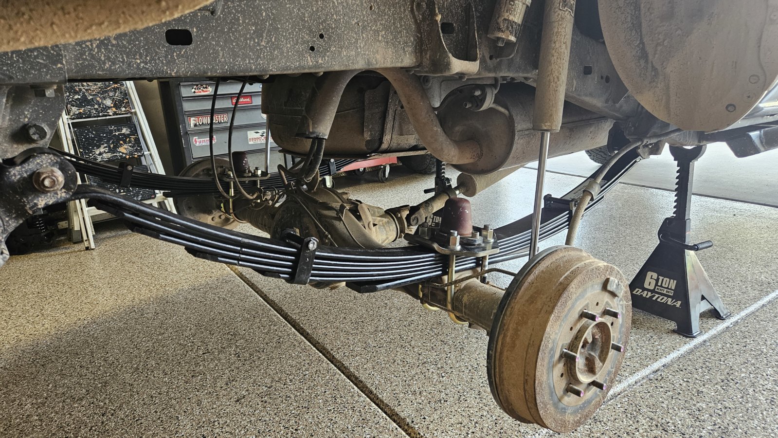

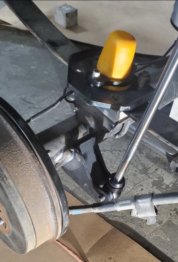

    Sweet setup. I am also looking at doing the skinny kendas with a shock relocation. I assume your not rubbing your rear shocks at full stuff right? Any idea how much room is in there?

    I haven't measured but it's really close. It doesn't rub though, never a clean spot on the shock after wheeling. When I welded the lower shock mount on I kept it more inboard, close to the U-bolt which helps. I don't have any good pics of it, this was during mock up.

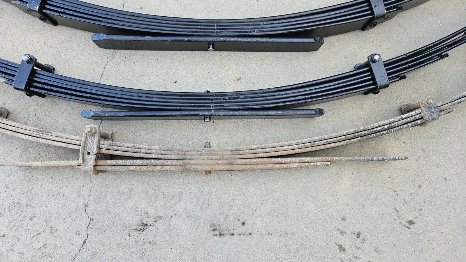

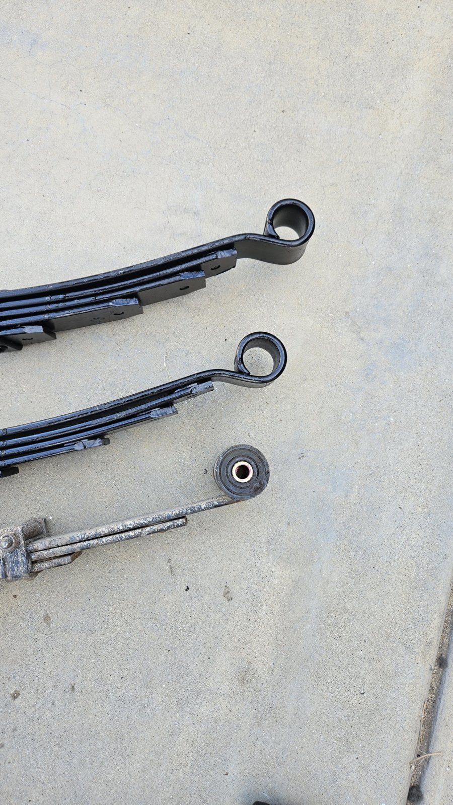

    Little change today. As the truck continues to get heavier from armor and camping loadout my Dobinsons 110's leafs were starting to complain. They have been an excellent spring but it was time to step up to something with a little more Capacity. Enter the Archive Garage MD leaf springs.
    Archive spring compared to the Dobinsons 110's (which are muddy not rusted)
    Installed
    Rear is sitting at about 26" hub to fender with an empty bed. Hopefully it settles some. Will probably adjust the front up a little also.

    Truck looks good. What made you decide on the Archive Garage leafs vs add an additional Dobinsons leaf and making them into 111's?

    I talked to CrikeyMike about that and I have an older set of 110's that won't accept the leaf upgrade to make it a 111 pack. So with that the Archive pack checked all the boxes for load capacity to lift height, general build features, will pull 14" of travel, and made in the USA.

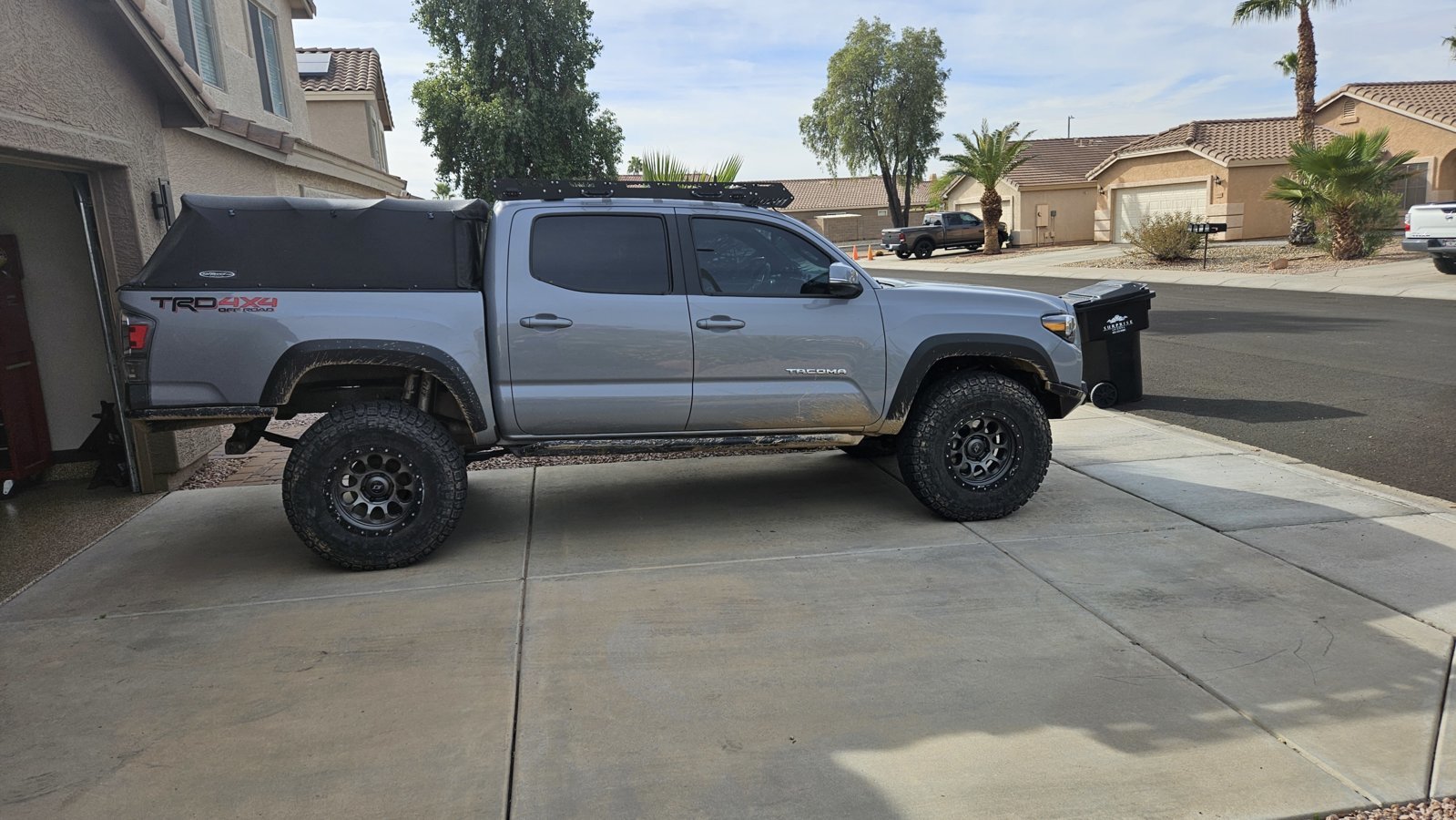

    The new leaf pack looks good! I'm sure it'll look even better when you get the front adjusted a bit higher too.
    Quick question - it looks like you're running a full size 35x10.5 spare in the factory spare location. Did you have to modify anything for it to fit? My 33s are already taking up what seems like all of the available space. If you modified it, what all did you do?

    The pics where the spare is under the bed was from when I was on 33's. The 35" spare wasn't even close to fitting in the stock location unfortunately.

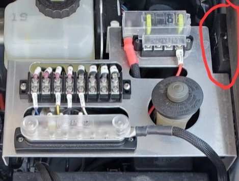

    Taco power dist.jpg I'm really liking your build, I found a pic in the LambTek innovations winch switch thread that shows a very clean power distribution panel that incorporates the clutch reservoir. Is this a home brew panel or did you find a supplier?

    That is a panel that I made out of 5052 0.100" thick Aluminum sheet for my Switchpro wiring and a small Aux 4 position fuse block. The Switchpro (circled in red) is kind of hidden and is mounted on a SDHQ bracket.
    There really isn't a good solution for us that drive real trucks with 3 pedals :boink:
