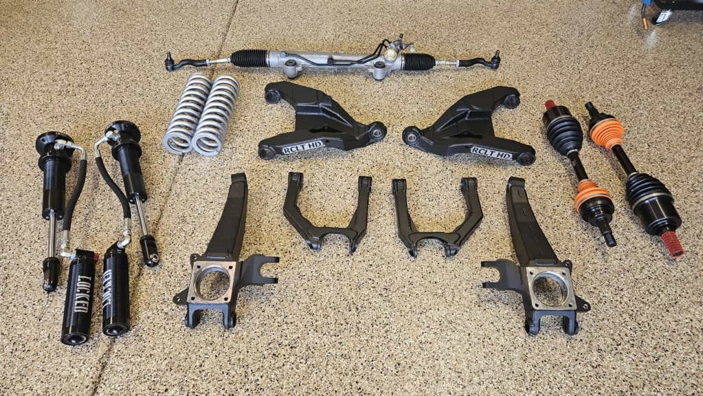

    Let's go!!!! All the parts are here. Marlin Crawler 2.75" RCLT kit, LC200 steering rack, RCV axles, and Locked Offroad shocks.
    The Marlin kit is just beef compared to stock!

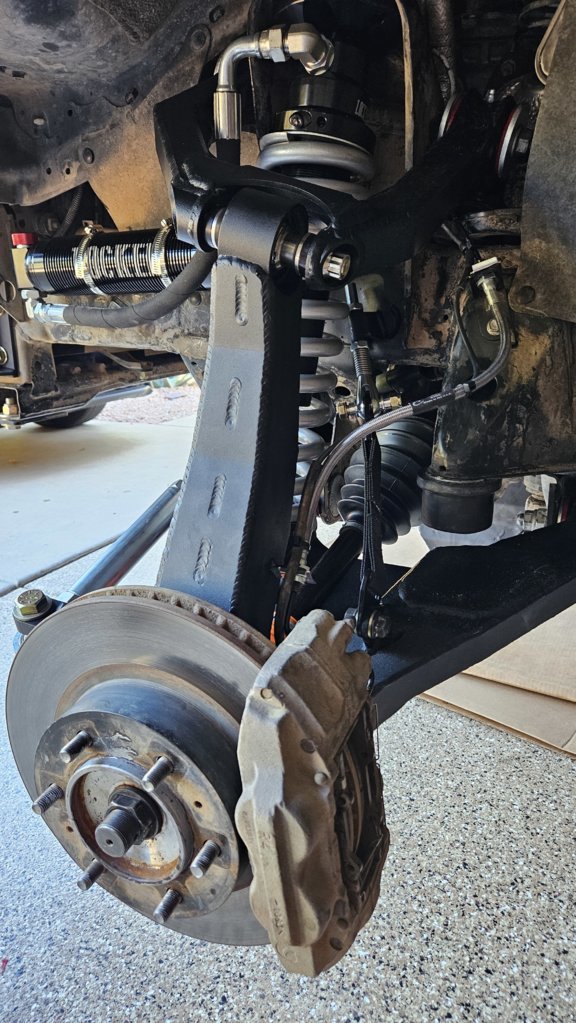

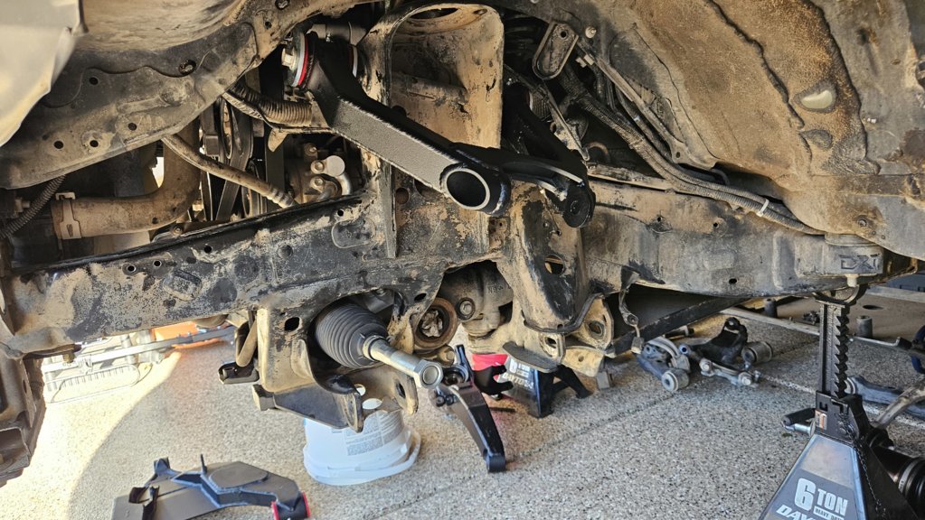

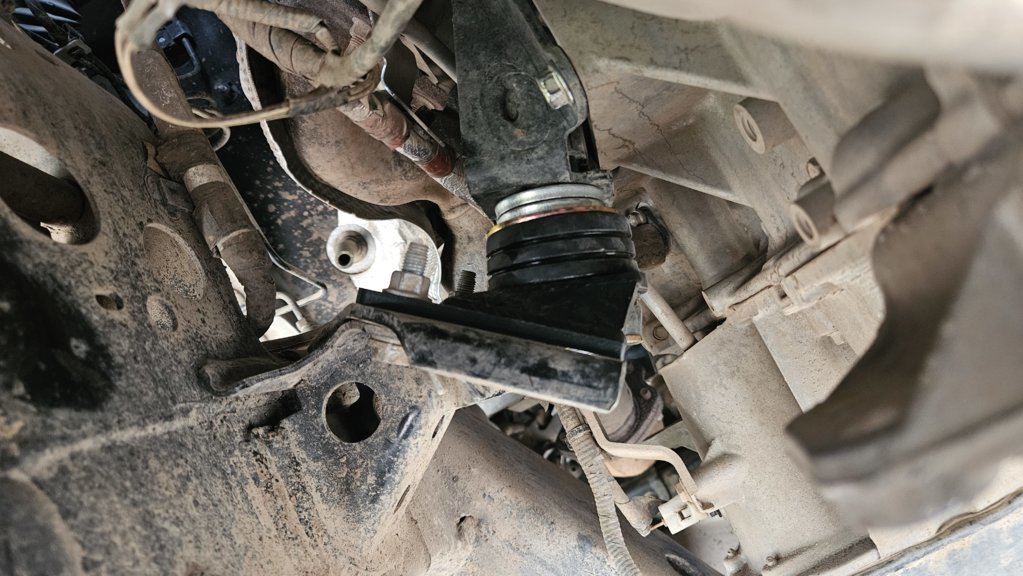

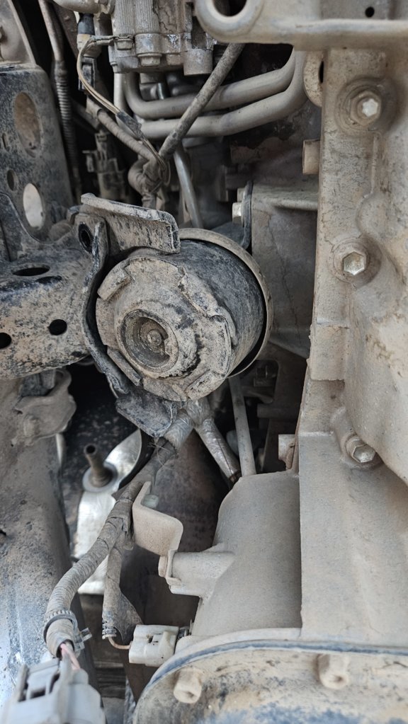

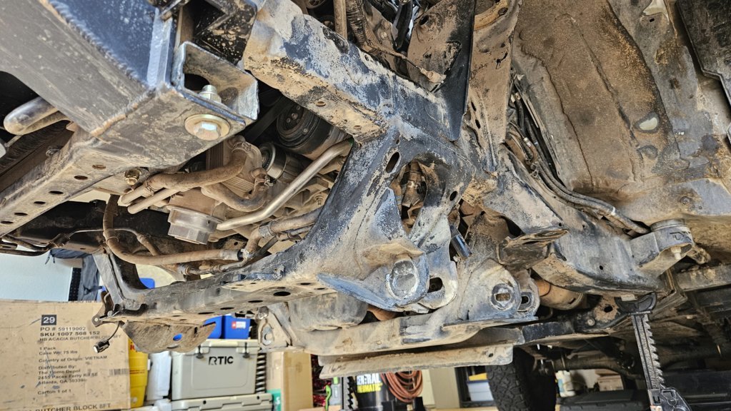

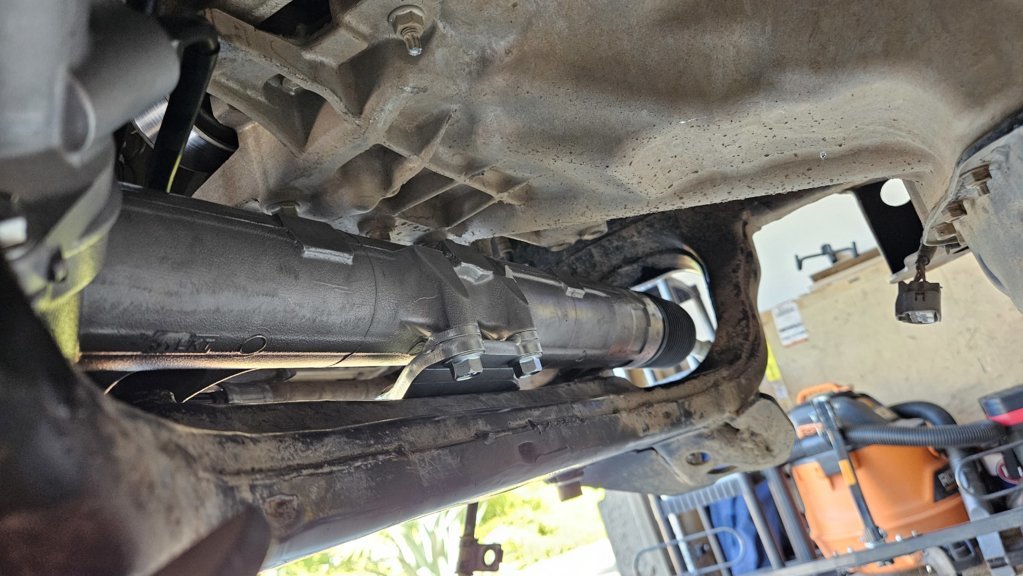

    Made some progress installing the front suspension.
    Last weekend I got everything pulled apart. Front Suspension off, diff out, and steering rack removed. Every thing has a nice dirt coat from all the fluid film sprayed on the frame..

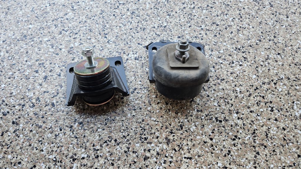

    Next up was to install the Martec poly motor mounts I bought a long time ago. With everything out they were easy to get to.
    Comparison of stock and enging mounts from Martec(left)
    Added some spacers to raise the engine. Will make it a little easier to get the large LC200 steering rack in.

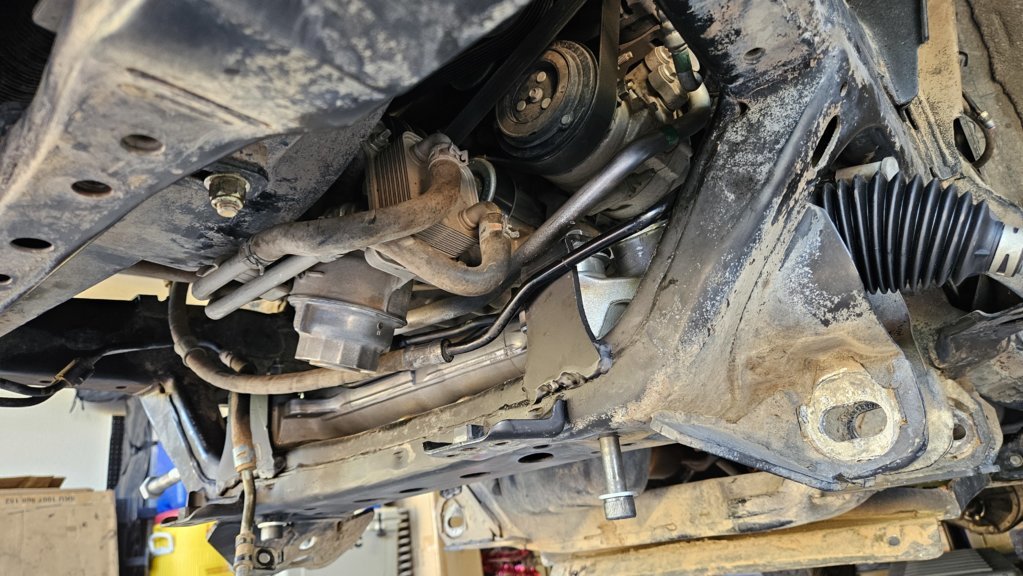

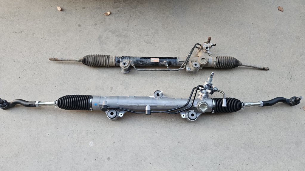

    Lots of work went into fitting the LC200 steering rack. I didn't take picture of the process of getting it in, but it was not fun. Cutting, drilling, welding, and cussing involved.
    Stock rack vs the LC200 rack. The size difference is laughable.
    Installed with the 3rd mout
    Double shear mounts welded in.
    Upper control arms in.

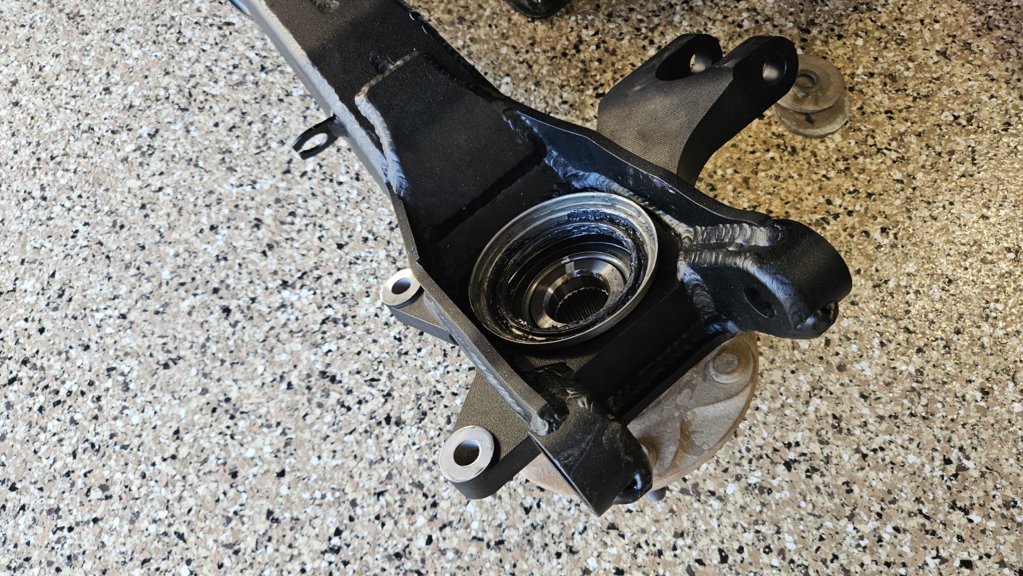

    Spindles and seals installed in steering knuckles.
    Lots of work left, and my body hurts. These kind of project remind me that I'm not 20 lol.

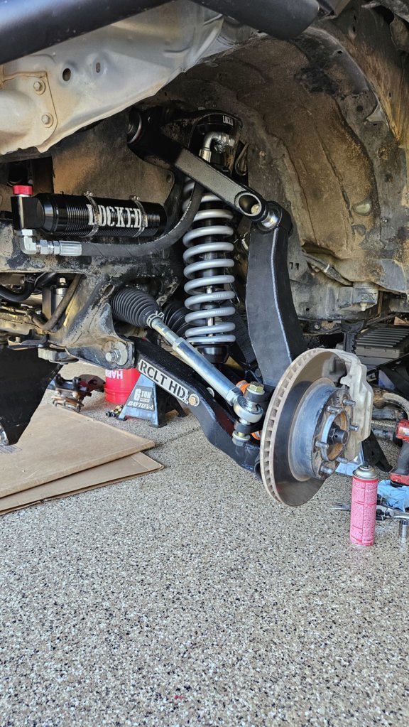

    Finally getting somewhere with this project. One side pretty much done!
    Lots of procedure lessons learned. Next side should go faster....

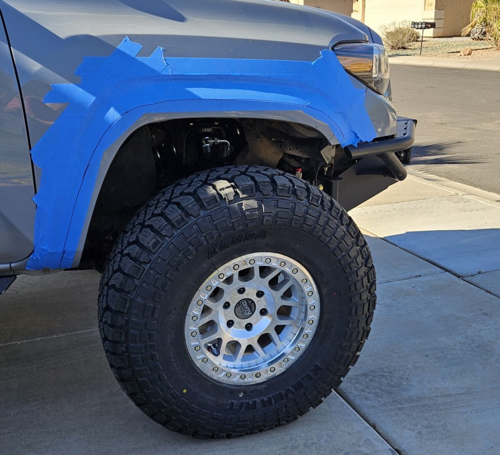

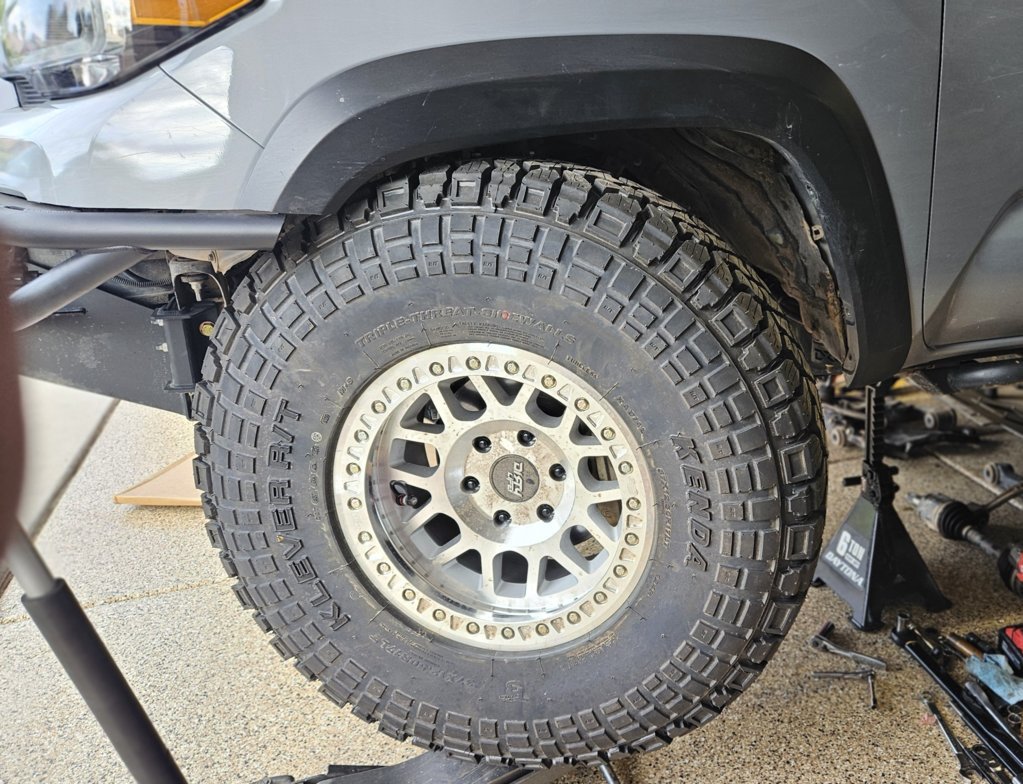

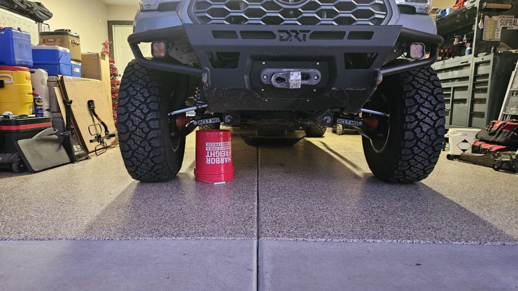

    Off the jack stands and front ride height set.
    Loads of clearence gained (HF 5 gallon bucket for scale)
    Next is to cut fenders and allignment.
