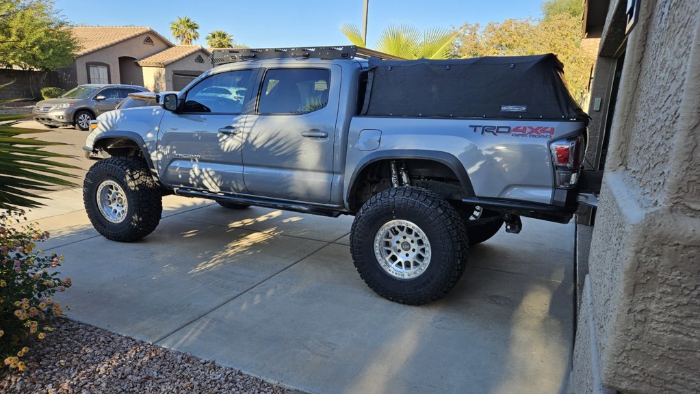

    Oh there will be some mods all right
    :muscleflexing:

    Looks good!!!

    Small lift, slightly oversized tires, well...
    Geezus!
    It don't matter how big the tires, them shady-assed trees will still box you in!

    I can't shake that shame even moving to a different state :anonymous:

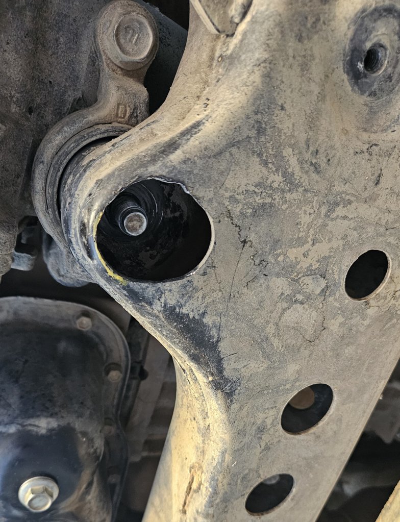

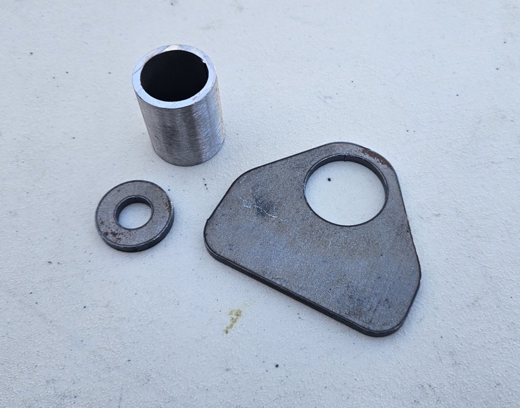

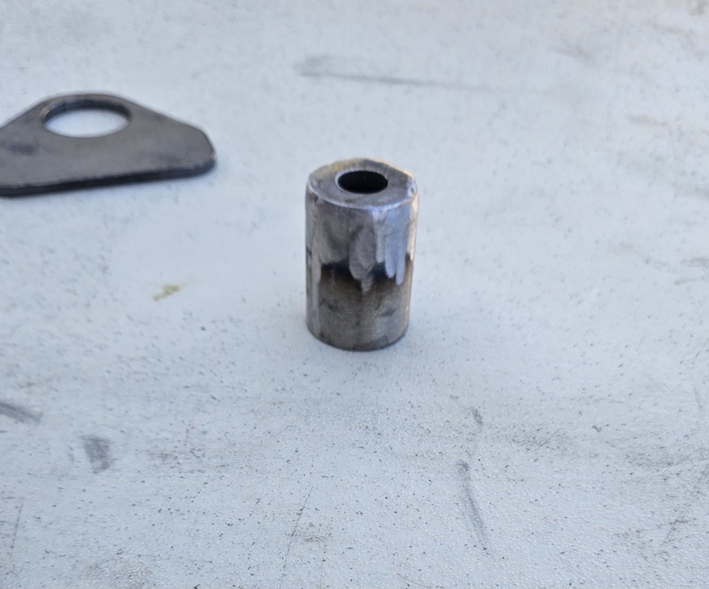

    Today added a front Differential reinforcement plate. IG user Welds_Taco makes these an I thought it would be a good idea to shore up the rear mount of the front diff. The frame is thin and I have seen some instances of the nut getting pulled through. Specially with larger tires, lockers, and gearing. I'd rather that not happen so here we are.....
    Here is what you get in the kit
    First thing is to weld the washer onto the tube.
    Then you have to clearence the hole in the frame for the tube to fit. I used a burr bit in a die grinder.

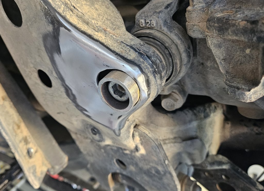

    Then clean the weld area and mount the tube with the diff nut

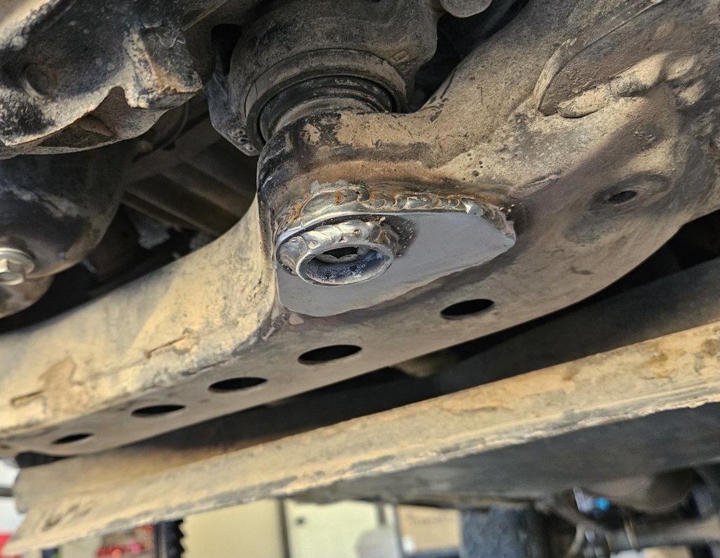

    Weld the plate to the frame. Then the tube to the plate

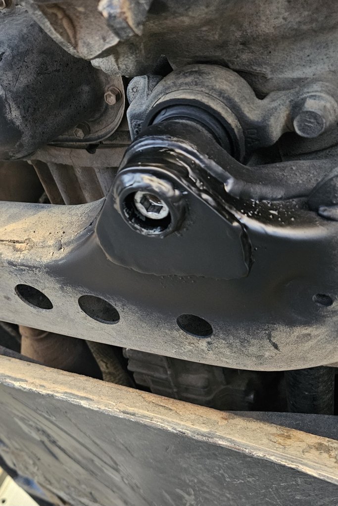

    Paint and torque the diff nut to factory specs.
