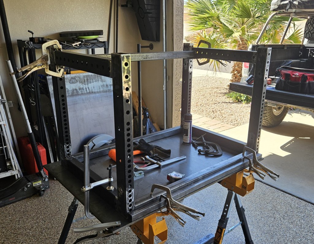

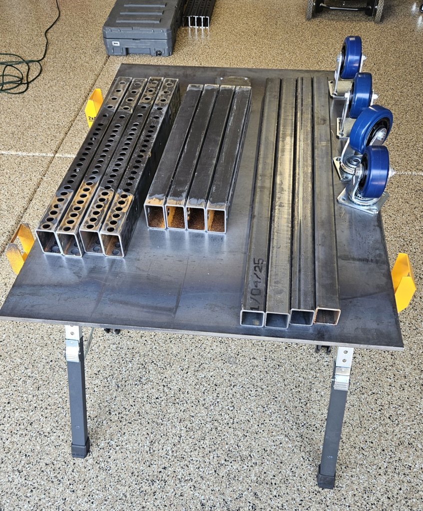

    Finally getting around to getting my welding table/workbench put together.
    Got all the material cut to size and cleaned up. Some of the frame is from my old squat rack. Thought the 7/8" holes in the tubing might come in handy.
    The top plate is 34"x48"x1/2" and is working good for getting the frame together.
    Table base tacked up and ready to finish weld.
    I'm going to wait to weld on the caster wheel mounting plates. That way I can account for any warpage. Don't want the it to rock like a cheap bar table on the floor. Also have a 14ga sheet to make a bottom shelf.

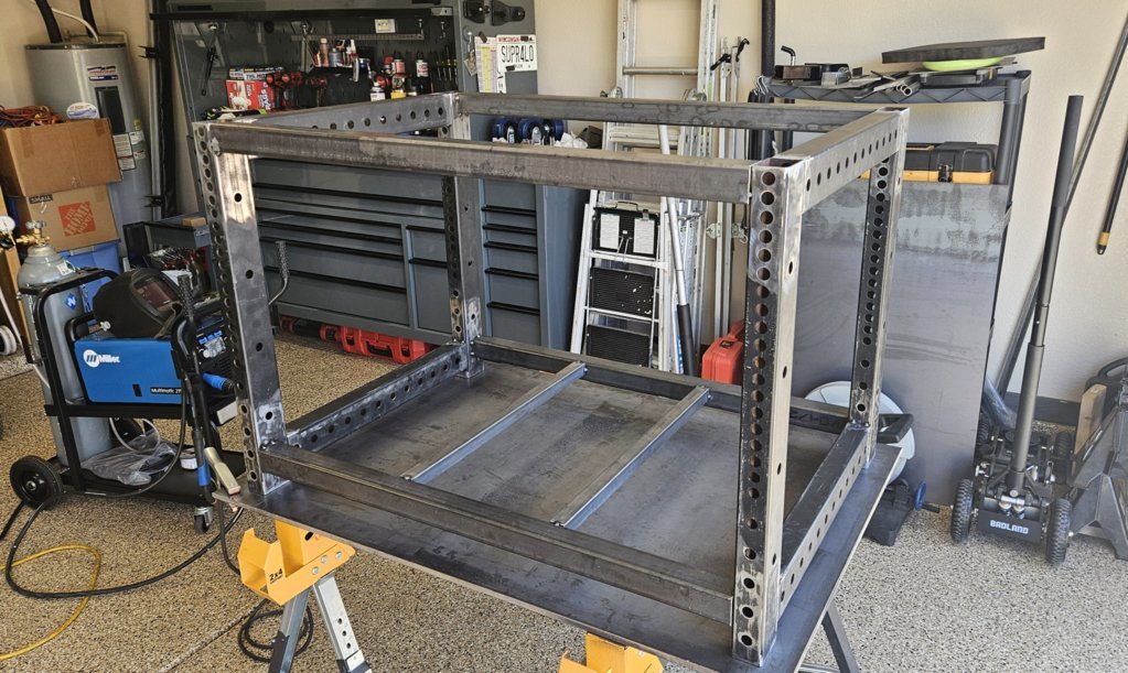

    Frame welded up, Top and wheels on. Just need to finish the bottom shelf. Floor to top is 37".

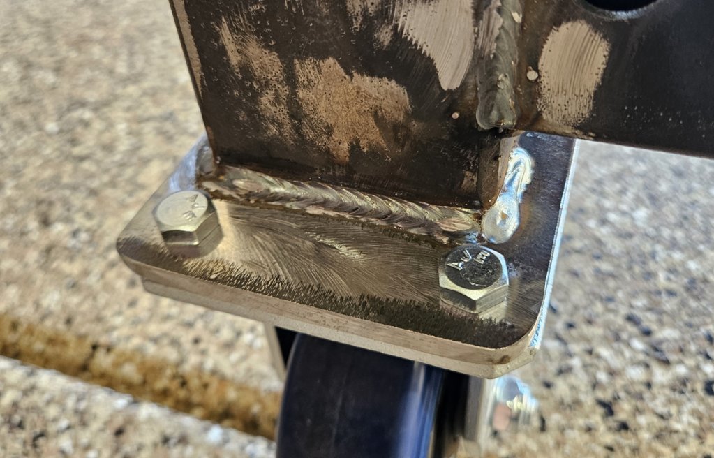

    Because everyone like a bead pic. I'm a little rusty haven't been welding much the last few years.

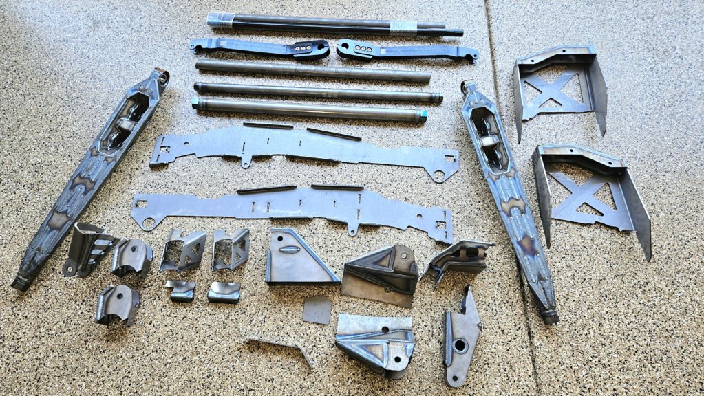

    Martec rear 3 link kit is here! As well as a TK1 rear sway bar. Now I have to get the ADS coil over and bypass shocks ordered.
    This stuff is pure beef!!

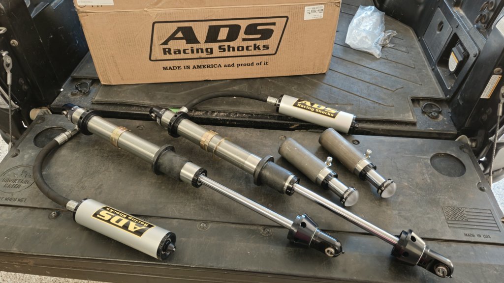

    Thanks to Nick @ Desert Off Road Solutions and ADS the Bumps and Coilovers showed up quick fast and in a hurry. Ordered on Wednesday and was on the door step the next day! Bypass shocks are still a few weeks out though.

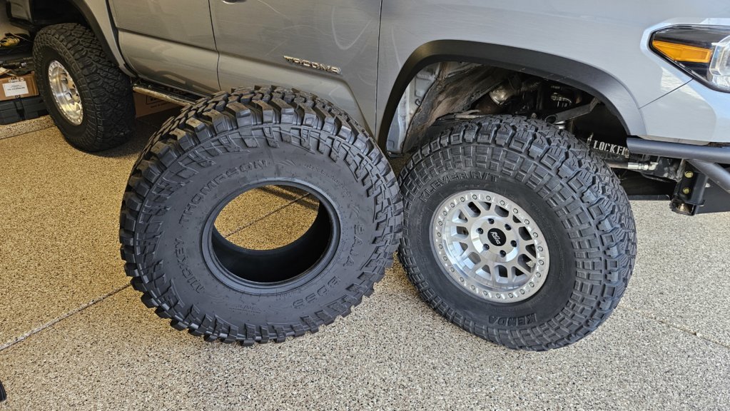

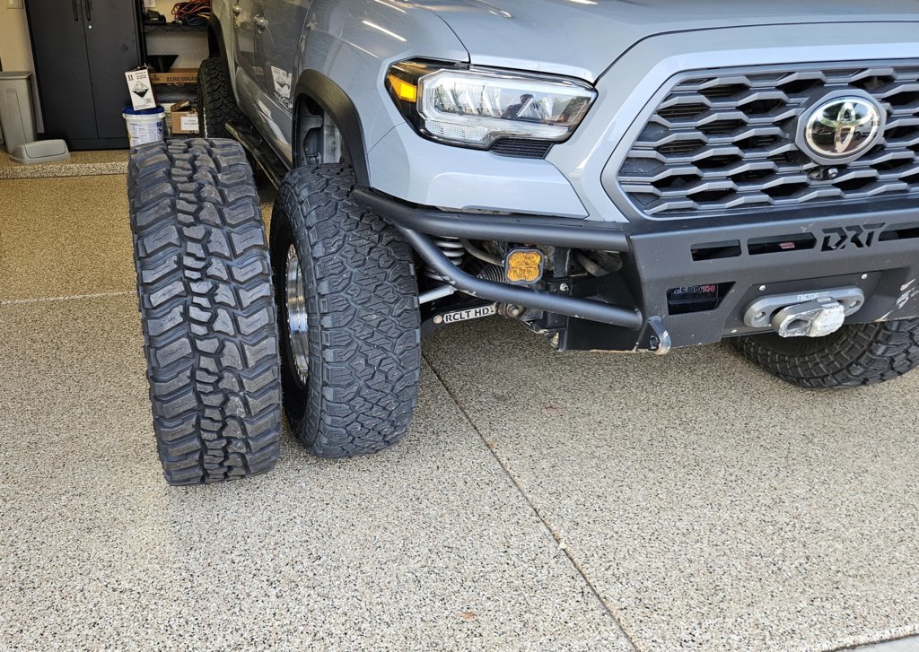

    I unexpectedly adopted a tire last night. It was on FB marketplace looking so lonely and needing a home while Sarah McLachlan sang softly in the background. Mickey Tompson Baha Boss MT 40x13.5xR17. Just 1 for now so I can start doing the cutting to fit. Let's gooooo!
    It's actually surprising how big the jump from 37 to 40 is. The 37 looks like a 33 next to it....

    Why Baja Boss MT.
    MT = Mud Terrain :D
    I thought your truck was allergic to mud.:D
    I know a guy that might want your 37's
