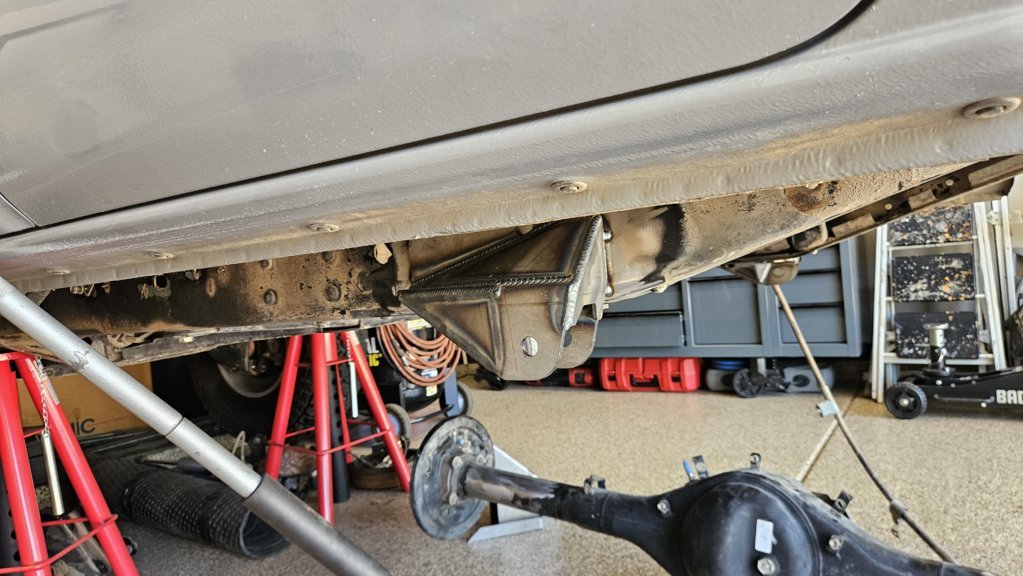

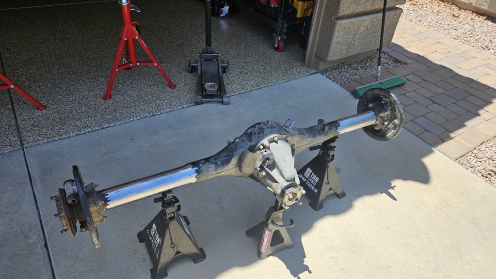

  7. Jun 21, 2025 at 11:50 AM
    #147
    Supr4Lo
    Supr4Lo [OP] Well-Known Member
    Jul 23, 2018
    #260306
    3,697
    Jason
    Surprise, AZ
    2020 DCSB Offroad MT, Supercharged, NWF Eco-Crawler, 4.88's Locked F&R on 37's
    Project 3 link is under way.
    Got the bed off and truck up on stands.
    Most of the morning was screwing around with making clearance for the garage door. It is tight I had to remove some of the cross bars from the roof rack and trim off the door opener bracket. But it fits!!
    Tomorrow morning I'll start pecking away at some disassembly.
    Yacob_D, RDT415, sparkystaco and 4 others like this.

  10. Jun 21, 2025 at 1:02 PM
    #150
    Road_Warrior
    Road_Warrior There is nothing on my horizon except everything
    Aug 22, 2021
    #374919
    8,061
    East Coast
    2021 Black SR5 4x4
    Can’t wait to see what the truck looks with 3 more mounted!
    For what it’s worth…Toyo is discontinuing the RT soon.
    Supr4Lo[QUOTED][OP] likes this.
  11. Jun 21, 2025 at 1:16 PM
    #151
    Supr4Lo
    Jul 23, 2018
    #260306
    3,697
    Jason
    Surprise, AZ
    The two 10 ton stands in the front were almost too tall. I was worried at first lol. It was a small investment for all the new stands but i wanted space under to work comfortably. I like the pipe stands in the rear since they can be screwed up/down for fine adjustment. Worked good to level everything out.

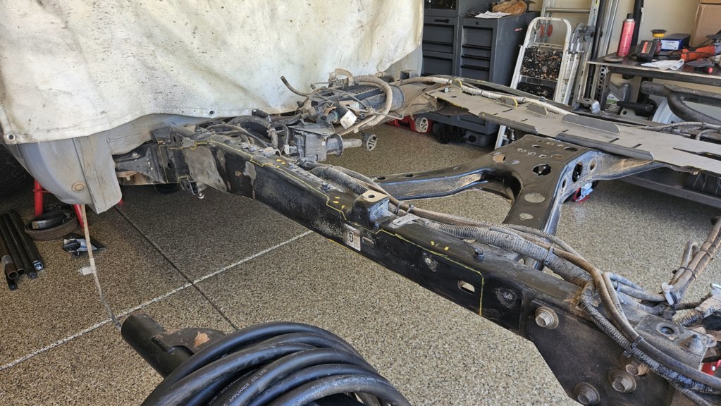

  17. Jun 22, 2025 at 10:25 AM
    #157
    Supr4Lo
    Jul 23, 2018
    #260306
    3,697
    Jason
    Surprise, AZ
    Everything is out! Next weekend I can start cutting the brackets off and getting the frame ready.
    time623, TacoBran, Yacob_D and 4 others like this.

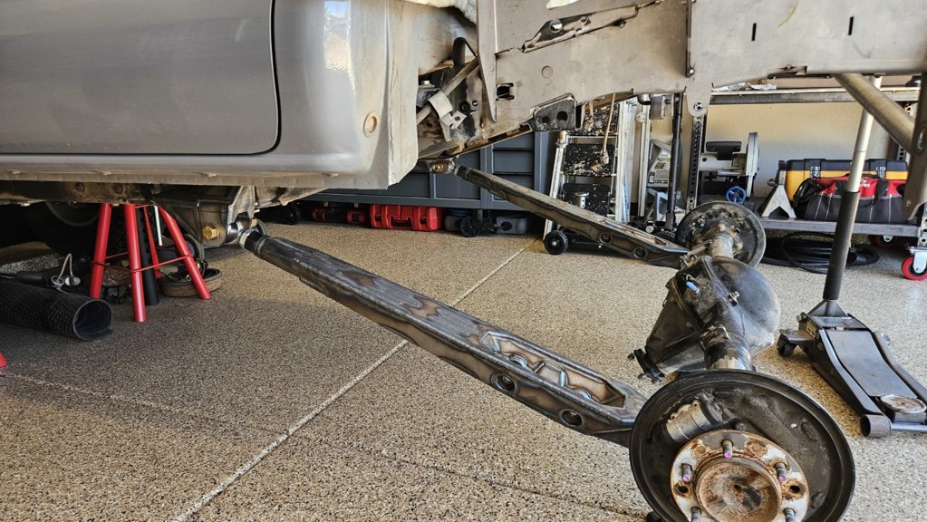

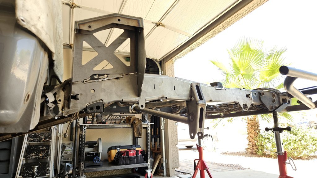

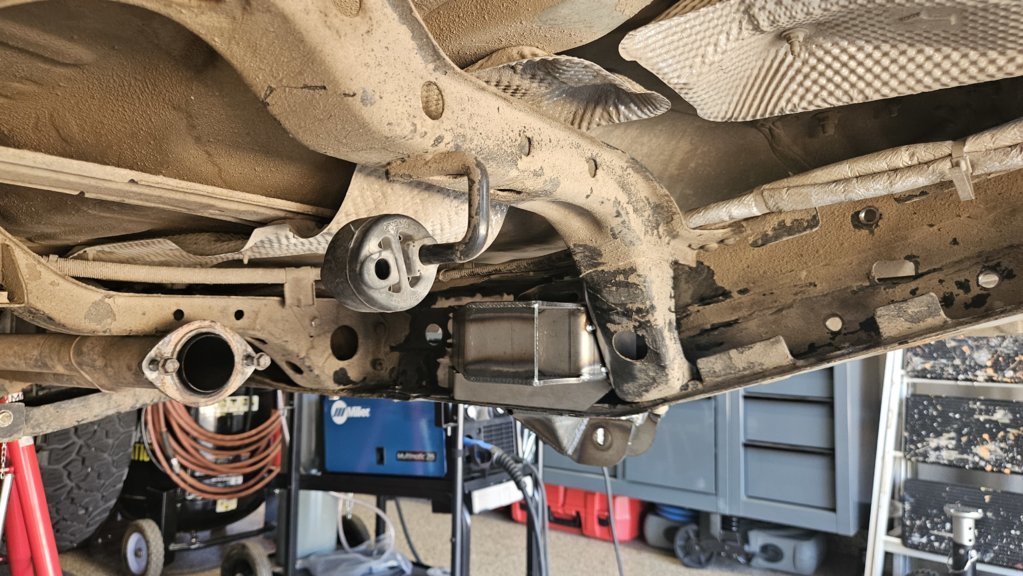

  18. Jul 6, 2025 at 5:32 PM
    #158
    Supr4Lo
    Jul 23, 2018
    #260306
    3,697
    Jason
    Surprise, AZ

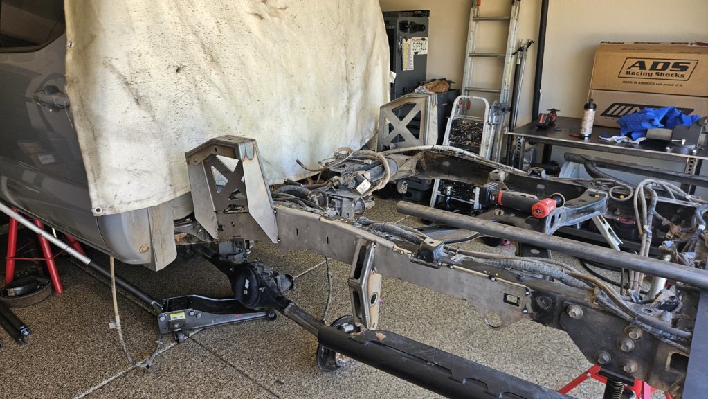

    Project 3 link update
    Got all the stock brackets that need to be removed cut off. Which was not a fun project!
    After everything was stripped off I got the frame plates, shock towers, panhard bar mount, frame lower / upper link mounts and axle lower link mounts tacked on.
    Lots left to do! Gets too damm hot to get much done in a day.
    TacoBran, Operator8, TACOTU3 and 5 others like this.
  19. Jul 6, 2025 at 6:17 PM
    #159
    time623
    time623 Well-Known Member
    Jun 26, 2015
    #158230
    3,807
    James
    AZ
    1995.5 White Tacoma 4x4
    Lookin good!
    If you don’t have one already, a portable swamp cooler is the only way I get anything done in the garage all summer. Worth every penny
  20. Jul 6, 2025 at 7:22 PM
    #160
    Supr4Lo
    Jul 23, 2018
    #260306
    3,697
    Jason
    Surprise, AZ
    I was looking at a swamp cooler at Home Depot but just another thing I dont have room for in the garage.
