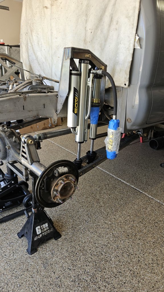

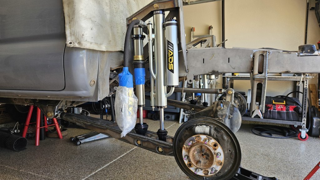

    Got the shocks in :notsure:
    Just to find a few issues I'm working through. Need shorter rod ends on the bypass shocks to get full bump. Also one of the upper link Heim joints threaded in but won't come out. I suspect that there was a burr in the threads. The threaded bung needs to be cut out and a new one welded in. So in holding pattern for parts.

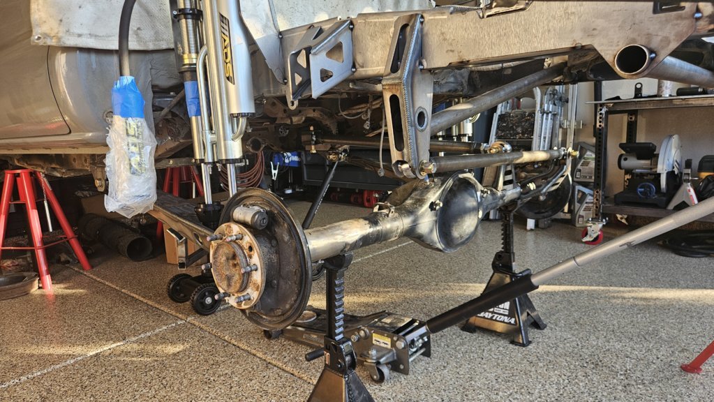

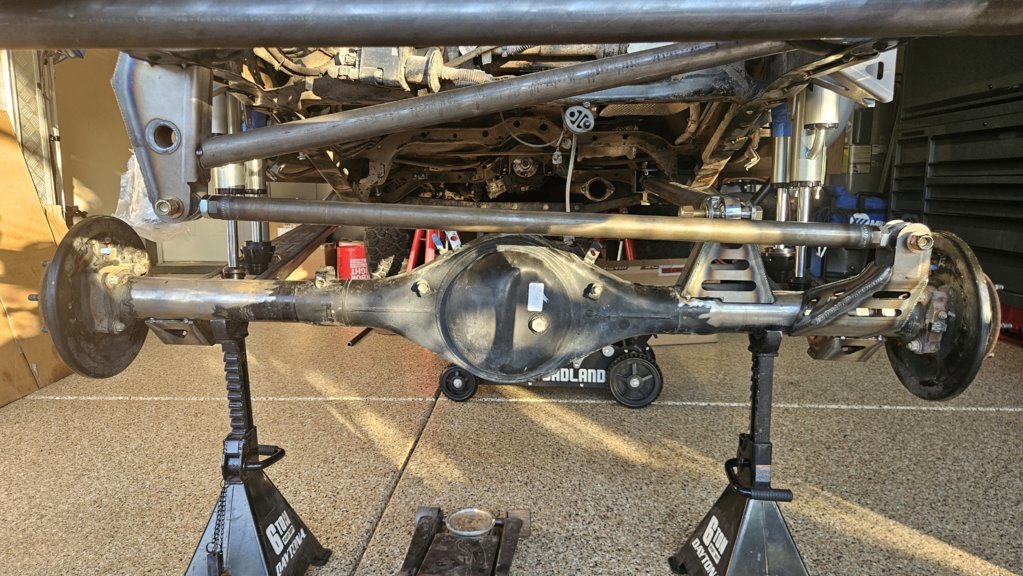

    Got a few things done last night. The shorter shock rod ends were delivered so I got those installed. Frame side bump stop mounts tacked on. And panhard bar axle bracked tacked on.

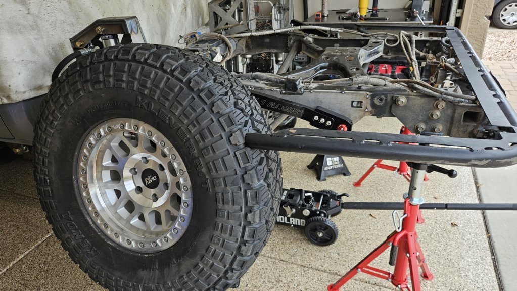

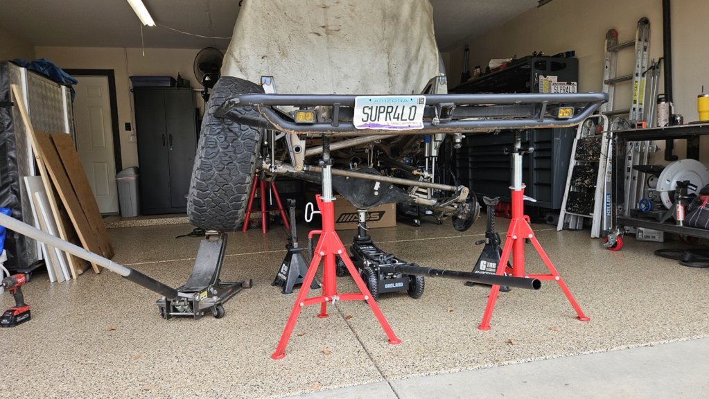

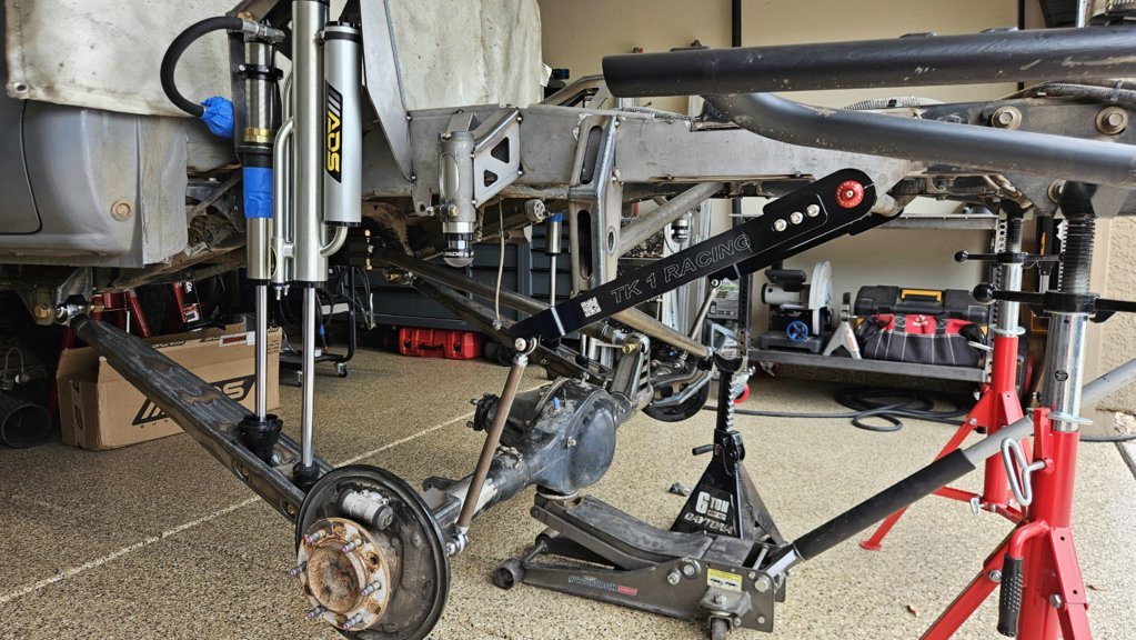

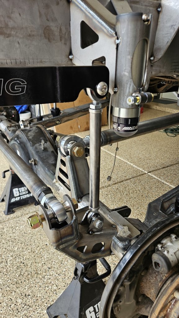

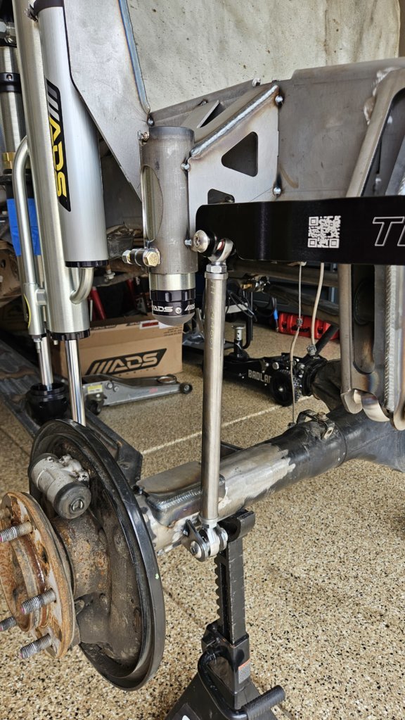

    Few things accomplished today.
    That was the last of the brackets that need to get mounted so it was time to cycle the suspension.
    Found out I'm going to have to cut the bumper back. The tire hits on full stuff.
    Things left to do. Burn in everything, modify rear bumper and sliders. Fab up new exhaust.

    can you explain to the class why you have a swaybar on the rear for all the 'swaybars are bad for off-road folks'? then ill link to this every time someone mentions you have to remove them for off-road lol
    sparkystaco and bkhlrTaco's like this.
  13. Jul 21, 2025 at 2:22 PM
    #173
    Supr4Lo
    Supr4Lo [OP] Well-Known Member
    Jul 23, 2018
    #260306
    3,697
    Jason
    Surprise, AZ
    2020 DCSB Offroad MT, Supercharged, NWF Eco-Crawler, 4.88's Locked F&R on 37's
    Because Trophy trucks run them...
    Short answer
    Helps even out the spring Bias since the front has 600 lb and the rear will be a dual spring 250 over 250. So as the body rolls the sway bar helps add extra spring rate to the rear corners. This helps make the front suspension put in more work and even out the chassis.
    The sway bar isn't heavy enough to keep the rear from fully flexing.
