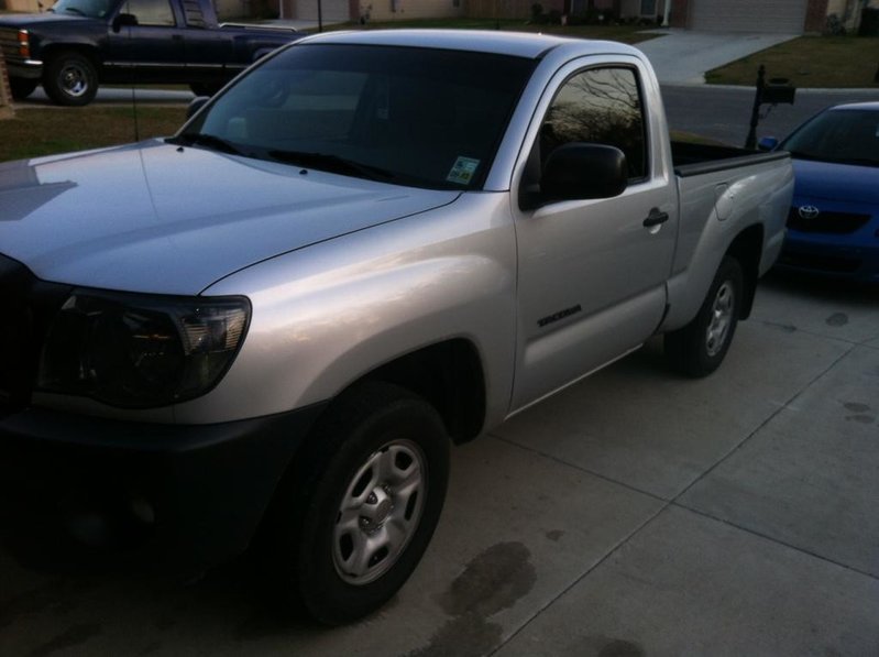

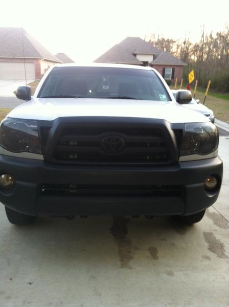

    Sorry for the crappy pics, but this was about 6 months ago taken with my iphone.
