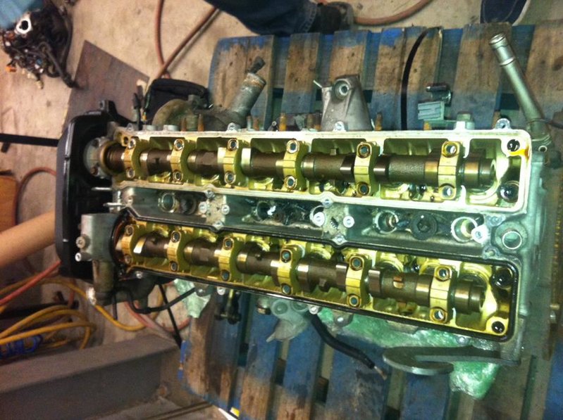

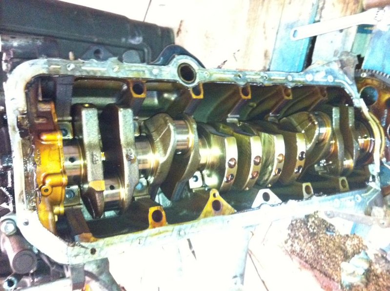

  8. Feb 9, 2013 at 12:40 AM
    #88
    LsuMeDesigner
    LsuMeDesigner [OP] Well-Known Member
    Oct 22, 2012
    #89509
    84
    Okay...where do I start...hmmm
    Well fully forged internals are on the way along with bearings and arp hardware.
    I tore down the engine tonight...was not very happy. One spark plug had what they call "chocolate milk"....didn't have the correct size torque bit so I couldn't pull the head. So I went ahead and removed the bottom end rotating assembly.
    The motor was pretty clean and no scarring on bearings. Also after removing valve covers the cams and top end was very clean.

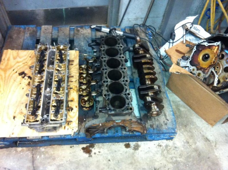

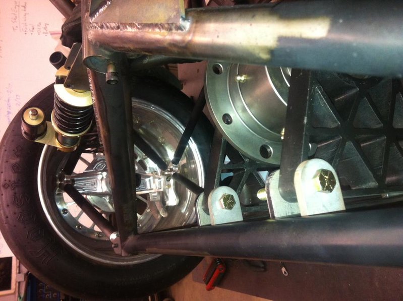

  9. Feb 9, 2013 at 1:05 AM
    #89
    LsuMeDesigner
    Oct 22, 2012
    #89509
    84
    some pics of engine and open wheel car

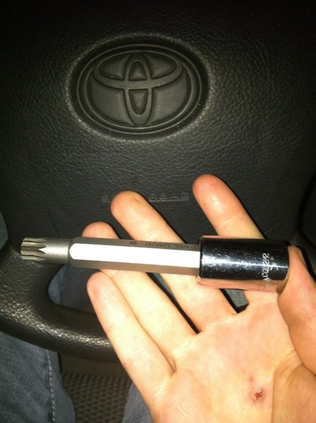

  11. Feb 9, 2013 at 6:46 PM
    #91
    LsuMeDesigner
    Oct 22, 2012
    #89509
    84
    Got really aggervated today when I had to go buy a T-35 torx bit to take off the bolts for the cam seals. That thing is really hard to find!!!
    Then the head uses 10mm bi-hex socket head bolts.
    Of course I didn't have one!!
    But motor is completely disassembled besides the head being mounted to the block.

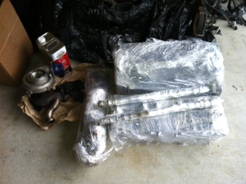

  13. Feb 12, 2013 at 3:13 PM
    #93
    LsuMeDesigner
    Oct 22, 2012
    #89509
    84
    Alright scratch that last post....
    I need this motor built ASAP and don't feel like searching for used GTE pistons and Rods.
    Ordered new parts from Titan Motorsports. Brian Crower had already shipped my other parts. As soon as they are all here the bottom end is being sent off.
    I also got some free parts for helping out a guy with some fab work. Lol
    He gave me a 35mm precision wastegate. And a 50mm BOV from rps.
    Not ideal for what I wanted but hey they were free.
    I'll take some pics soon.

  16. Feb 13, 2013 at 3:03 PM
    #96
    LsuMeDesigner
    Oct 22, 2012
    #89509
    84
    This is the tool you will need to take the head off of a 2JZ....just for the record!

  18. Feb 13, 2013 at 5:14 PM
    #98
    Torspd
    Torspd Tor-nication
    Sep 18, 2009
    #22958
    26,439
    Tor
    The Great America!
    MMVI 4.4L 4x4 Access Cab
    Torspd Custom Turbo kit [] Borg Warner 9180EFR Turbo [] Haltech Elite 2500 [] TiAL Q BOV [] TiAL V44 Wastegate @ 15psi [] CP Pistons [] CP Carrillo Rods [] ARP Head studs [] ARP Main Studs [] ARP Header - Head Studs [] Ported Heads w/ 1mm oversized valves intake/exhaust [] Brian Crower Forged Stroker Crank [] Darton M.I.D. Sleeved Block [] Kelford Camshafts [] Torspd 160* T-stat mod [] APR Large Fuel Rail [] Walbro 460 LPH E85 Fuel Pump [] FueLab FPR [] APR T56 Conversion Kit [] KP RACING Built T56 [] McLeod Racing Custom Twin Disk Clutch [] One Piece Aluminum Driveshaft [] MGW Shifter [] Custom lowering kit [] Ohlins Front Coilovers [] QA1rear shocks [] Custom Ron Davis Radiator [] Dual SPAL Electric Fans []
    Haha. I gave one of my JE pistons to a friend to make an ash tray out of it as well. All scored from piston slap. Works well though. :)
    Been busy I see. That is some good work completed there.
    What all are you planning on doing to the heads and block now?
  19. Feb 13, 2013 at 7:21 PM
    #99
    LsuMeDesigner
    Oct 22, 2012
    #89509
    84
    Ha yeah I was using a piston from a 450cc ATV but we had to dump it alot, so we upgraded lol.
    The block is going to an engine builder in Orange Texas. He build my buddy's turbo 6.0 GMC. It put down 850hp so I trust the guy.
    He's going to clean up some coolant jackets, line bore the cylinders, polish and rebalance crank. Then going to do full short block assembly, ACL rod main and thrust bearings, JE 8.5 pistons, eagle rods, and all arp hardware.
    The head is going to be getting cleaned up and a small hand port job here locally. I'm deleting the VVTi and running stock GTE cam and cam gear.
    Not doing much to the head because I plan to go all out on the head down the road.
