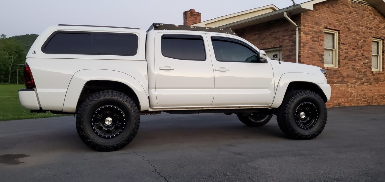

    3" Supreme front spacer 60k miles later no issues at all now on 35's too with stock UCA. I did go with Toytec AAL in rear though as I have had blocks crack in the past.
    SoonerAndrew[OP] likes this.

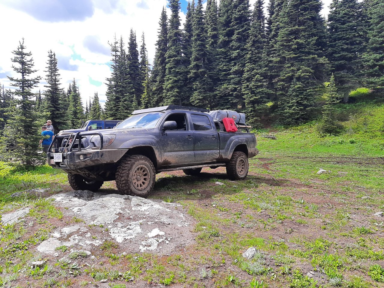

    I had a space lift on for like a month took it out so fast rode terrible. Now I have ome bp51s in the front ome heavy leafs in the rear and fox 2.0 rr shocks rides so much better.
