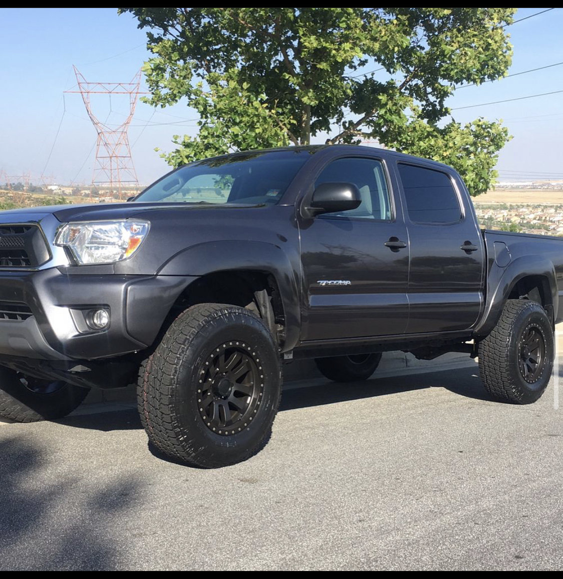

    Same truck, I put the supreme 3.5 inch spacers on the front but then had to add a leaf in the back to level it. Love the look, tires look a little small now and ride is a little more stiff but not too noticeable
