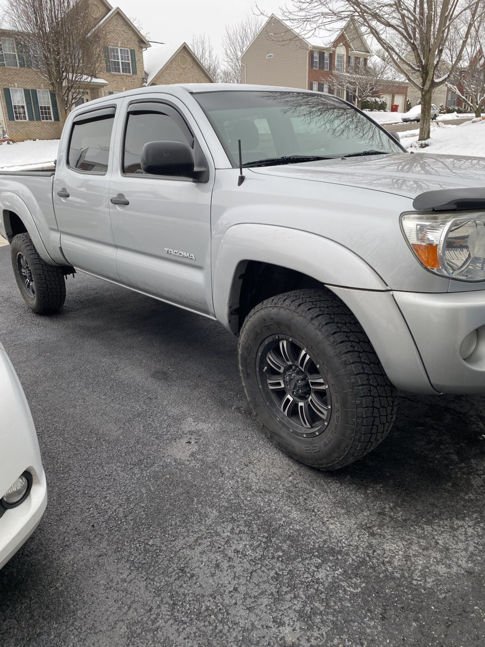

    New to the forum. I just installed the 3/2 lift from supreme suspension. Installed new coil overs in the front as well. The left did not level the truck. The rear is still higher than the front. Has anyone else had this issue.

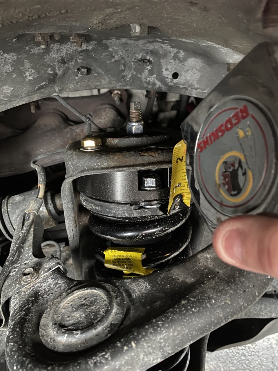

    This is what was installed on the front.

    The coilovers where given to me from my brother who got them new for his Tacoma but sold the truck before he had them installed. They are a Monroe shock

    From the from the ground to bottom of the fender measures 36 1/2. The rear measures 38 1/2

    Then those have to be the wrong coilover assemblies. They were Monroe and they came completely assembled correct?

    Yes. The Monroe came Assembled

    Yep. Betting they’re wrong. The front should measure between 38 1/2 to 39 1/2 depending what your starting point was. I have a set of 3” toytec coilovers in the front and I measure 39”.

    Damnit. Lol. I looked them up online and they say OE for the Tacoma.

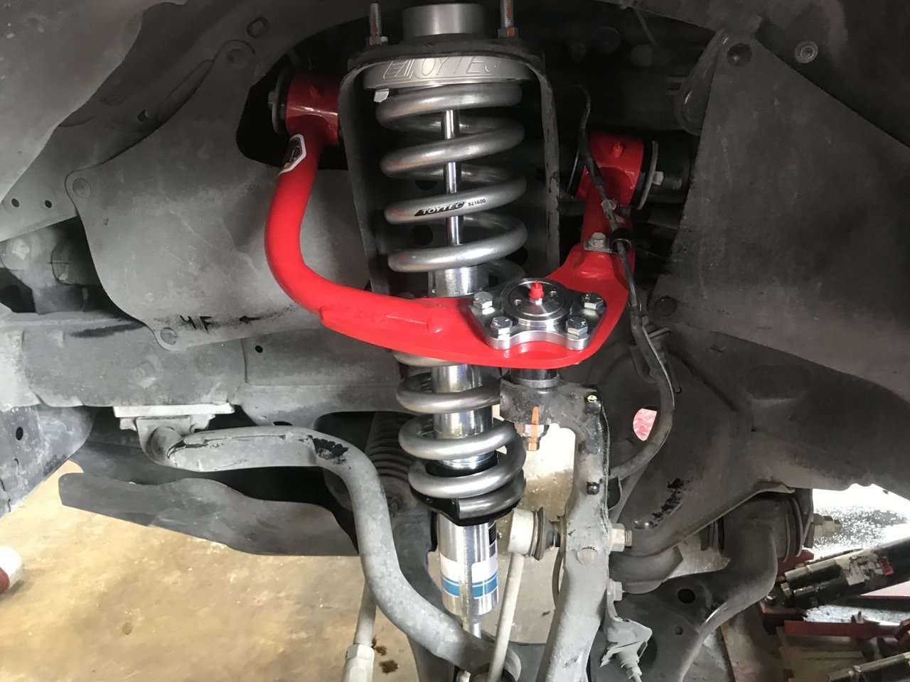

    These are the Toytec I have. I really like them. 709EFDDB-05C7-4973-955D-0825500C55F5.jpg

    Can you install them and leave everything else stock ? Like the control arms
  20. Feb 12, 2021 at 3:55 PM
    #40
    gotoman1969
    gotoman1969 Well-Known Member
    May 30, 2018
    #254966
    7,009
    Steve
    San Antonio, TX United States
    2015 Silver Tacoma PreRunner
    3" ToyTec coilovers, JBA UCA's, Bilstein 5100's
    When it comes to needing UCAs. Every truck is different. When you go above 2-2.5” of lift sometimes you just can’t get the alignment into spec and rubbing the cab mount is an issue. If that’s the case you’ll need ucas. Plus some of like custom alignment specs. Ie I run 4 * of caster that is not attainable with oe ucas.
