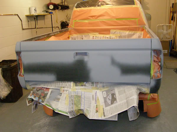

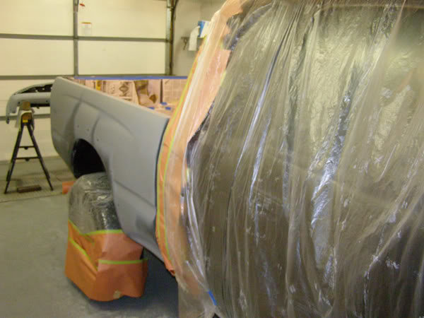

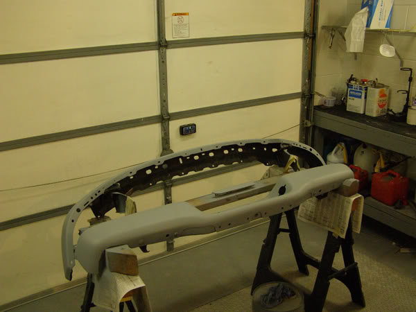

  7. Nov 20, 2011 at 7:57 AM
    twfsa
    twfsa Well-Known Member
    May 29, 2010
    #37997
    1,342
    Tom
    Omaha Ne
    04 TRD 4X4
    881 Front coils, Bilstien 5100's all the way front set to "0" Icon Dynamic's mini leafs in rear, stock tires.
    DuPont Chroma Base mixed 1:1 2 qts base>2qts reducer= 1 gal enough to do a complete on a Xtra cab if your not useing a Harbor Freight gun.Did the outside of the box and tailgate, both bumpers on mine with less than a qt.
