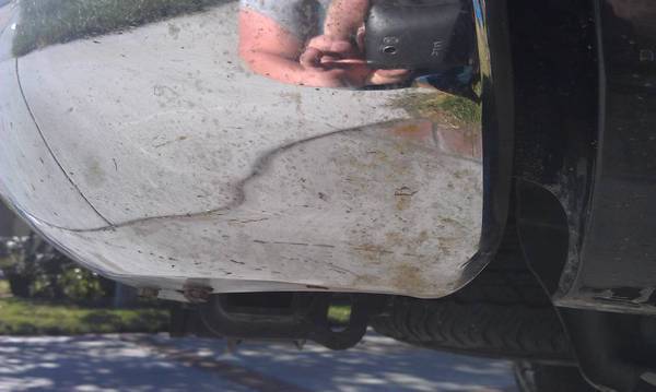

    i just noticed some surface rust appearing on the corner of my rear bumper, right by the tail pipe. the rest of the bumper is in great condition, even the back side is rust free. whats the best way to treat this and prevent it?? :confused::confused::confused:

    It just happens from water. Use chrome polish, it will not only shine it up nice but remove that crap you see. I had a Chevy Colorado for 6 years and that stuff never failed to clean up the bumpers nice.

    ^X2, if you want to try and make it easier use a clay bar then polish it...

    Mine gets rusty from the salt on the roads during winter. I have a 2010 access cab. I think there's a recall for that but I put my trailer plug in the bumper so I don't think I can get it replaced. I used wd 40 today on it with a rag and it came right off. It only happens to me in the winter.

    For Easy chrome clean up and rust removal from an era when the more chrome the better use chrome cleaner/polish (I like the turtle wax product) and 0000 steel wool. This combination works miracles. Do not use on stainless steel or anodized aluminum.

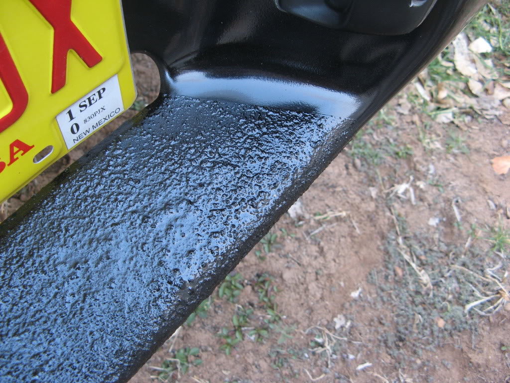

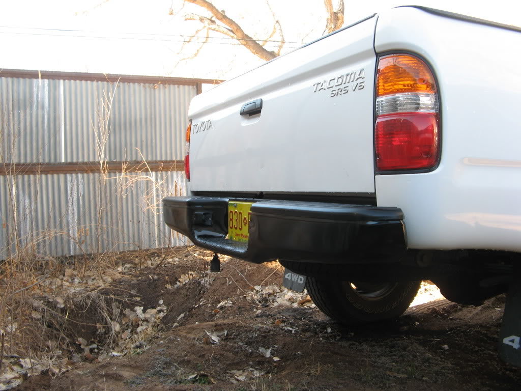

    I had the same issue on my 2010 Access Cab, would only happen in the winter when the salt was on the road. Got sick of having to contently take care of it so i fixed it with linex.
