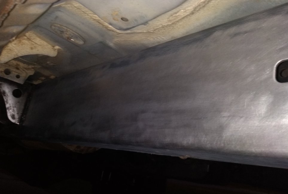

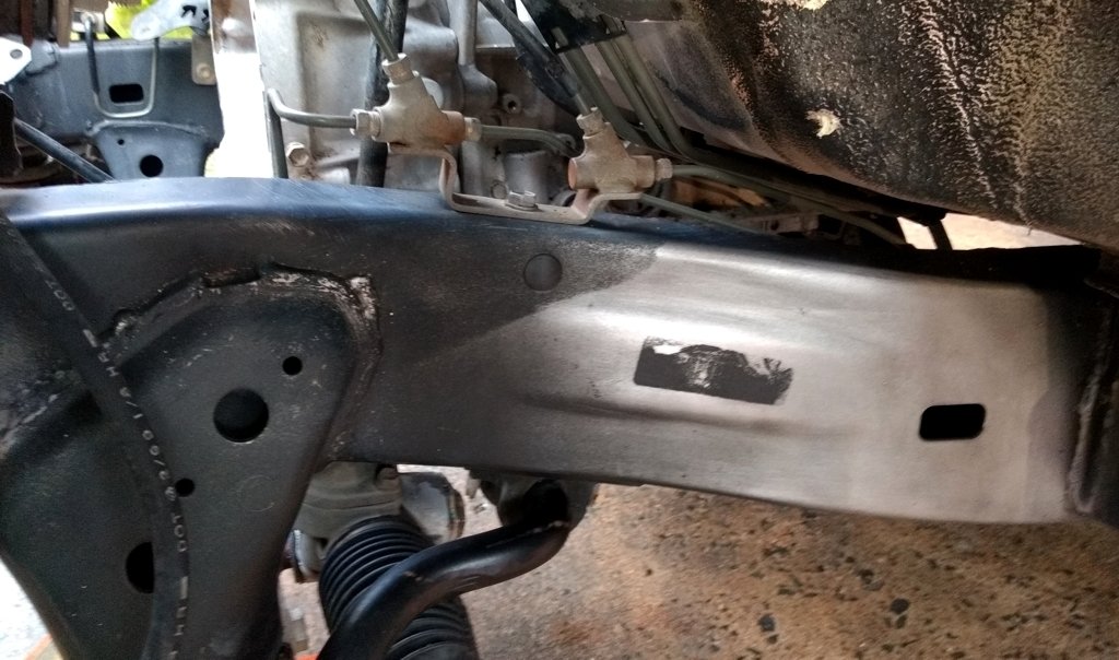

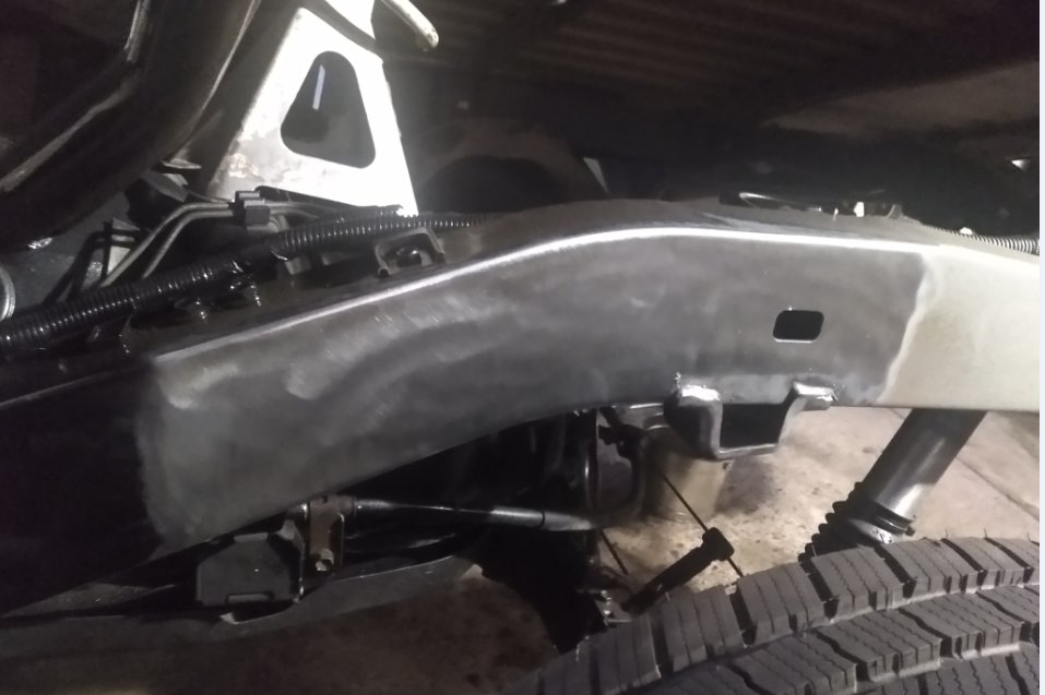

    Had a chance to start getting some work done on the surface rust. This will be a 3 or 4 step project. I'll pick this up after the engine installation is finished.
    1) Sandblasted and wire brushed the surface rust areas from the cab forward.
    2) Primed using Rustoleum self-etching primer
    3) Applied two coats of Rustoleum for Farm and Implement spray can paint that I bought at Tractor Supply.

    I stopped at the body mount behind the front wheels. It got dark and the sandblasting mask window was fogging up. Laying down on the concrete driveway and blasting the underside of a vehicle is a task that I don't like to do in the summertime. This seems to go better on a cool and crisp fall afternoon. I wanted to get the front section done while the engine is out. I've had to work around an engine while blasting parts of an engine compartment. Blasting media has a way of sticking around in cracks and crevices for years. Though I did learn a lot from that experience.

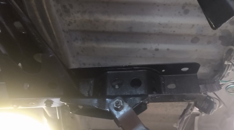

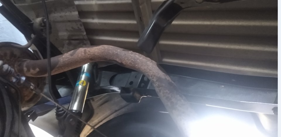

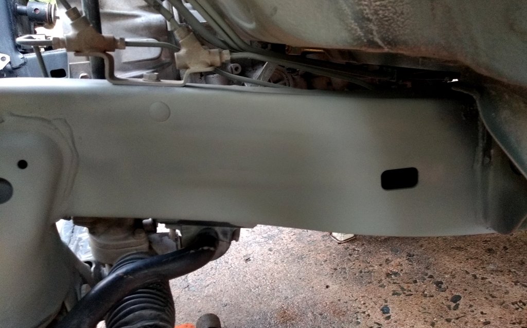

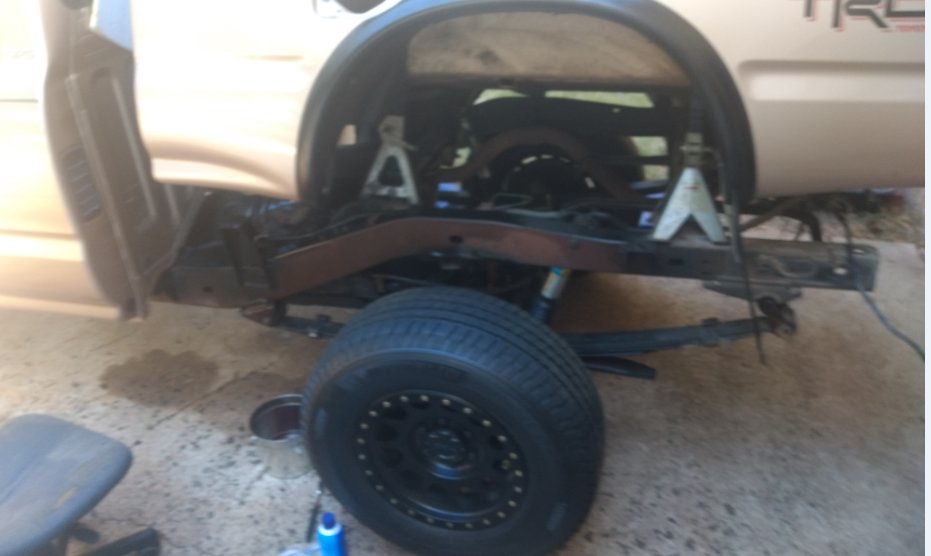

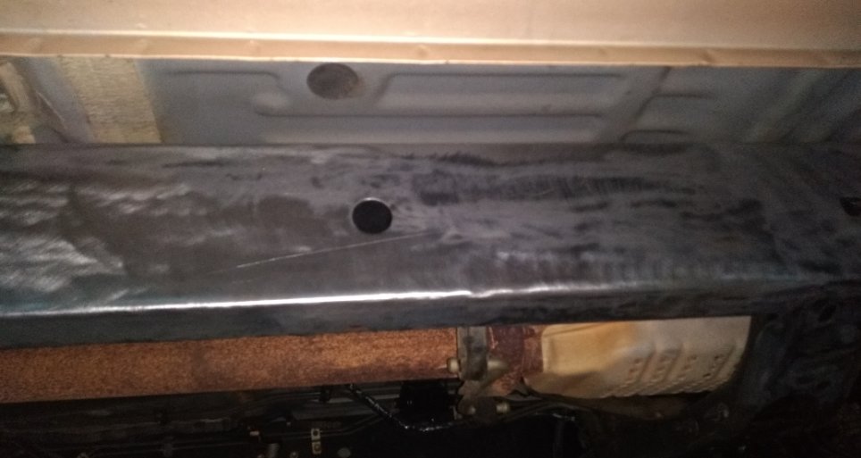

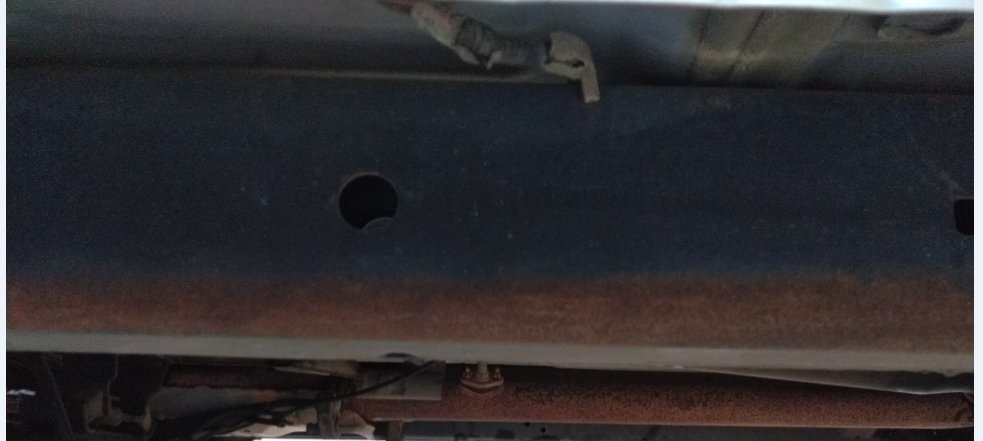

    Made today in removing surface rust from the rear driver side outer. Here's a before an after pictures. This will take a couple of weekends to finish. I'm off to a good start with the rear.
    Also, I was able to give the inner frame a good cleaning using a mix of paint thinner and automatic transmission fluid. The inner parts of the frame and spare tire mount just had some dirt and mixed with a little mud.
    Here's the outer surface rust.
    Used a wire wheel on my Milwaukee angle drill to remove the surface rust by grinding it down to the bare metal.
    Primed it with Rust Oleum Self Etching Primer.
    After cleaning with the paint thinner and automatic transmission fluid mix.
    GQ7227 likes this.

    was all the paint peeled off and gone and this is what you found underneath?
    i seem to have surface stuff but its under the stupid paint!
    CS_AR[OP] likes this.

    The paint had been worn off by gravel year ago. So there was only the surface rust in the picture from the exposed metal.
    GQ7227[QUOTED] likes this.

    The rust color area is where the paint had worn off.

    I don't think Acetone will do much to remove existing paint. I used Acetone to clean the areas before I painted. In some cases, I used Acetone to clean up the areas between the bare metal and the existing paint, then sprayed primer over it and painted. It didn't budge the old paint. In my case, most of the original paint is sticking to the metal without issue. So I've just been cleaning that part with a mix of paint thinner and ATF to remove the dirt, mud, and road grime. After I'm all done painting, then I'll give everything a fall coat of Fluid Film just to keep it preserved.
    When I did the front part of the frame, I had some overlap between old and new. The self etching primer with the Farm Implement paint seems to be working very well for that area thus far. The new paint stuck to the primer just fine.
    Note the truck won't be exposed to road salt or brine for as long as I own it. So my goal is to provide protection from gravel rash on the rare occasion when it might go down a farm/forest road out in the country.
    I think it would take some type of heavy duty paint stripper to remove the existing frame paint.

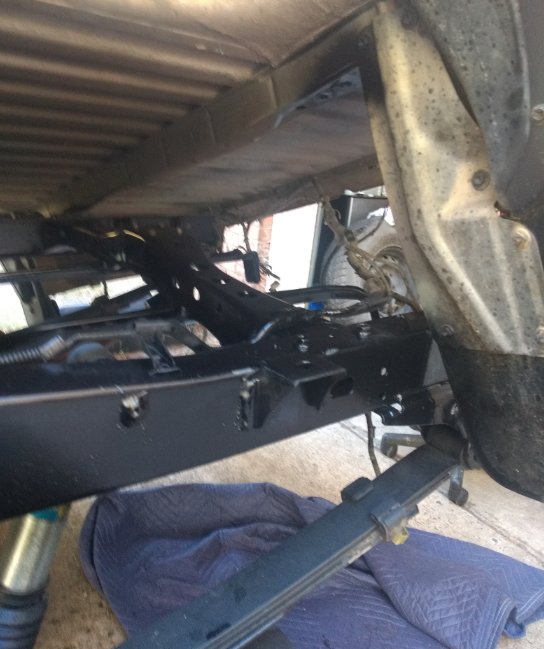

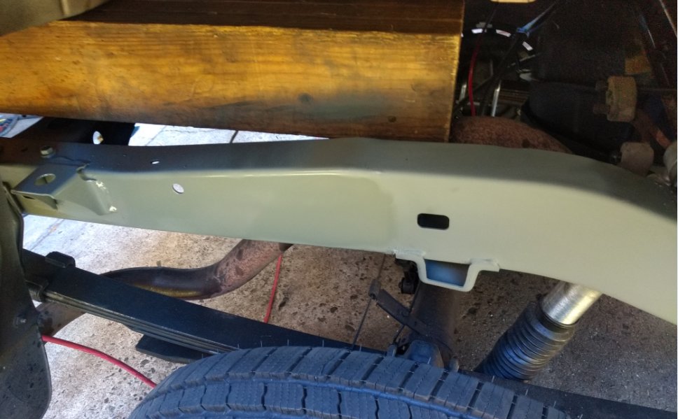

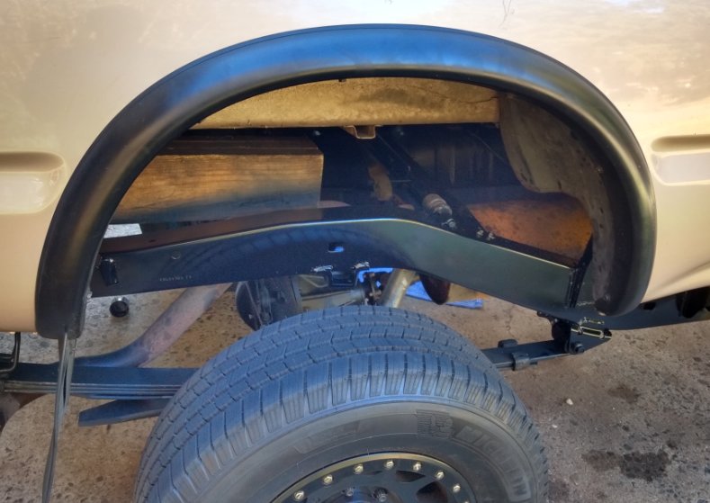

    Waiting for primer to dry before I finish the final round of paint today.
    Driver side rear.
    Passenger side rear.
    Waiting for the primer to dry.
    Passenger side finished. It came out shiny enough to see the tire tread reflection on the frame.

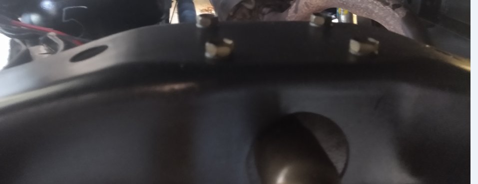

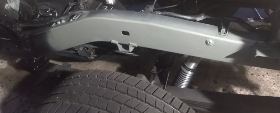

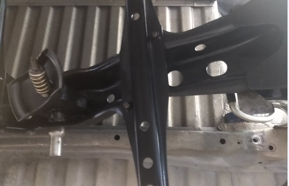

    my surface is definitely not smooth after removing most all of the paint and surface crust on the passenger side for now. lots of little black paint chunks left i may spot clean with the blaster when the weather cooperates. the primer i did on the driver side still shows chunks but maybe will disappear with a top coat :notsure:
    this image has just the afterblast phosphoric and zinc coating
    and two coats of primer
    rubber coating covered since new but winter roadspray had seeped behind it over the decades, or else i forcefully washed it into there lol (i am a madman at the wand spray wash)
    driver side

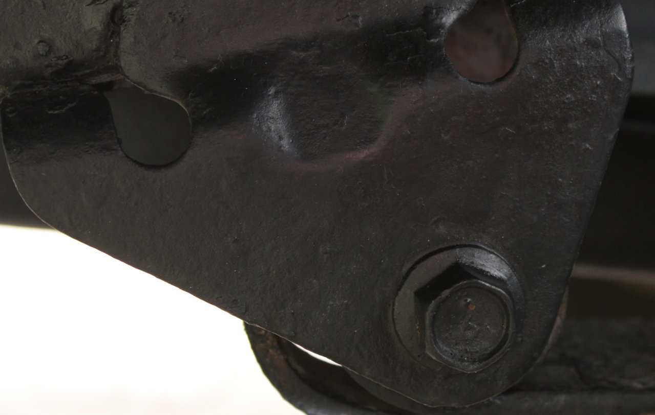

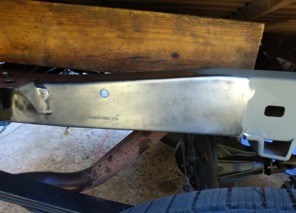

    After work tonight, I wanted to wire wheel the outer part of the passenger side frame under the cab. I was able to take it down to the metal and prime it. I should have good weather tomorrow for wrapping up the frame clean up project.
