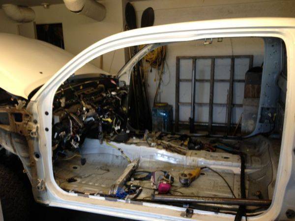

    2,848
    Dylan
    Littleton, CO
    2001 DC
    So I did a little work today, most of the day was spent getting the front window out and organizing things. But got the cab off the body mounts and cut down to the frame in the rear, and just the rear seat frame out.

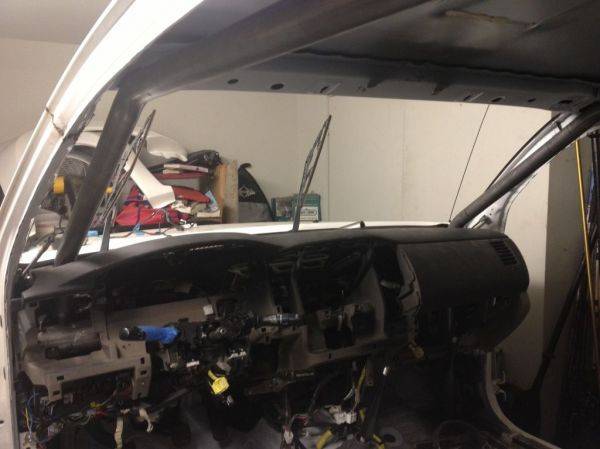

    2,848
    Dylan
    Littleton, CO
    2001 DC
    So stoked on how the first and hardest bend came out, wasnt easy but I did it

    2,848
    Dylan
    Littleton, CO
    2001 DC
    I cut holes in the cab, going to plate over them once I have the a and b pillars bent
