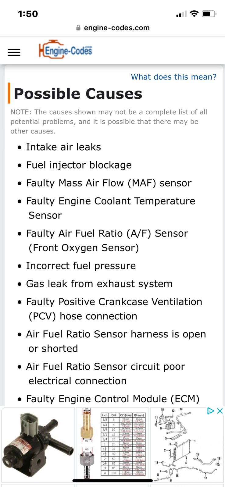

    New member here. Im having the same issue with my 2004 Tacoma with the v6. Got a P0171 code . My upstream 02 sensor was bad. Looking at possible causes I cleaned the MAF sensor then replaced it using an OEM part. I had no issues for about a week then popped the same code. So i removed the upstream 02 sensor, cleaned it with carb cleaner(temporary attempt) and reinstalled it while I ordered a sensor on ebay. I bought one if the generic sensors and after I installed it, the truck surges like crazy on acceleration. It doesnt stall but steadly surges. Im soaking the old sensor in lacquer thinner as I write this and am going to reinstall as a check. If that solves the problem then Im pulling the throttle body for a good cleaning since this is a new to me truck. I had no driveability issues other than the code. Does anybody have experience with failures with the genaric sensors (chinese)? I know Denso and OEM Toyota are the best now it s time to order one of those.

    p0171 has many possible causes
    Looks like you attacked 2of them
    That surge u speak of….is a clue
    What exact sensor did you RR after the front O2 ?
