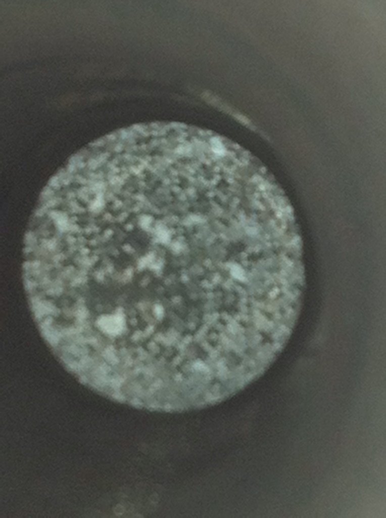

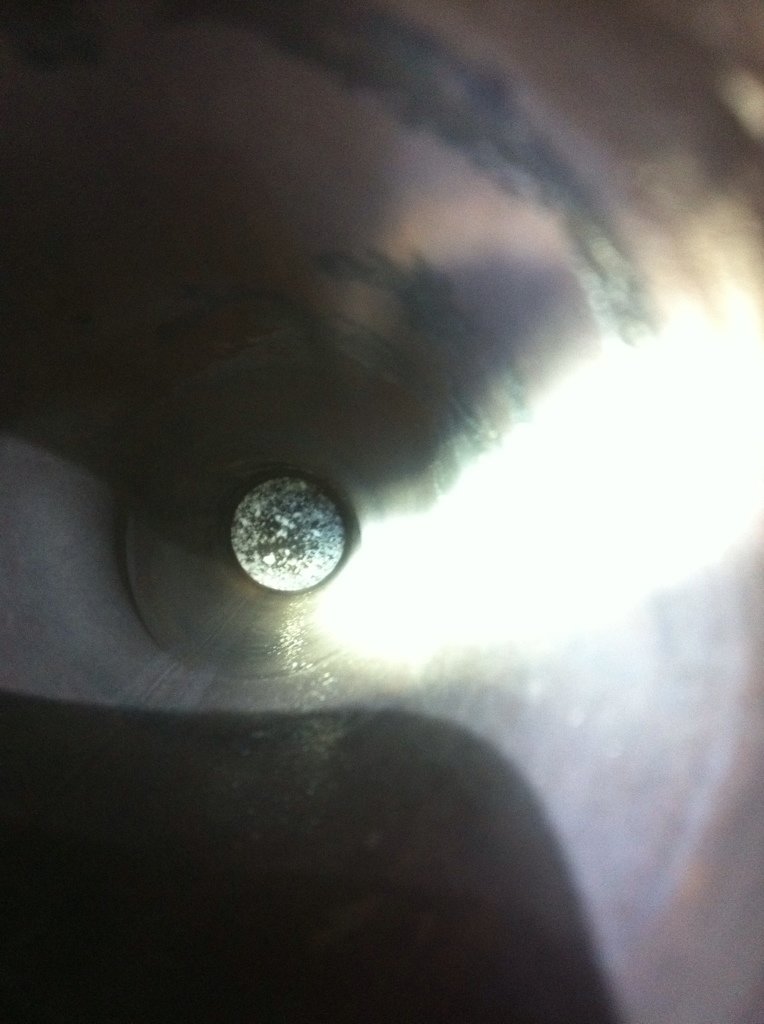

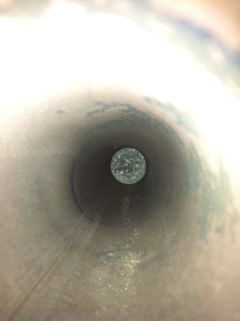

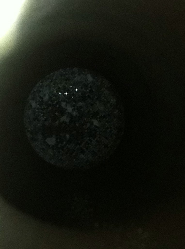

  16. Jan 22, 2013 at 6:40 PM
    #216
    jberry813
    jberry813 [OP] Professional Fluffer Moderator
    Jan 21, 2011
    #49636
    28,479
    Jason
    Lake Tahoe
    2012 DCSB Sport
    ...too much shit to list.
    E13F30C9-B048-4B42-93DA-77E654E860D0-612_d212edaad8e134b0bb8c6b89025542e7387926ab.jpg
    478621FD-7BF3-49F3-9632-3A5398869D1D-612_ad45477d2979d33a30987092dc565d0060c91222.jpg
    C963B38A-1725-4607-9572-6C1543317A6D-612_ee552e151d75924b3d6cc8db288d11745290130b.jpg
    1072B772-A5CD-4E0B-AD77-59EF70BC042C-612_e2976f385713752a9458616917ee0e5a38c90783.jpg
    Exhaust cooled enough to get some pix. All pix are looking down the direction of exhaust flow. Looks like some white shit all over. Last pic is with a led flashlight on the backside and you can see how little light is shining thru.
    Soon as it cools all the way, I'm gutting it.
  17. Jan 22, 2013 at 8:48 PM
    #217
    Shaggs
    Shaggs Well-Known Member
    Feb 26, 2012
    #73708
    1,901
    NorCal
    2012 DoubleCab Long Bed 4x4 TRD Magnetic Gray
    usually see a p0420, but sounds like a good candidate. I have seen it on plenty of vehicles but it usually will reduce power under any accel. Imagine running a marathon while breathing through a coffee straw...
    Somebody say Test Pipe with 02 defoulers on downstream?... :)
  18. Jan 22, 2013 at 9:06 PM
    #218
    ian408
    ian408 Well-Known Member
    Nov 8, 2009
    #25619
    19,658
    Ian
    Santa Clara, CA
    09 Tacoma
    Dude. That thing looks like the bottom of the space shuttle.
    Biscuits likes this.
  19. Jan 22, 2013 at 11:57 PM
    #219
    jberry813
    Jan 21, 2011
    #49636
    28,479
    Jason
    Lake Tahoe
    2012 DCSB Sport
    I made a quick ghetto test pipe with some spare tubing and mismatched flanges and half ass bolted it back up in place just so it wasn't so loud so I could get a really good feel and test. Truck ran just as great and still no more surging.
    Second cat was plugged up tighter than a virgin's ass. Gutted it completely and bolted it all back up. Got back a ton of power that I thought I lost, but was sure it was all in my head. Put my supercharger and brand new cooler plugs back on and it's running like a bat out of hell again. When I get some time this week I'll drop the tank (again), put the larger fuel pump back in and go back to the smaller pulley, piggyback and 7th injector and be happy as a pig in shit again. Since I still have the first cat in I'm betting the downstream O2 isn't going to complain. If it does, I'll get an O2 simulator from URD and call it a day.
    Thanks for everyone's input
