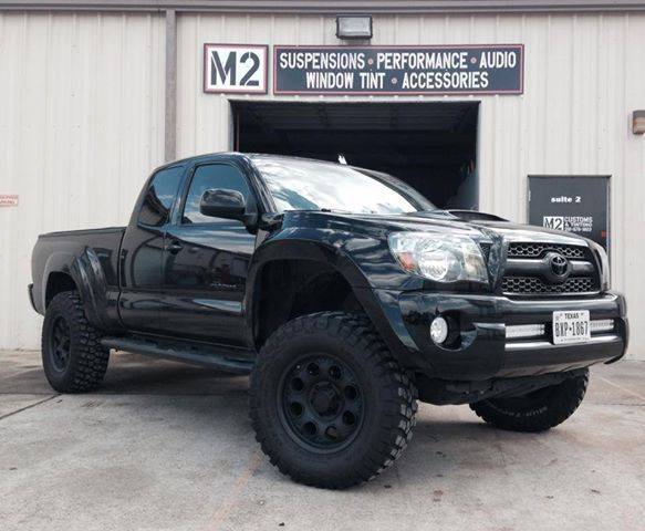

    I've noticed on several occasions, if i get on it, light to light so to speak, that when i have to come to a quick stop, i get a very hard surge that almost feels lie someone rear ends me? or if it doesn't do it before i get to a complete stop, when i hit the gas to go, it will hesitate THEN surge like someone rear ended me. sometimes hard enough to get a little chirp outta my tires???bigger exhaust help this? I'm all ears!

    the clunking noise you talk about sounds familiar… is this something i can make stop somehow? doesn't seem good on my transmission

    i see. to be honest I'm not sure about the blocks… id have to look? is that pretty much standard on all lifts? 3" Pro Comp suspension…?? i don't work on it, man, i just drive it. I'm learning as i go at the ripe old age of 38
