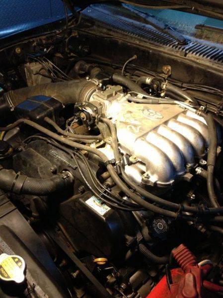

  13. Jan 3, 2013 at 12:21 PM
    #73
    Blackdawg
    Blackdawg Dr. Frankenstein
    Dec 31, 2010
    #48500
    81,581
    Monte
    Wyoming/St. Louis
    The Trifecta of Taco's
    I didn't miss it haha i new it was together..
    I have an AEM wide band I haven't used...also have an LCII which is my dads(hasnt used it in forever)I think just plugs into your OBDII port and with give you the A/F. I could ship it to you if you want to test it..but now that I think about it. Think you still have t get another bung welded on..
    In short..nothing new tho..hmmmm..
    Odd shit going on..
    Guy talking about graphing meter is talking abou making sure the TPS isn't skipping..seeing as how 2nd gens have an electronic TB. Since ours our cable..not important.

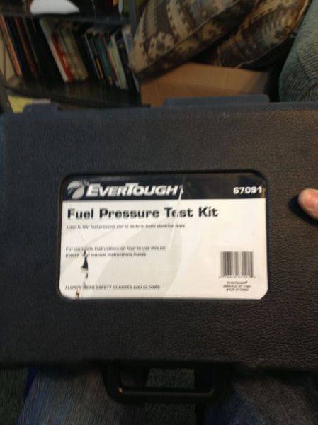

    Well lookie what Oreilly auto has for a free 48 hour rental

    nice, i just edited my post with a diy fp test kit but nobody can pass up free.
