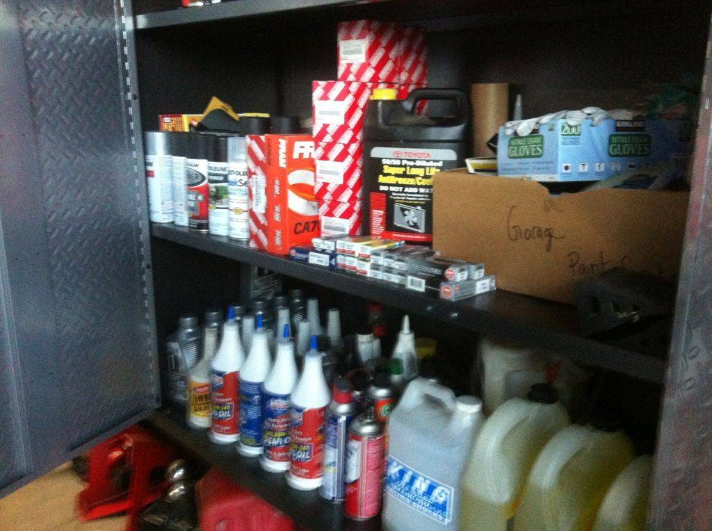

    Nothing was done under the hood with when I rebuild the rear end except pulling the ABS fuse and disconnecting the battery while I was welding. I have since plugged that back in the 30 amp fuse, and obviously the battery.
    As for the Tundra, I never work on that thing. I just put gas in it and change the fluids once in a while. The nice part about buying a vehicle brand new and doing all the work yourself is you know EXACTLY what's been done to it. No rats nest of wires, no chasing other people's gremlins, just easy peasy.
