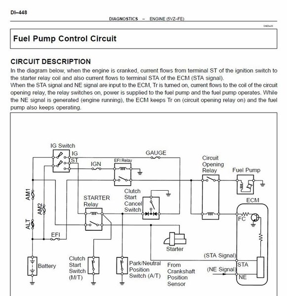

    Found this little jewel in the FSM.
    Pulled the circuit opening relay and hotwired the fuel pump on with ignition. Took it for a spin...no change. Means FC output from ECM is fine. Also metered FC while driving and it never got above .05 volts which isn't enough to turn the relay off....can rule that out too.
    On a long shot I also set the crank pulley at 0 and pulled the upper timing belt cover off far enough back to check the timing marks on the cams. Everything is dead nuts center as I expected.
    Emptied a bottle of carb cleaner and a small propane bottle hunting for vacuum leaks. Not a single fuck given by the engine....
