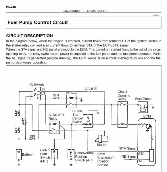

    why are you worrying about filter/pump? you tested the pressure and it was good correct?

    That is what one would think. however a clogged supply line, depending on the type of clog, can actually cause a higher initial pressure. Though it would not cause what is happening in his case I believe. Yes, as I mentioned a clogged return line can cause an increase in pressure. What we are trying to also figure out however is what is causing the "jitter" in the pressure when his problem occurs.
    Good test and that helps to rule out an electrical problem as far as the fuel pump goes. I am thinking without us being able to run any of the more extensive tests that I can run here, that you might be best to consider replacing that FPR. Then clear all codes before you drive it. The FPR is still a possible suspect, and I am REALLY leaning towards that as the failure. This is why: There is a spring inside that controls the pressure. This pressure can be further controlled by manifold vacuum. If the FPR is having a problem, the fluctuating needle on the gauge could be a result of the spring "pulsating" due to a higher pressure. I don't know how to explain it any better. A good regulator SHOULD be able to control a higher pump pressure, but only to an extent. 5 PSI is not that big, so perhaps that is where your problem is at. Everything is leading to the FPR at this point as we now know that your electrical control of the fuel pump is good.
    as for shooting yourself for taking it to a mechanic (lol) don't look at it that way. Technicians like me have been doing this for over 20 years. How long have you been doing it? IT is never a bad idea to give something to a professional. I can do a lot of different things, and am a WIZ at numbers, but when it comes to my business taxes, I won't even THINK of doing it myself, and am willing to pay the $500 it costs to get my business and personal taxes done by a pro.
    I disagree with you "big name places" thoughts there. I have worked in GM dealerships for over 17 years, and I could still properly fix Toyota, Ford, Dodge, and other vehicles. What one needs to look for is a personal referenced tech who does things like I do: I don't put in a part until I know that it is bad. I spend a lot of time checking and verifying before I replace something. Not to say that sometimes you have to make an educated guess. Every tech does that every once in a while. But I try to never do that if I can because it is not fair to my customers.
    Did you ever try the test under a "power brake" as I had mentioned? You may have and I just forgot or missed your reply.
    If you look back you will notice that we actually are having a problem with the fuel pressure. When the failure occurs he is seeing a pressure fluctuation on the gauge.
