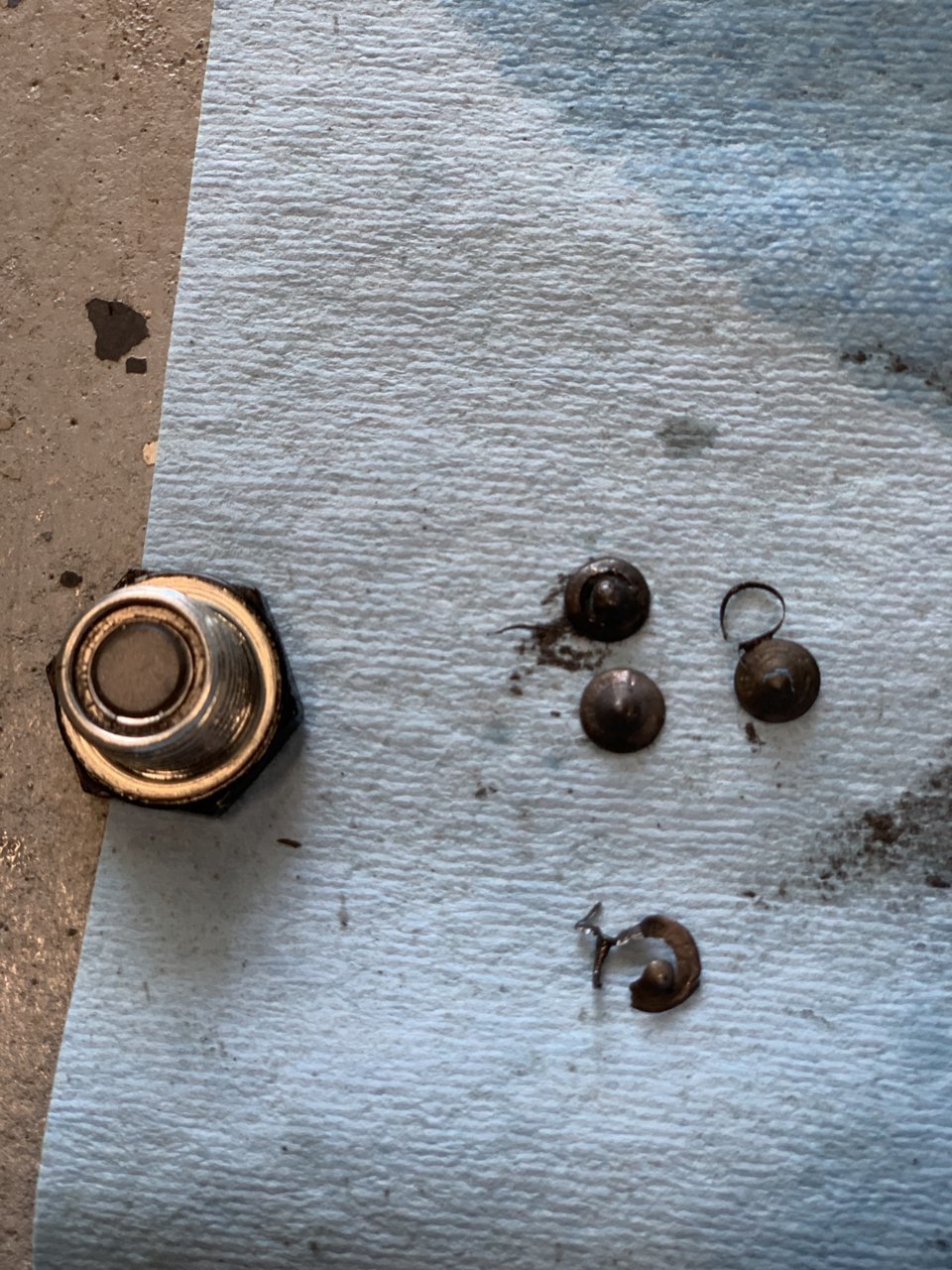

    Funny thing with the picture of that diff plug. Completely dry, no gear oil or gear oil residue on it. But all those pieces on it, theyare clean/dry also... Makes me wonder...

    I’ve very rarely seen that size particles. Usually the damage is already done, when I see that large a particles. Not trying to create panic by any means, but I would raise all wheels and turn the axles and listen for anything different between L/R sides.
    I would also look for the sides on the inside of the rear axles for any grease. If you have a locker I would engage and listen to it also.
    The bearings maybe lubricated by grease and some of those particles look to me like it maybe bearing seal material from the inside.
    At any rate as some have suggested, nothing can and maybe done at the dealer if no strange noise or sound(s) are heard. Therefore at least for now, it could be nothing to worry about.
    But as for me, I would do as mention above just to help me sleep better.
    And btw, you did well in replacing the fluids. I changed mine somewhere around 5-10k as it’s best practice imo but that’s just me.

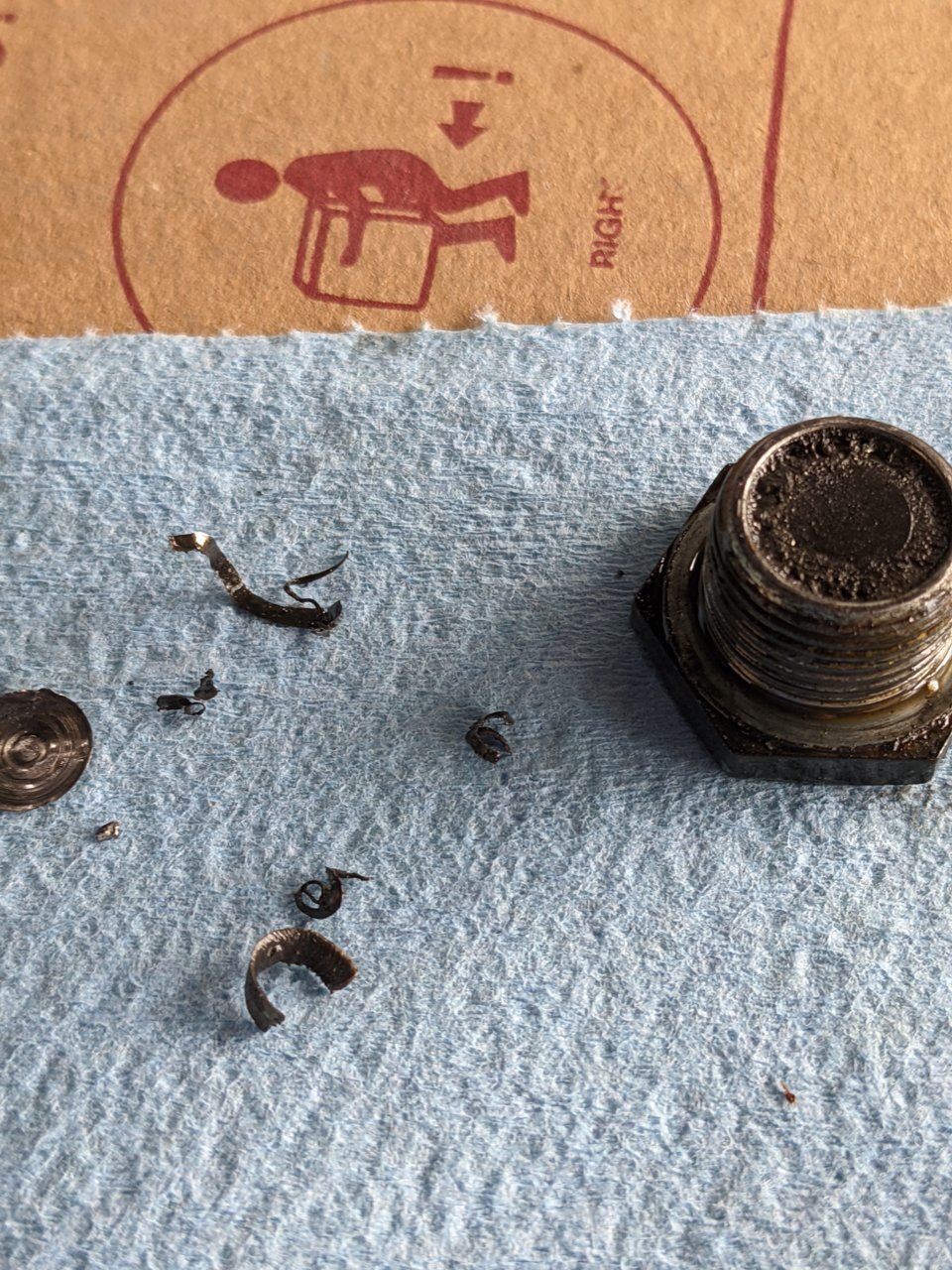

    Damn! I had just regular tiny metal shavings on the magnets when i did my diffs at 18k miles. Front diff fluid was 10 times worse than the rear.
    Yout fluid looks great though, mine looked similar at 18k miles.

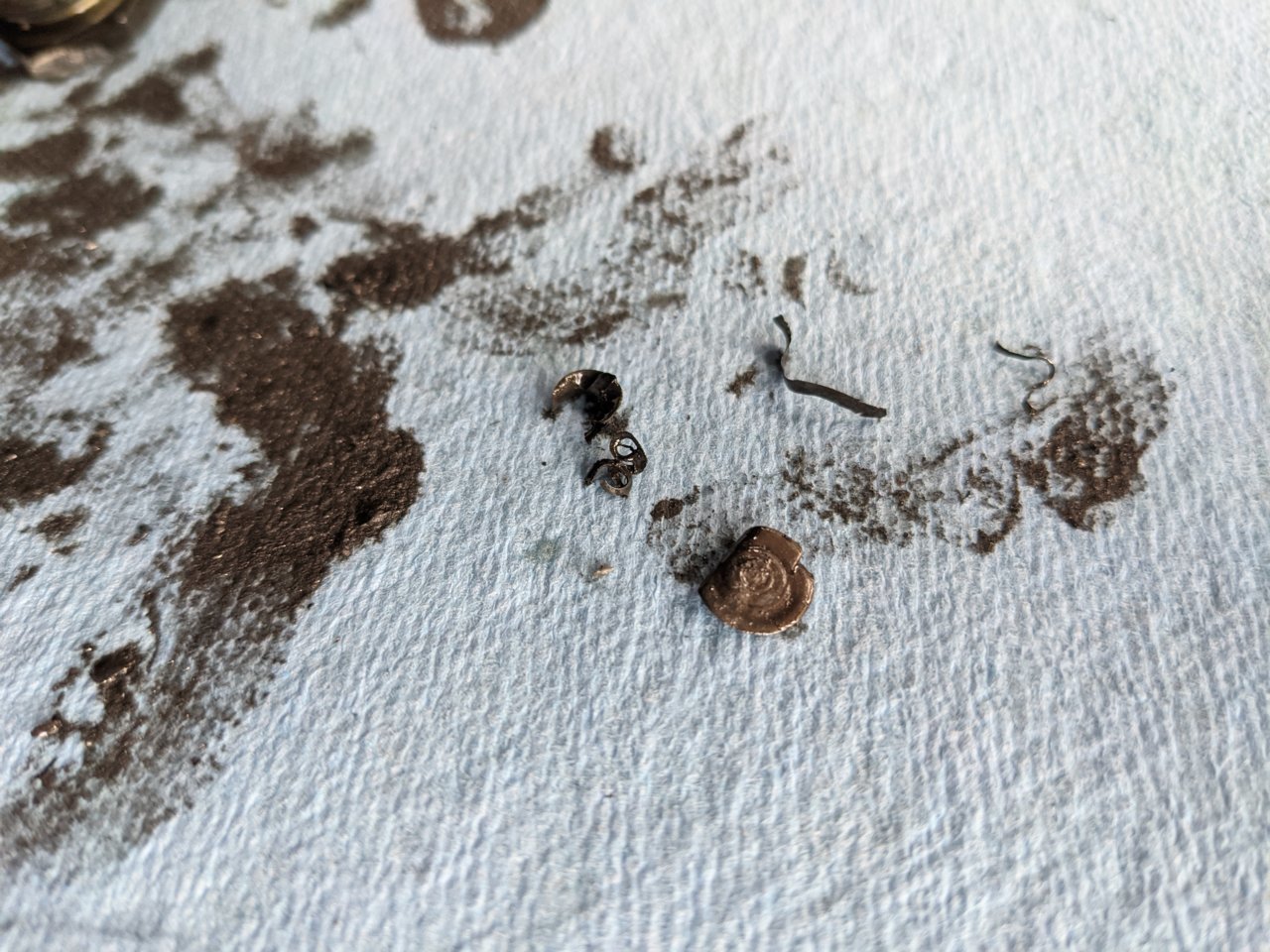

    Tried to wipe things down to get a better view without the sludge.
    Anywho.. everything is complete, thanks for the reassurance TW.
