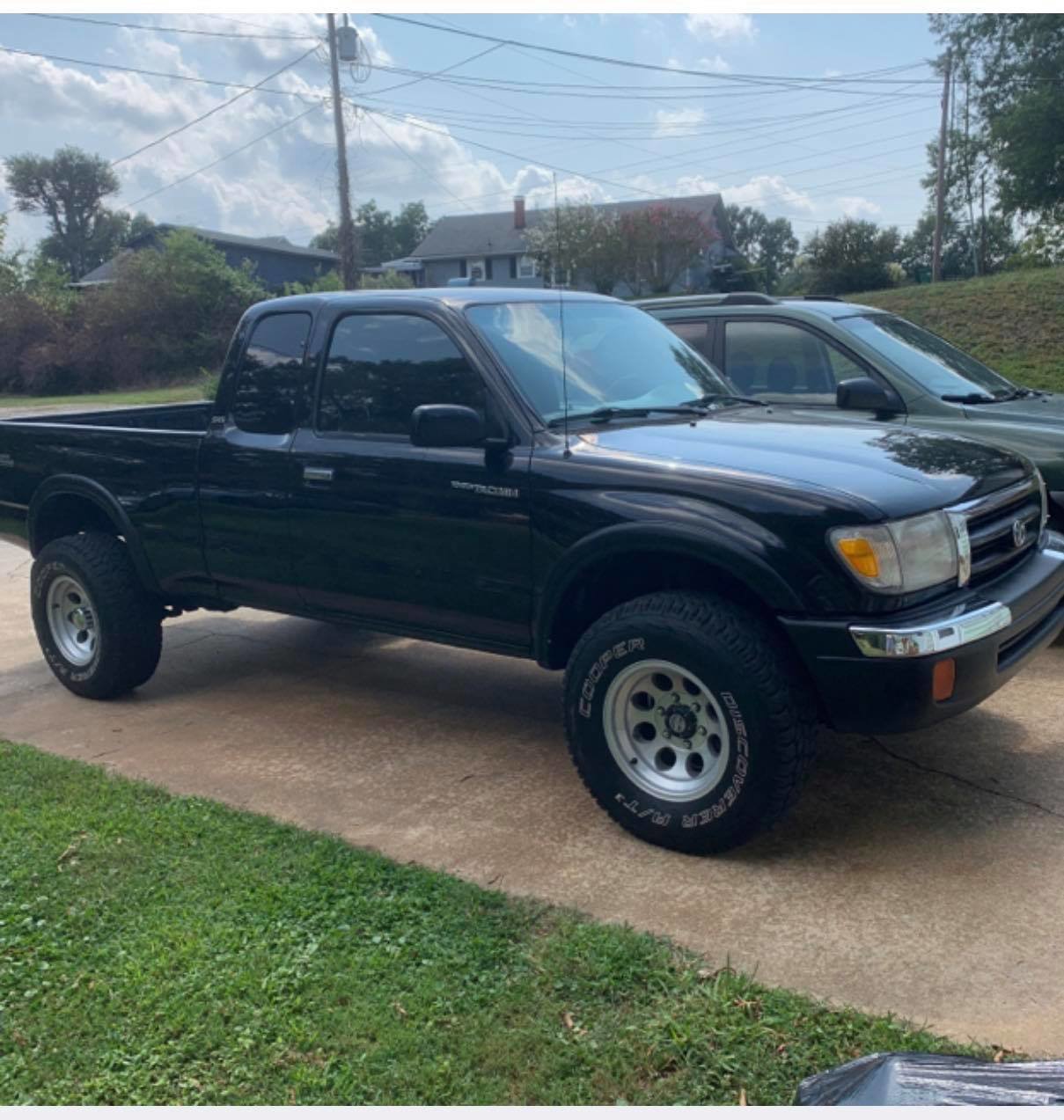

    Just incase anyone is curious about what the truck actually looks like here is a picture. The photo is compressed badly for some reason so it is kinda blurry but it gives an idea. Will upload another soon!

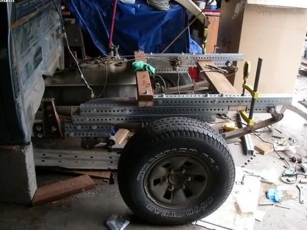

    Not the greatest of repairs, but well, it can't be worse than this...
    337716d1195790578-frame-splice-frame-rep_95302107a9b78a263312ed6ee70c3f7b1ec3df15.jpg
    I suggest what the others have said. You cannot undo what was done, but try to reinforce/make it better. Do it yourself if you know how to weld or find a reputable welder
    I wonder what the front looks like? It's a shame they put the rear half of a rust-free (?) frame on a rusty front frame. SHould have swapped the whole thing instead
