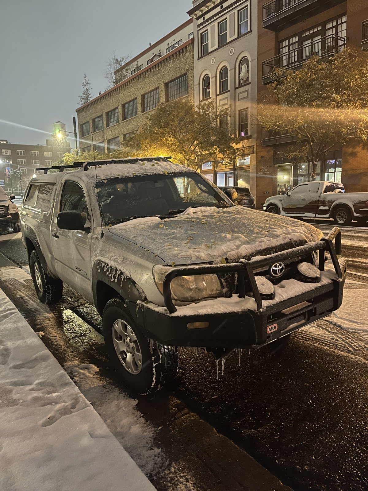

    FC09F05D-7E66-4C29-943E-F3303B76C384.jpg Looking to upgrade my front and possibly rear suspension.I have an ARB bumper and recently bought a winch.looking into buying bilstein 5100s and using the oem springs.let me know any suggestions.
    Winch is a Smitty built X20

    You've got quite a bit of additional front weight with an ARB bumper + a winch. I certainly would at least go to something like a Bilstein 6112 to have some additional oil capacity. Might even consider stepping up a notch in terms of spring rate.
    How is your front end lifted now?
