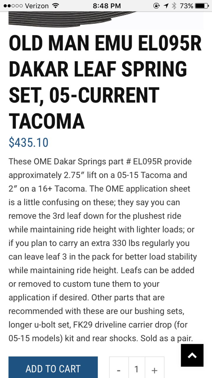

    According to OME, you can remove the third leaf down to get a plusher ride.
    abqnurse80[OP] likes this.

    That's my job in the next few days.. still think a more progressive spring would be smoother. But I'm thinking about taking the third leaf and one overload out

    Definitely worth trying! Overload won't affect ride at all though. It's just a thick leaf at the very bottom to keep them from arching over backwards.
