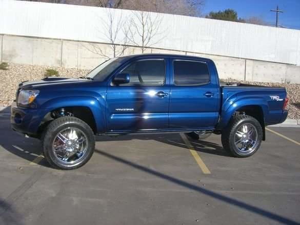

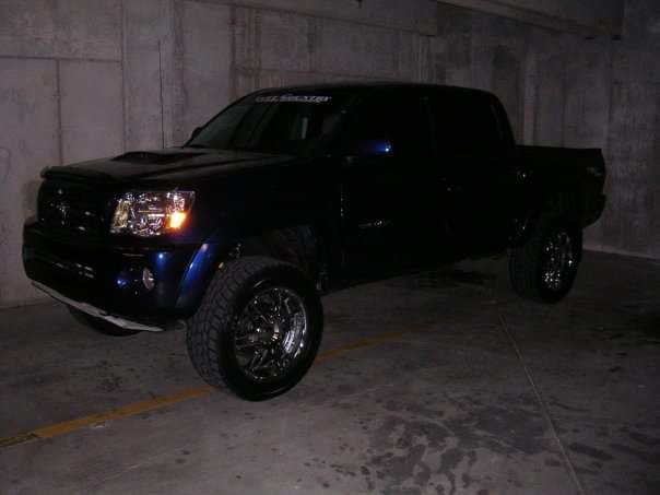

    I think relatively small is coming back in the trend. At least on trucks.
    My 08 sport had 20s on it. I wouldn't dream that such a ludicrous wheel size could go on my 18.
