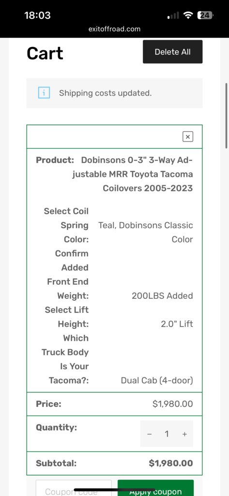

    Screenshot_13-5-2024_104145_exitoffroad.com.jpgThoughts? I'd like a 3" lift thats level overall. I currently have the 220mm seat height selected should i change this?

    Those struts are not height adjustable. GS59-221 are 213mm, GS59-220 are 226mm (they add 1" of lift). C59-352 with GS59-220 gives 3" of lift with ~200lbs added to the front of constant weight.
    The only other thing you need is u-bolts.

    What would I get with the GS59-350 and GS59-220? Is that a 2.5” lift with a constant weight of 140ish? If so, will this give me a level look with the full 5 spring pack? Do you recommend a new UCA with this set up?

    Yes that will be about 2.5" up front. The full rear leaf pack lifts 2", so you're only removing 1/2" of rake with that difference.
    I recommend UCAs at any height of 2.5" or more
