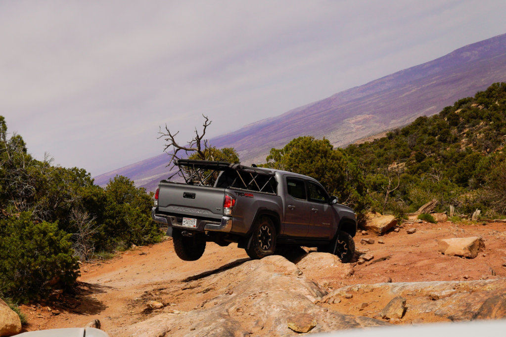

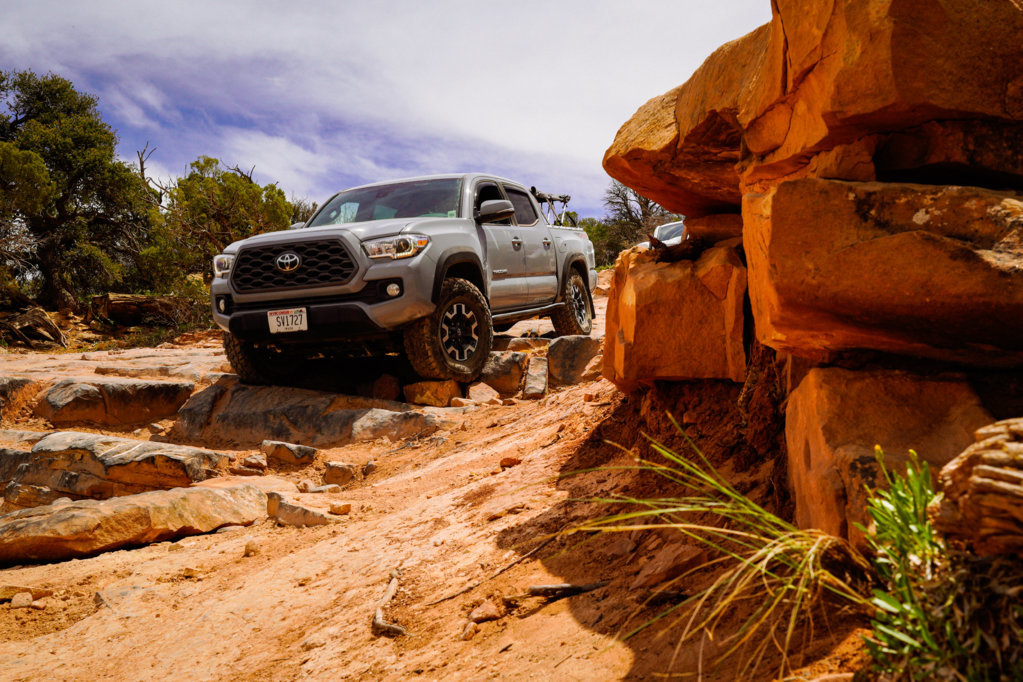

    Another vote for stock suspension if you prioritize daily driving and minimal maintenance, unless you want a lift for other reasons, these trucks are super capable stock. I'd invest in taller tires and armor for offroading before a lift or suspension in general, at least that's what I did, no regrets. A lift only raises the body of the truck, taller tires raise the diffs/axles (i.e. the important stuff that's likely to get hit first). I beat my truck up on 2 different Moab trips with just 33x10 (255/85R16) tires and skid plates/sliders and the sway bar removed, the suspension was not a limiting factor. I also have no desire to do additional maintenance on my truck if I can avoid it and I have no need for a lift, the original suspension components should last a long time and be cheap to replace.
