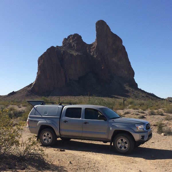

    Hello Everyone,
    First time posting. I have a 2015 Silver Tacoma TRD that I bought new. I use it for work, loaded with camera/sound gear, and for camping. I have a shell on the back. I have found the
    back suspension to not be enough when fully loaded with camping gear, as well as my clearance. Was recommended to add a leaf and lift 2.5" to 3". I know my total payload is 1,040 lbs including passengers. I don't seek crazy 4x4 scenarios, but occasionally come across some areas that require a little more clearance.
    I found a shop recommended by another Tacoma owner who had the same thing done. They quoted about $1,300 to do both. I will contact them again to get specifics on what products they will be using and what they will do.
    In the meantime, is there any advice from all of you knowledgable folks on the pro's and con's of doing this or any other solutions possible solutions? The shop mentioned possibly airbags.
    I will be completely honest, I know very little about the technical aspects of this endeavor. All I know is my truck sags when loaded and I scrape bottom on rocks that a 4x4 truck shouldn't be touching.
    Thank you in advance for any help you can provide.
