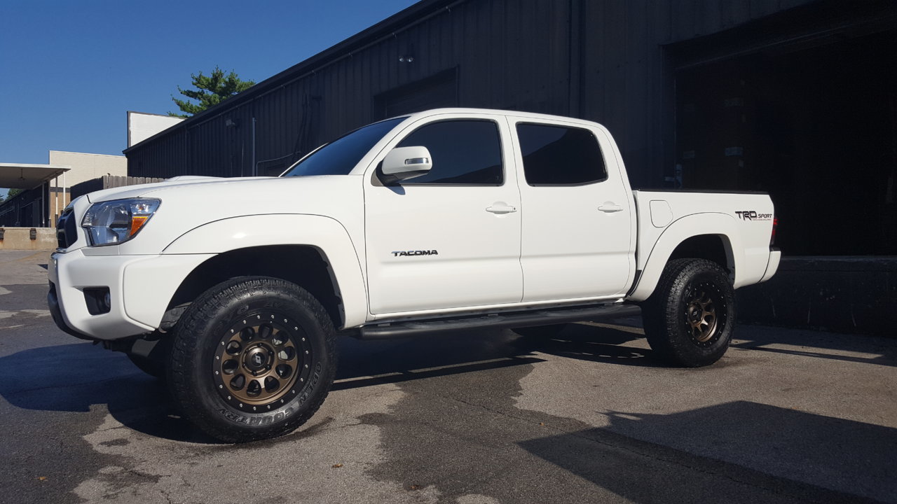

    I ran the 5100s on stock coils with a 1" block in the rear of my '15 with 265/70/17 and all was well.
    I now have a '22 with Eibach 2" coils/struts and a 1.5" AAL on the rear with 275/70/17. A little rubbing, but my biggest complaint is that going from a 265- to a 275- adds a lot of weight due to a heavier class of tire. You'll definitely feel it being more sluggish and drinking more fuel, but it sure looks good!

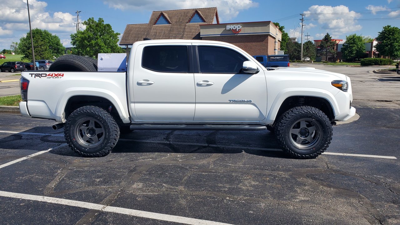

    I use stock coils, OME sag over time. Riden and drove a few on OME springs. I noticed no difference and been in this tacoma with OME a time or two. Oh, his started sagging and now he is back on stock coils. I feel my ride is way better than the stock shocks so thats a plus! Been on this setup going on 4 years and could not be happier!
