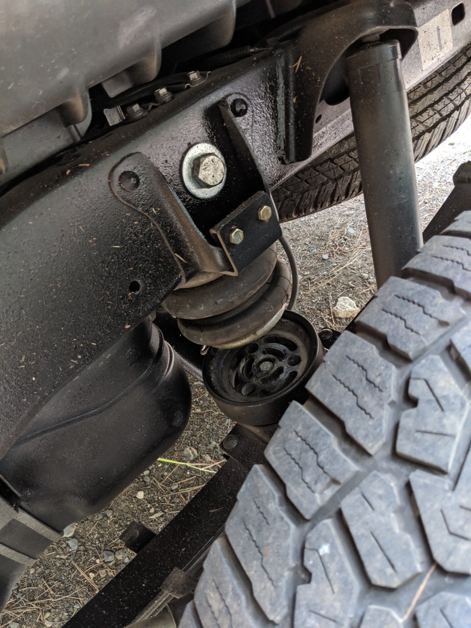

    I’ve got 5100s in the front and 885 coils. In the back I’ve got firestone air bags, daystar cradles, and soon to be a set of 5160 shocks. It sits pretty level with about 20 psi in the bags (I have a canopy and usually 100-200 pounds of tools in the back). It rides really good on the highway and looks decent too. I wouldn’t mind it being a little taller but then mpgs already suck. I’ve also got a us off-road front winch plate and winch so my nose will sit a little lower then yours.

    Daystar cradles doing their job:

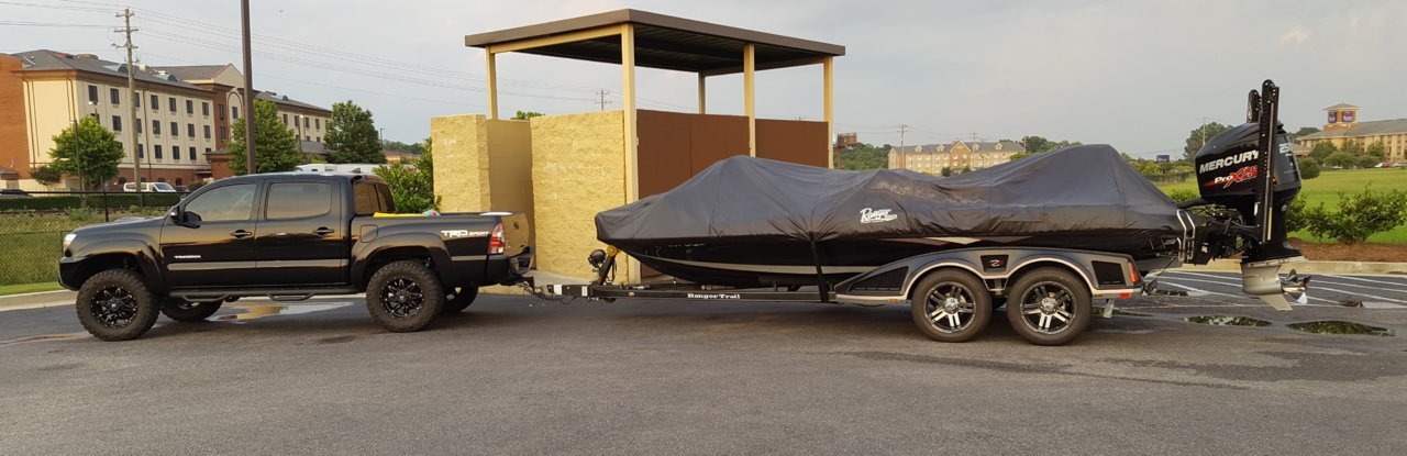

    3" lift on 33 inch Nitto's with 18" Fuel wheels. N-Fab step bars. Husky floor liners.
    I pull this boat sometimes three to four times a week with no problem. 3" lift with spacers in the front and AAL in the back. Yea it makes it lean a little but still drives and handles great.

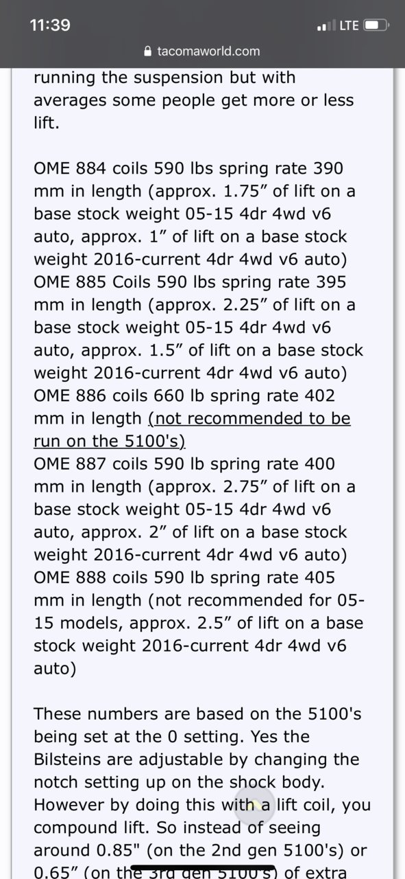

    OME recently redid their spring lengths and stuff so people are getting less lift out of them then they used to. I got about 2” before the winch in the front and in the back I got about 1” with the daystars and airbags. Now in the front I’m sitting around 1.5” lift or so. Marie at headstrong will tell you exactly what you need for your truck. It can get really confusing really fast if it’s your first time lifting a Tacoma.

    Here’s a note from her from when I was doing my lift:
