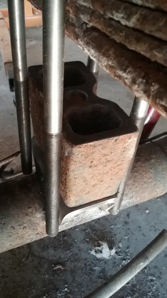

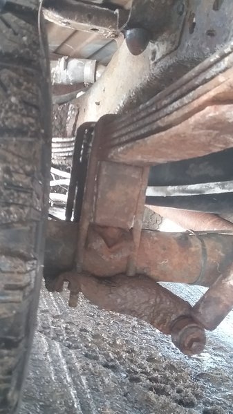

    Wrong. Ford puts blocks on all of their 4x4 trucks except the raptor.

    Incorrect. Ford uses blocks because the springs and axles are the same in the rear whether you have a 2wd or 4wd, to simplify the manufacturing process. That way when they build a 4x4 they just have to use a taller block and longer U-bolts instead of a completely different spring pack. The big 3 have been using this build process for decades.

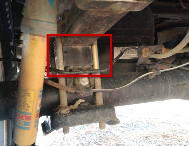

    Ok, you caught me...lol. I didn't look under EVERY SINGLE truck. But i did look under 3 F250, 1 F350, and 2 F150 trucks. They all had them. I have to go there on Friday and I will take a picture then

    Take a pic of what you think are blocks on your Tacoma.

    LOL (about the ford). Here is what my truck looks like

    So with blocks, how are they held onto the truck? By shear weight of the springs and U bolts or is there a bolt that runs through the block to make it stay in place?

    The Ubolts hold them in place. You've got a bolt shaft at each corner of the block; they aren't going anywhere.

    These blocks were in place for 30+ years (from the factory) on my plow/work truck with zero problems before the spring perches rusted away.
    I welded on new perches and the blocks are still on there, and I can guarantee I've dragged/pushed more weight then you'll have to worry about with your truck. Run 'er! :burnrubber:
