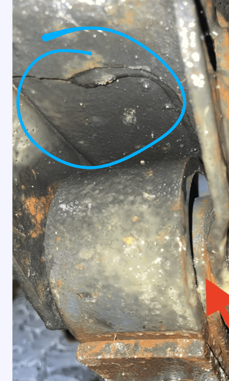

    Final update.
    Got the energy suspension bushings. I was able to droop the leaf packs enough to pound out the stock Dakar bushings without removing the U-bolts. The passenger side popped right out with a dead blow hammer and hate but the driver's side required a ball joint press. Had to unbolt a couple brake line brackets too.
    Getting it all lined back up was a pain but it's back together now and the clunk is GONE! Rides like a new truck.
    Now just need to convince myself to replace all my OME crap with Icon...

    Nice on resolving the clunk... Not trying to be negative but I have to ask, is that a crack??

    I think it’s just a trick of the light (flash and angle from photo), the whole underbody is coated in fluid film, but I’m definitely gonna crawl under the truck and look before work tomorrow
