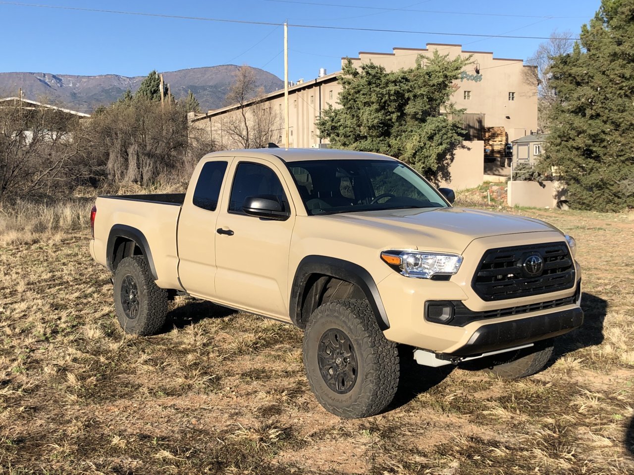

    I went with the 6112 in front and 5100 with a 1” block in the rear. I rarely if ever carry weight in the back, so AAL would have just made for a crappy ride. Similar to you, I have a lot of packed dirt roads, and a lot if washboard roads. We also have a fair bit of rock ledge, I don’t do any rock crawling, but some of the rocky trails are fun. I am very happy with the suspension setup. It rides really well, and I think it looks great. The more important part, is it handles extremely well on all the different types of roads.

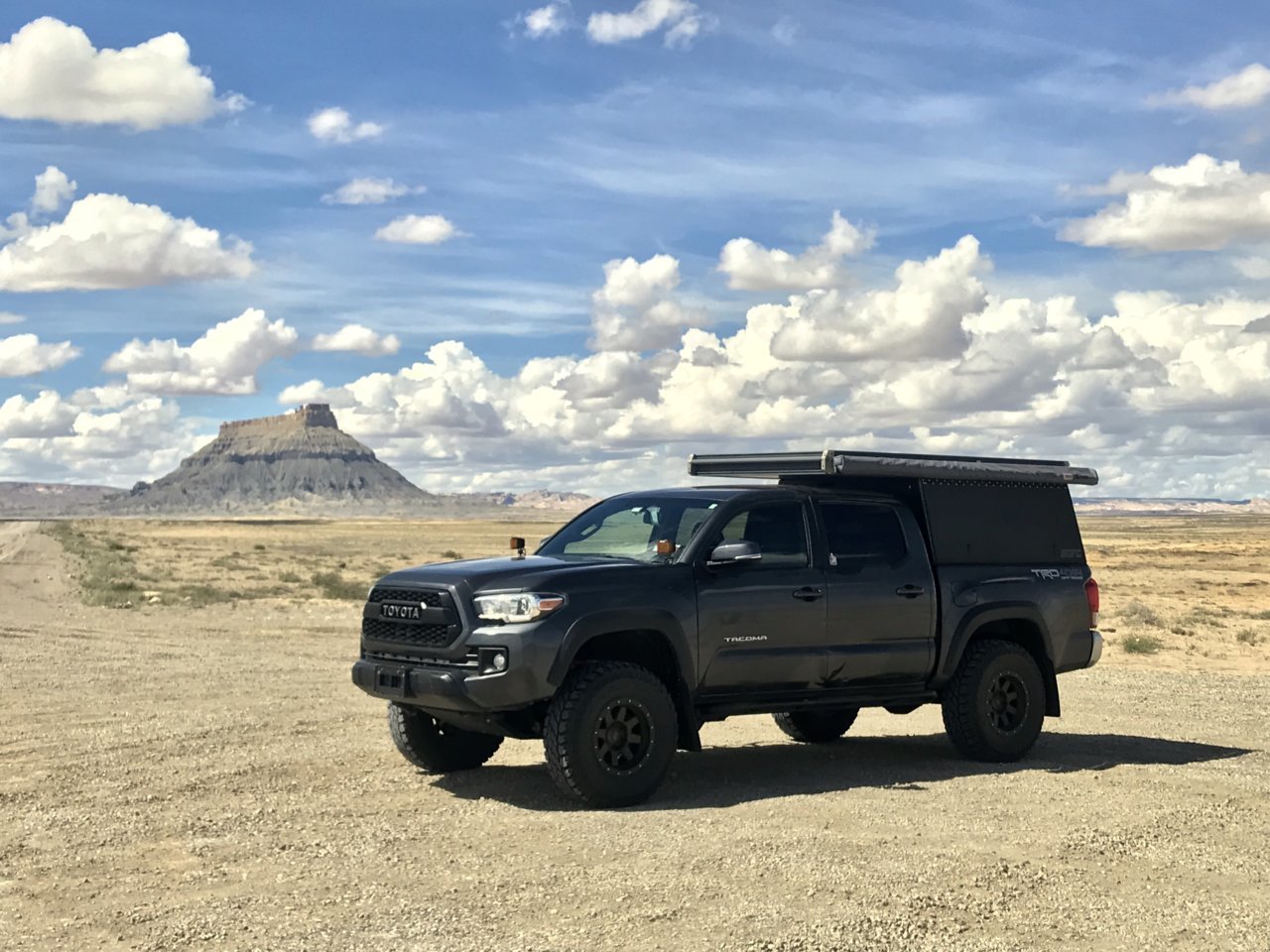

    I installed a OME medium load on my 2020 and had an OME heavy load on my 2010 (which was a heavier build). You can get better for more money and complexity (like UCAs), though OME hasn’t let me down in over 100k miles of driving on them. The weekend after I installed the suspension we did a 100 mile group run on low grade asphalt, and forest and logging roads. We were really pleased with the overall ride and I haven’t found myself needing or wanting more.
