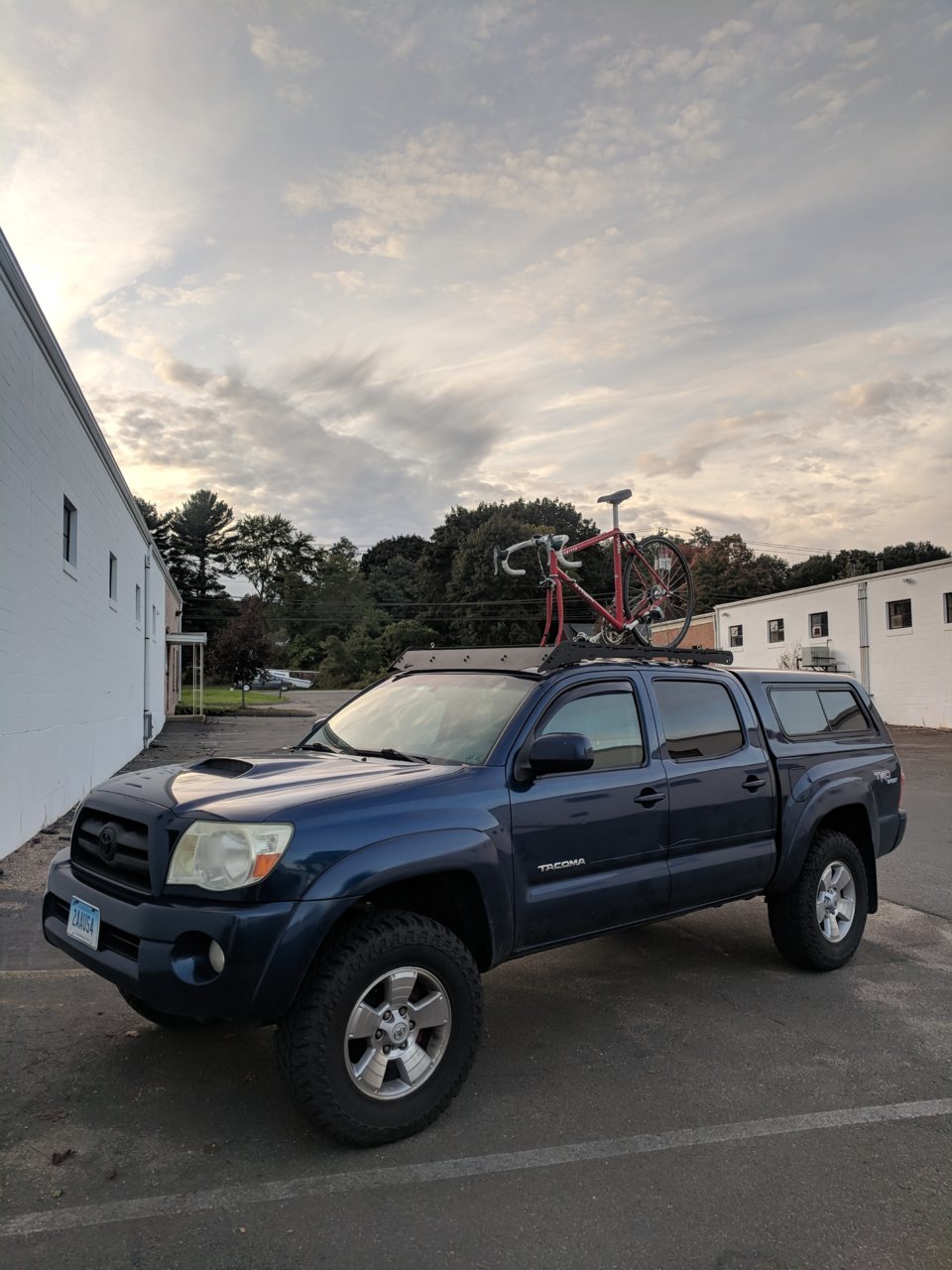

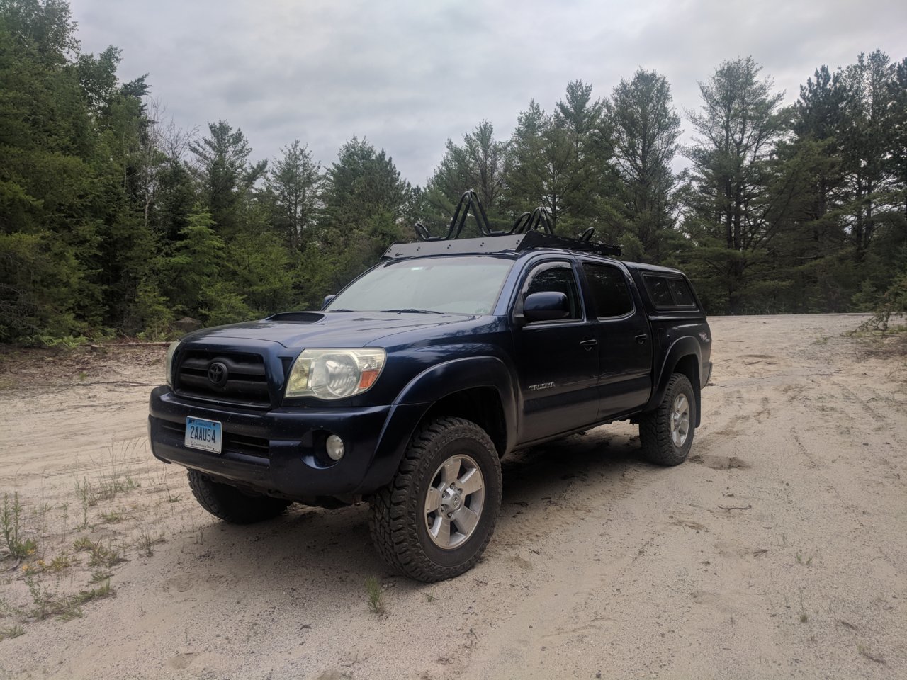

    I have 255/80 R17s on the tacoma with SPC UCA's, 885s, and 5100s.
    I wouldn't say that the truck rides smoother, but it definitely keeps the wheels on the ground over rougher terrain at higher speeds. My dad has a stock third gen that I drive occasionally, and it feels like I'm bouncing the whole way down the road. Railroad tracks and big bumps are no issue with my truck, but in his I feel like I hit the ejector seat button and I'm going through the roof.

    Do you have any good pics of your truck handy? I'd love to see it, as I'm considering almost that exact setup.
    Also, how is your MPG doing with that setup, and is there any rubbing at all during full flex or otherwise?

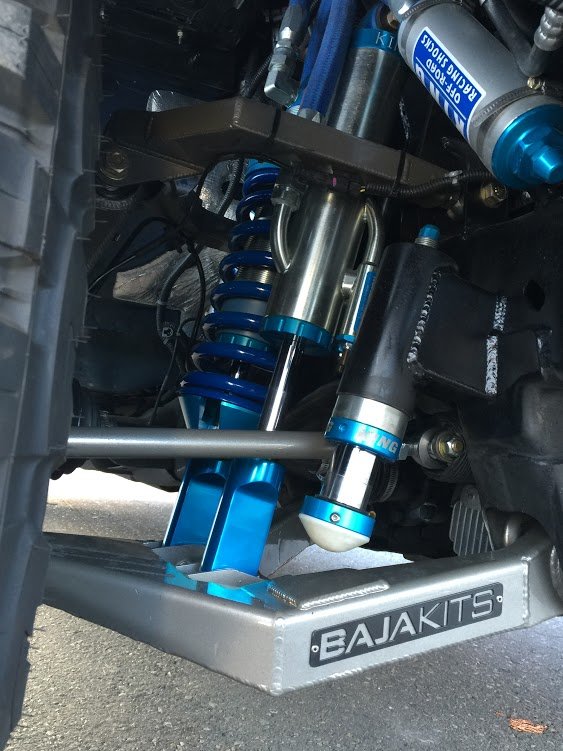

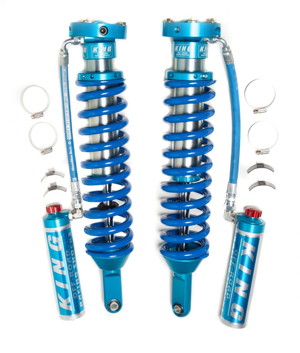

    You need this.

    So youre saying I need the whole King Suspension set up??? Because I have looked that up and it costs around 4k

    And this for the rear.

    So this is what you're saying I should get if I purchase any suspension kit?

    Or maybe these will work and some new UCAs.

    I have a second gen, so the same components might not yield the same amount of lift on yours. Headstrong offroad's website has that info.
    I don't have any good side view shots.
    I have cooper st max tires and they're very heavy. I also have around 400lbs in the bed all the time and a roof rack. All things considered, I get around 15.5-16 mpg, with 75% highway driving.
    I have the stock alloy wheels, and I don't run on the frame or cab mount. It rubs a tiny bit on the LCA at full lock but only on one side. Rims with a different offset would fix that.
    I haven't had it at "full flex" with the opposite tire fully off the ground with these tires so I can't vouch for that, but I haven't had any issues in the 1.5 years I've had this setup with 32s and 6 months with 33s.
    I don't usually do any crazy hard wheeling because every time I flex it out crazy I break parts of my drawer system in the bed....
    Edit: I have a 3 leaf AAL in the rear and it's sagging under the weight a bit now, so I'm looking to upgrade to a full leaf pack, so keep that in mind.
