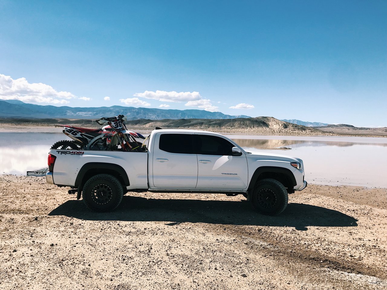

  15. Nov 30, 2018 at 12:03 PM

    But if I am wanting a more stable ride on and off the road which tire would be better skinny or a fatter tire because I dont want to have stability be an issue
