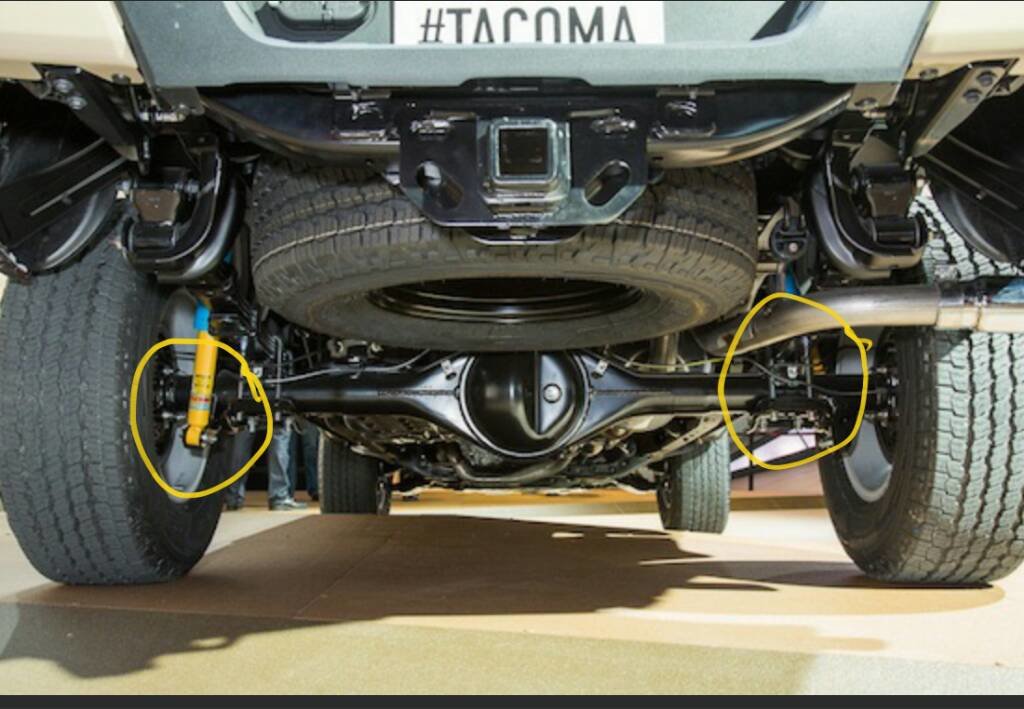

    Can someone explain the main differences in suspension/shocks if any in the current and possibly 2016 Limited and TRD Tacomas. Since I have a TRD limited truck I am a little confused on the configurations on the Tacoma.

    Those are the mounts for the shackles....they differ then your 1st gen Tacoma. On the 2nd gen they mount from the bottom (3rd gen will be the same) as where the 1st gen its from the top.

    Not sure exactly what you call it, but would anyone know why toyota went with opposing rear shocks on new tacoma? Pros & cons???

    The staggered arrangement is not new but the main advantage is more planes to cancel out motion.
    Shock absorbers can only cancel motion that is parallel to their direction of compression. If you look at the axle from a side view, staggered shock arrangement would form a V, where as if they were both behind or in front you'd get a \. In the same-side-parallel arrangement it is possible to have motion that is a right angle to the shocks direction of compression and thus cannot be damped. That isn't possible with the V arrangement, anything that is orthogonal to one shock won't be to the other. Since they're connected by a solid axle as long as one shock can work it will eventually damp the whole system.
    Usually it isn't a huge difference though because the suspension is mostly restricted to only vertical motion. It does start to matter when you get wheel hop under hard acceleration. I don't know that there are any disadvantages.

    The offset shocks should match the torque of the drive shaft under forward acceleration

    Any particular reason to mount the shackles top or bottom? I suppose they don't have to reinforce the C channel frame there if the shackle mounts on the bottom. Recent photos of the Hilux show the shackle still mounting directly to the frame (similar to 1st gen Tacoma).
    What's interesting is the new(er) arrangement looks similar to how domestics have been doing rear suspension for years. I've been looking at early bronco's (70s vintage) and it looks similar, except for the 9" rear.
