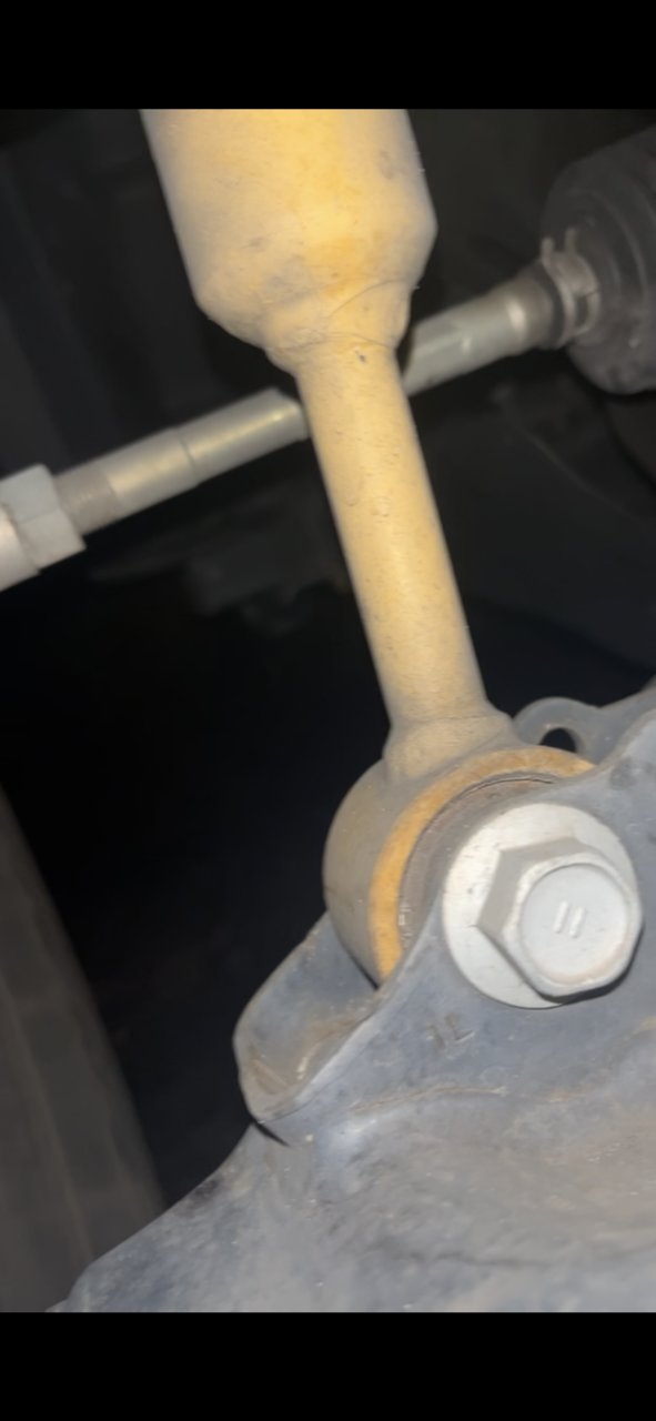

    Hah what? I think they are trying to take advantage of you.
    From those 2 pics, your shocks look perfectly fine to me.

    With that milage could be true. The pictures dont really show what wed nees to see.

    It’s the rubber that will dry rot, so those pictures don’t tell anyone anything. But if the rubber is not split, don’t worry until it does. Also at 80k those shocks are probably shot anyway, ignoring any dry rot.

    Dry rot occurs with wood, not metal (dry rot is a fungal infection).
    Someone is trying to take you for a ride. Your shocks look fine.

    Take a good look at the bushing. Look for excessive movement, usually clean spots or rust are indicators of movement. Also look for deep cracks. Not surface cracks. If you don’t see anything like that, they are fine.
    As for the shock condition, push down on each corner of the truck. If the shocks are worn out the truck will keeps bouncing. If the truck settles really fast then the shocks are fine.
    Always get a second opinion... too many rip off artists out there...
    From that picture, I see no excessive movement or bushing failure.

    Those Billsitein lower strut grommets will look off-center and split/cracked from day one. Totally normal.

    It’s the rubber parts they mean, not metal.

    We can't see pictures in your email account. You'd need to download the pictures to your device and upload them here. See the "upload a file" button" in this thread? However, photos don't tell the full story. You'd need to unbolt the shock from the lower control arm and visually check the rubber bushing. Maybe it's torn or cracked. Folks in my off-road club have seen this happen in less than 40k miles, 99% on pavement driving. The rubber bushings are replaceable, but usually uneconomical vs just replacing the shocks. Swaybar links and outer tie rods can develop play. If you aren't mechanically inclined, take it to another indie shop for a second opinion.

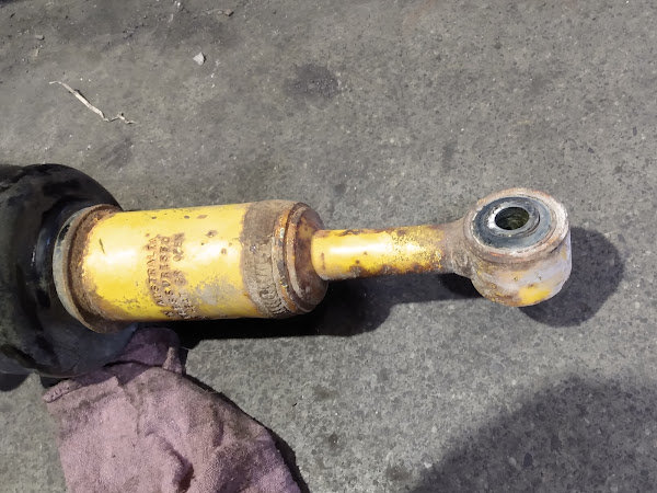

    Dry Rot exhibit A
    :cheers:

    Buddy's OME shock after two years. Apparently our streets are rougher than the Australian Outback
